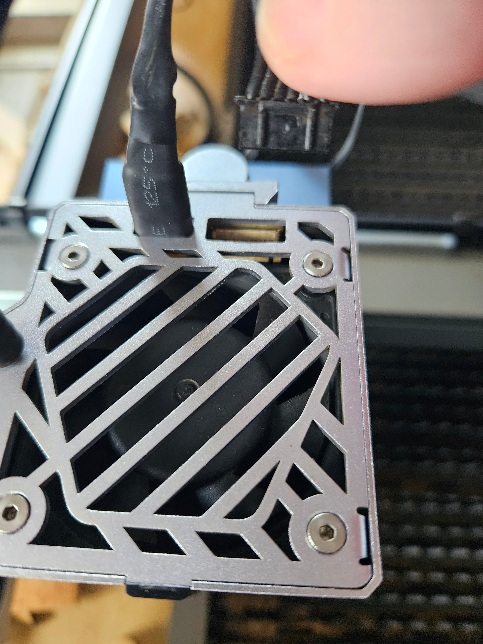

Hi AaronF,
Yes the $HX and $HY does home to the limit switch on those axis. I’ll try the $HXY and let you know.
In this image I’m pointing to the module cables I had disconnected.
After that, try $HZ as well. I say this because we have constantly seen “|Pn:Z|” in your postings.
Yes, I don’t think you managed to find and disconnect the touch probe switch? Which I think we had determined to be the cause of the Pn:Z input signal (or could be a motherboard problem). I see a couple of other sets of 2-wires in the back? where do they go?

The wires you are pointing towards are the Z axis stepper motors wires.
The only feedback I’m gett8ng back from the manufacturer is that its the mainboard. They’ve said thos without any attempts at establishing that this is the route cause.

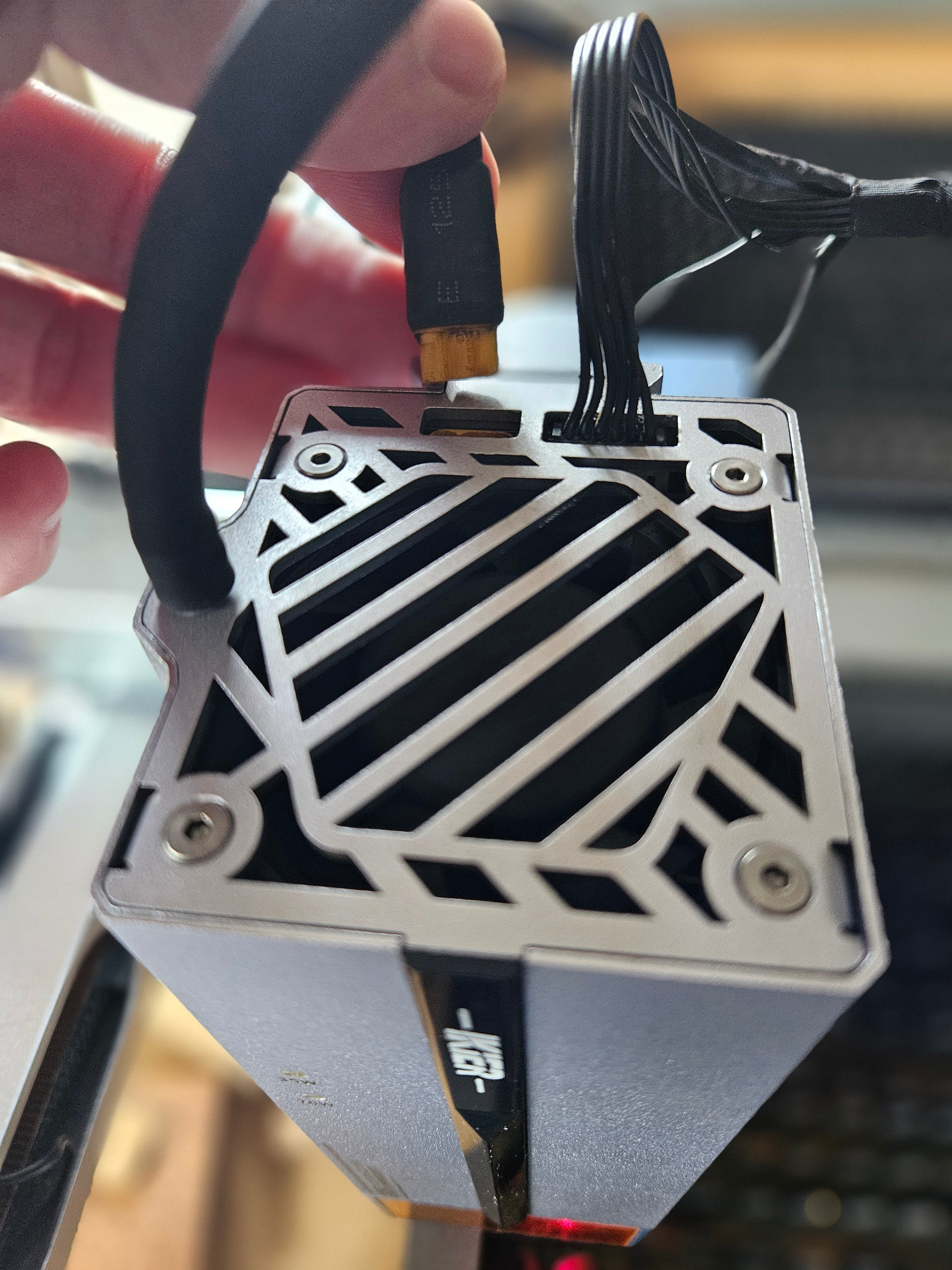

When I asked if you could disconnect the touch probe you said:
I don’t really understand what you meant by “disconnect the probe that is connected to the switch”.
So I would still be interested to know what happens if you disconnect the connections you are pointing your finger at in your post #24 - and see which connection if disconnected might cause the Pn:Z to disappear, check with ?.
Basically, if you could confirm:
  1. ? Pn status (all the characters between ‘Pn:’ and ‘|’) with the touch plunger pressed in, and status when you check again with the plunger out.
  2. ? Pn status with the upper Z limit switch pressed in and the status when you check again with the switch out.
  3. For each of the two wiring plugs at the top of the laser module, one at a time: power off, disconnect the plug, power on, send ? (the machine will be in an alarm state from failed homing but ? should still work), record the Pn: reading, then power off and reconnect before doing the other plug (please don’t unplug these with the machine powered).
These three results will help confirm whether the fault is in a switch, the wiring, or at the board as the manufacturer says. If the motherboard and switches will be replaced under warranty then it’s a no-brainer - as long as wiring & connectors come with the switches.

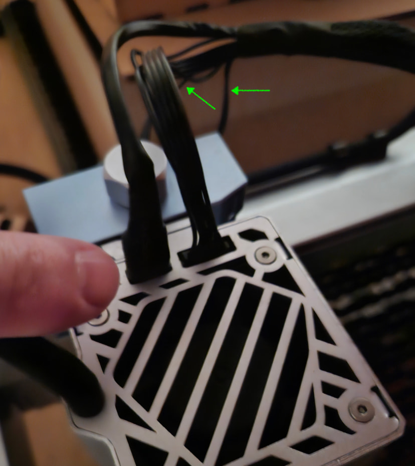

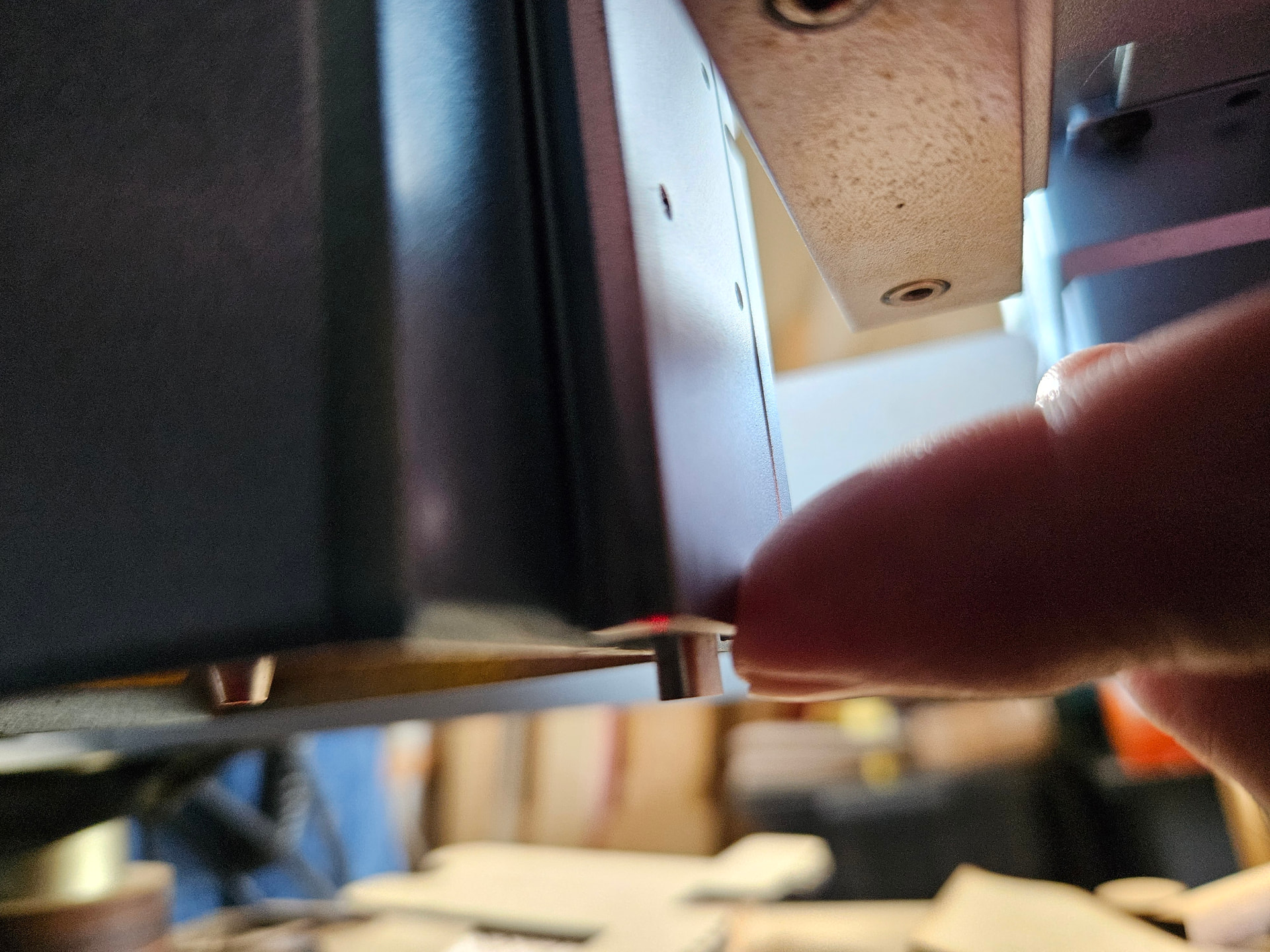

Hi Nicholas,
Here is the info you requested.
In this image I’m pointing to the probe I mentioned thats attached to the limit switch. The limit switch is part of the laser module but the probe can be removed.
Here are the readings when I press the probe in
ALARM:1
Hard limit triggered. Machine position is likely lost due to sudden and immediate halt. Re-homing is highly recommended.
Grbl 1.1h [‘$’ for help]
[MSG:‘$H’|‘$X’ to unlock]
ok
<Idle|MPos:0.000,0.000,0.000|FS:0,0|Pn:ZZ2>
ok
And here are the readings when I release:

There is no upper limit switch which I have on a few occasions sent the Z axis to the max and it keeps going. Rather dangerous.
I first remove this cable and got the following reading
<Alarm|MPos:0.000,0.000,0.000|FS:0,0|Pn:Z|WCO:0.000,0.000,0.000>
ok
[MSG:Caution: Unlocked]
ok
<Idle|MPos:0.000,0.000,0.000|FS:0,0|Pn:Z>
ok
<Idle|MPos:0.000,0.000,0.000|FS:0,0|Pn:Z|WCO:0.000,0.000,0.000>
ok

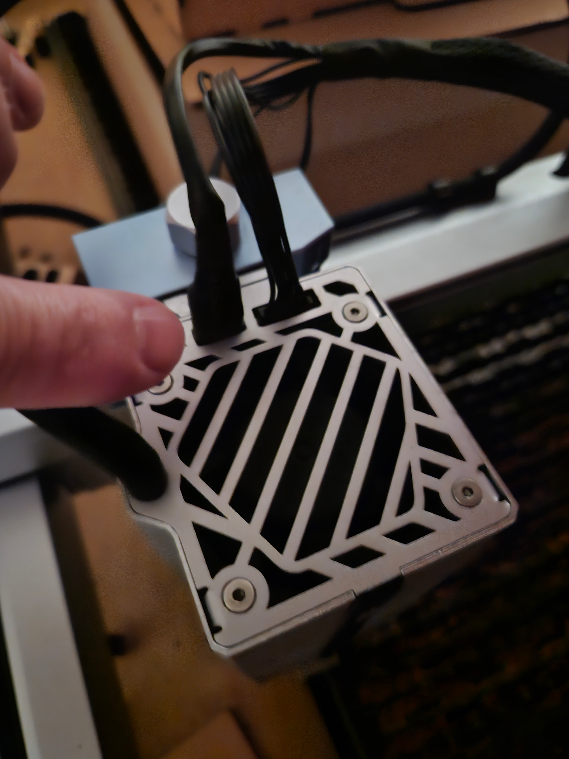

This was followed by the cable in the next image and the reading was
ok
ok
ok
<Idle|MPos:0.000,0.000,0.000|FS:0,0|Pn:Z|WCO:0.000,0.000,0.000>.
Hope that all makes sense to you.
Cheers Donovan
Thanks Donovan,
That makes it very clear that the ‘Z2’ is the touch probe - which is functioning correctly.
That leaves the mystery ‘Z’ pin input which will surely be the Z axis upper limit home switch which must be present somewhere, you might need to lower the head to see it?
