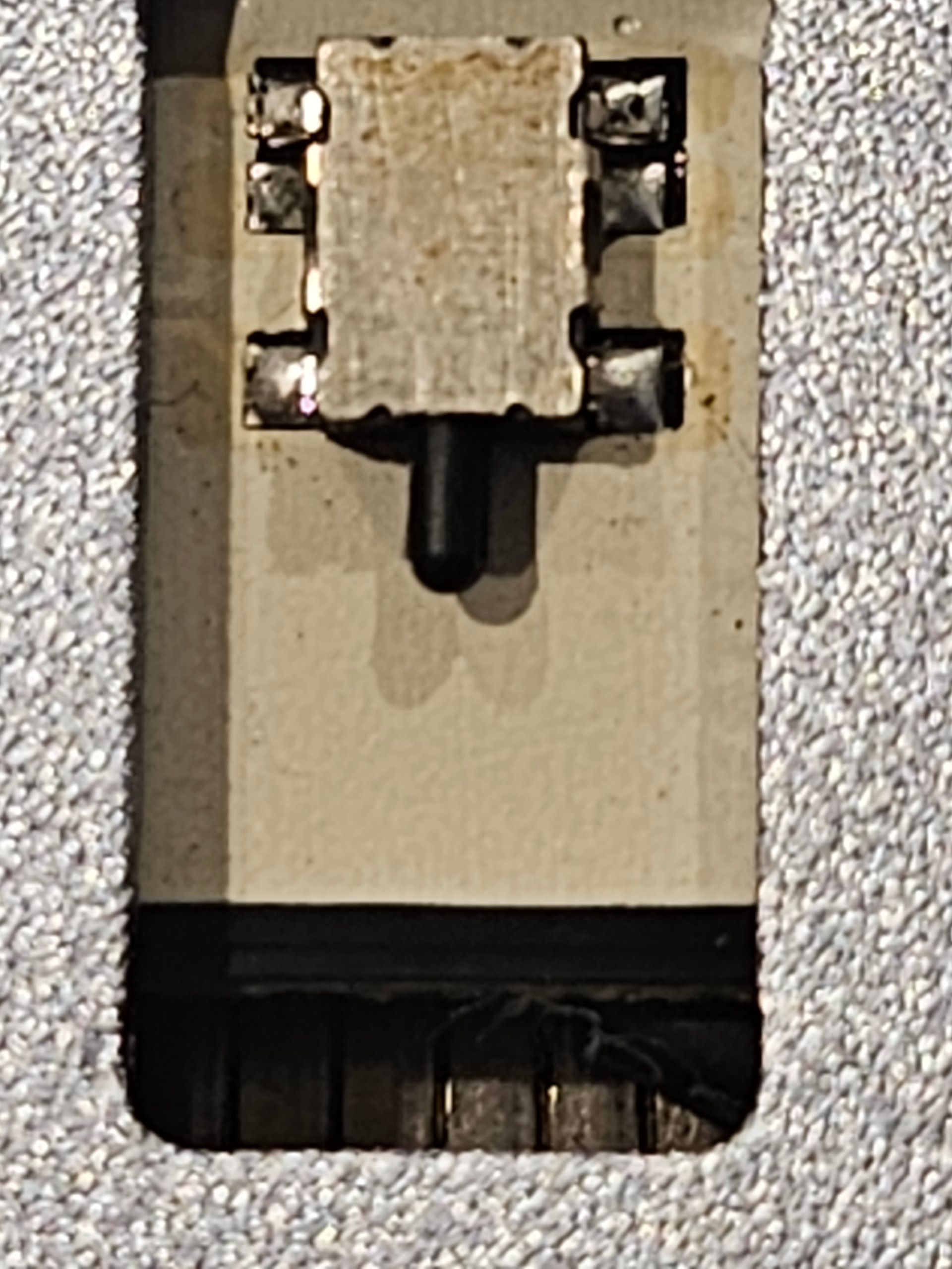

You have a powered Zaxis?
Time to talk about what kind of limit switches you have:
  1. Mechanical
  2. Optical
  3. Magnetic
I will review your reply in the morning. Sleepy time here.
P.S. To be honest, your issue makes no sense, so we are going to be very happy when it is solved. :hugs:
Thanks MikeyH,
It is a micro plunger switch, if that helps. Its a head scratcher for me too, it worked and then it didn’t.
Maybe the plunger part is sticking intermittently. Got a picture of it?
I have pressed the shaft when the machine is powered on and the limit switch does acknowledge a warning.
Try putting a little lubricant on the plunger of each one. Then operate it with your finger about 10 times or so. That will ensure the plunger fully extends when released.
Do this for all the switches.
If this does not clear up your issue, we can do some one-by-one switch testing.
All done but yet still the same issue.

Pn:Z in the status shows one of the Z-limit switches remained activated.
Can you confirm if the auto-focus switch is ‘Z2’? (press the auto-focus plunger by hand and run ? to see if ‘Z2’ appears after 'Pn:Z", if nothing happens then try the same with the upper Z-limit switch)
Recheck the action/wiring/connector on whichever switch turns out to be ‘Z’. If you can completely disconnect the switch (if you see a 2-wire connector near the switch) and then see the active pin status clear - that will confirm the switch is stuck/faulty.

I take it you were manually triggering the upper Z axis limit switch to get the ‘Pn:ZZ2’ ?
…that would mean the touch probe is the ‘Z’ active input causing the issues and the Alarm 8 (even though it’s not directly involved with homing).
See if you can repair or disconnect the touch probe and check with ? status check from console to see if the ‘Pn:Z’ will clear, which should then result in an alarm free ‘Home’ cycle.
Test the touch probe switch for continuity if you have a multimeter to see if it’s functioning or stuck on.
