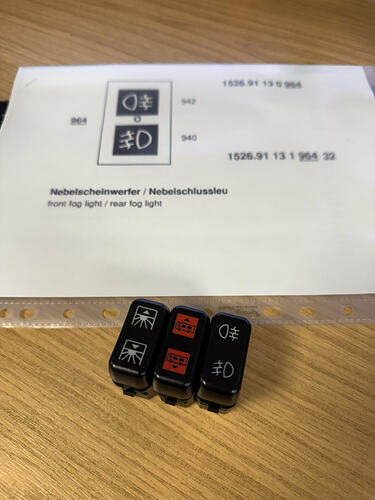

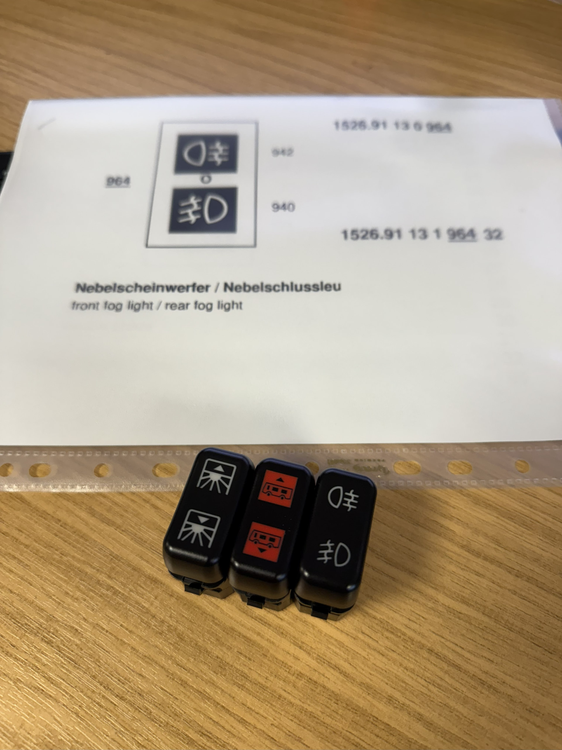

Hi all,
just incase anyone is still interested in this thread, I successfully managed to engrave some rocker switches using a Creality Falcon2 Pro Diode Laser, 1.6W at 5% power (0.08W) in 6 passes. :slight_smile:

Interesting that you used a blue diode laser to do this. I had no luck whatsoever! Do those actuators have a white paint base layer, & black paint top layer? And if so, did you manage to remove just the black layer?
Also could you post a macro photo of one of the etched symbols?
Thanks!
So it’s something I’m looking at for work. I’m not really sure where the switches come from, all I know is that they go on a bus! :smiley: They are a white plastic with a black painted coating I guess. I’m not particularly clued up with lasers.. this is my first venture, so may not be able to provide all of the information you are after.. sorry
The images I had to replicate were extremely poor quality, so I drew around them in Solidworks and exported as a DXF. I can attach one of the DXF files for you guys to try.
