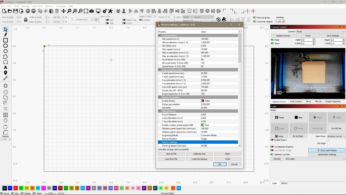

So I’ve searched here, and lots of folks appear to had have this issue, but most seem to have been connected via USB. I’m wired ethernet to my Ruida laser controller. I can see the camera, I can manually control the laser head via the LB interface, and I can even run a preview frame of the job. Everything looks just fine, until I hit the [Start] button, at which time it pauses, then throws up the usual “there was a problem sending data to the laser. the machine may be busy or paused” error. My machine is neither busy nor paused. I’m on LB v1.4. I checked the console, and it shows nothing. It’s grayed out completely. Is that normal for a network connection? I’ve never opened it before, so I’m not sure what it’s supposed to look like.

I wiped everything, restarted the machine, and tried sending a simple test file (see attached), and got the same error.

Can you read the machine settings?
Yes, I was able to read and delete the file list.
I can read the machine settings, including vendor settings.
I can do absolutely everything, except send any data to the machine from LB! :frowning:
