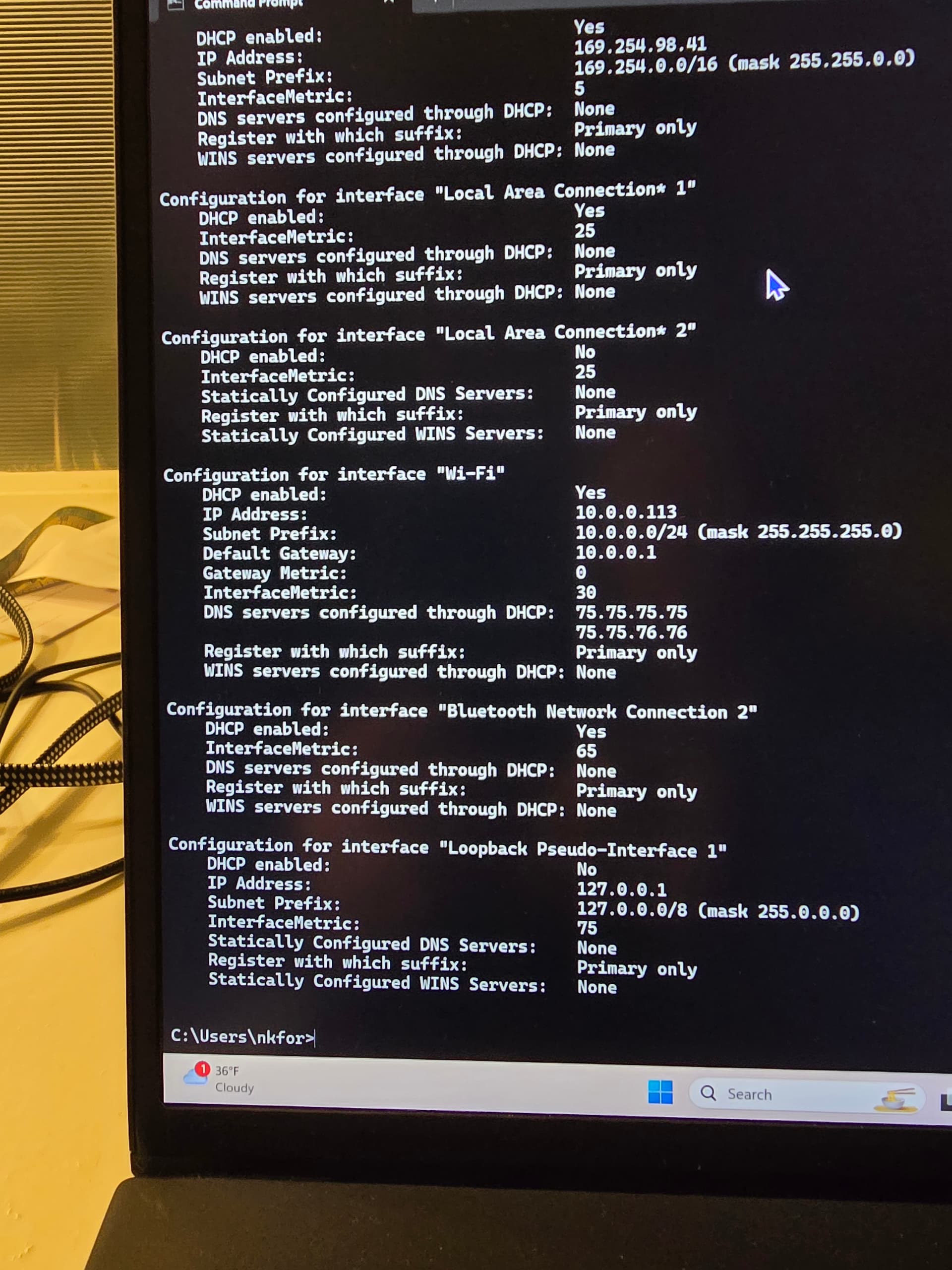

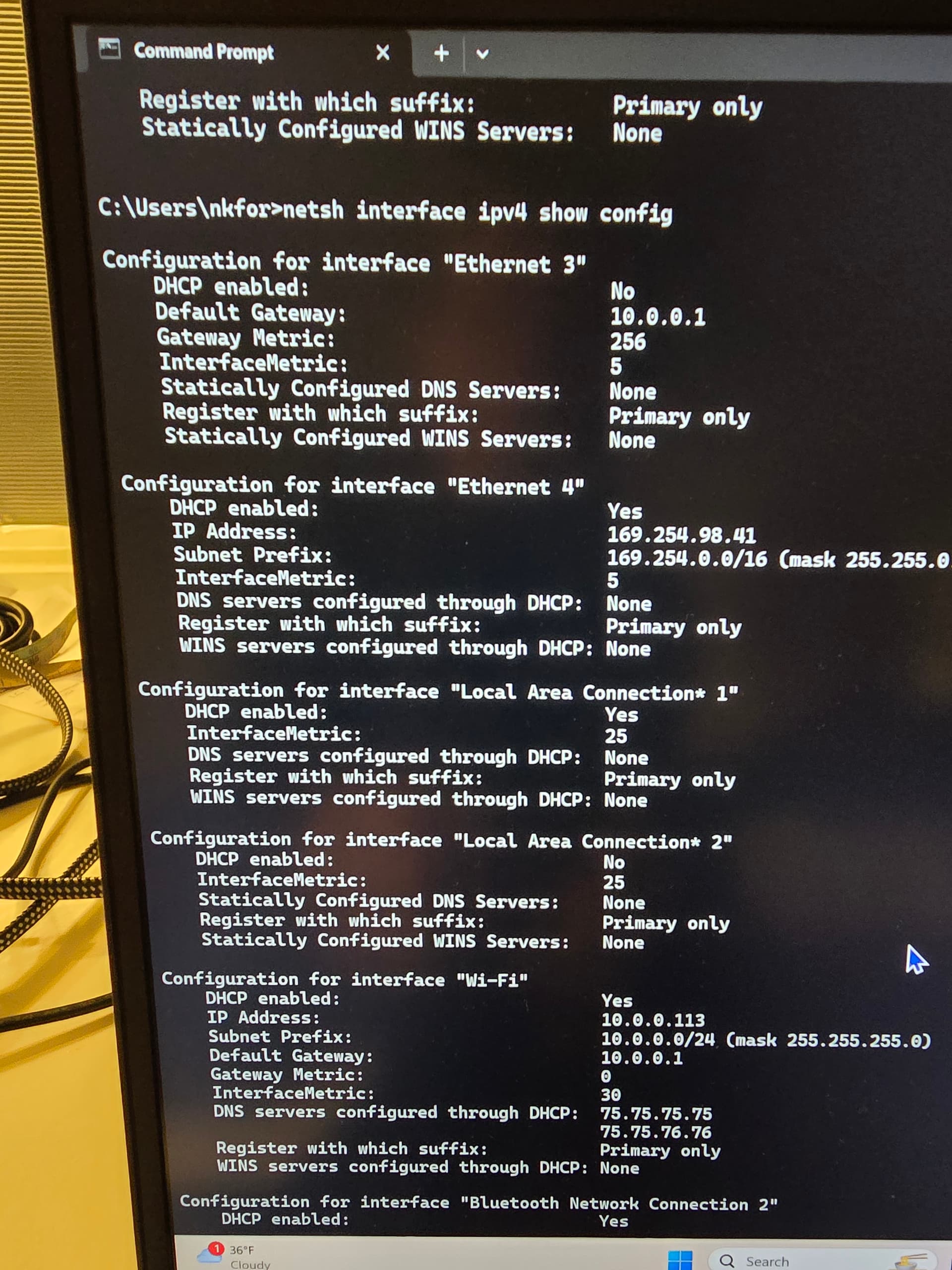

I am using the ethernet connector that came with the computer to convert the plug from a USB to an ethernet port. It came with the computer and should be working. I unplugged the other ethernet connector that I bought because I was told that the computer I bought didn’t have ethernet. There is only 1 connector plugged in to my computer and it’s the one that came with the computer.
Here are 2 photos of the screen after doing the netsh interface ipv4 show config
hopefully this will help.
This computer was purchased because my other laptop died. It was purchased as my business computer to run my lasers. As well as handle my website and Facebook business page. If I need to reconfigure things just tell me how. I’m not a techy person so I need complete instructions. I grew up in the DOS computer era so all this new stuff is difficult for me to figure out without good instructions. No one has yet to tell me how to change the ethernet configuration on my computer so if that’s what needs to happen then please give me the instructions and I will follow them and get the configuration on my computer changed I just don’t have the knowledge to do it without help.
I’m going to assume that the correct adapter is the one named “Ethernet 4”.
Run this in a command prompt:
netsh interface ipv4 set address name="Ethernet 4" static 10.0.3.100 255.255.255.0 10.0.3.3

I did that and this is what I got.
Run the command and show me the output of the command.
Also, are you able to copy and paste the whole text in a replay rather than taking the photo? The missing information makes it difficult to understand what’s happening. If that’s not possible, try to capture each screen.
