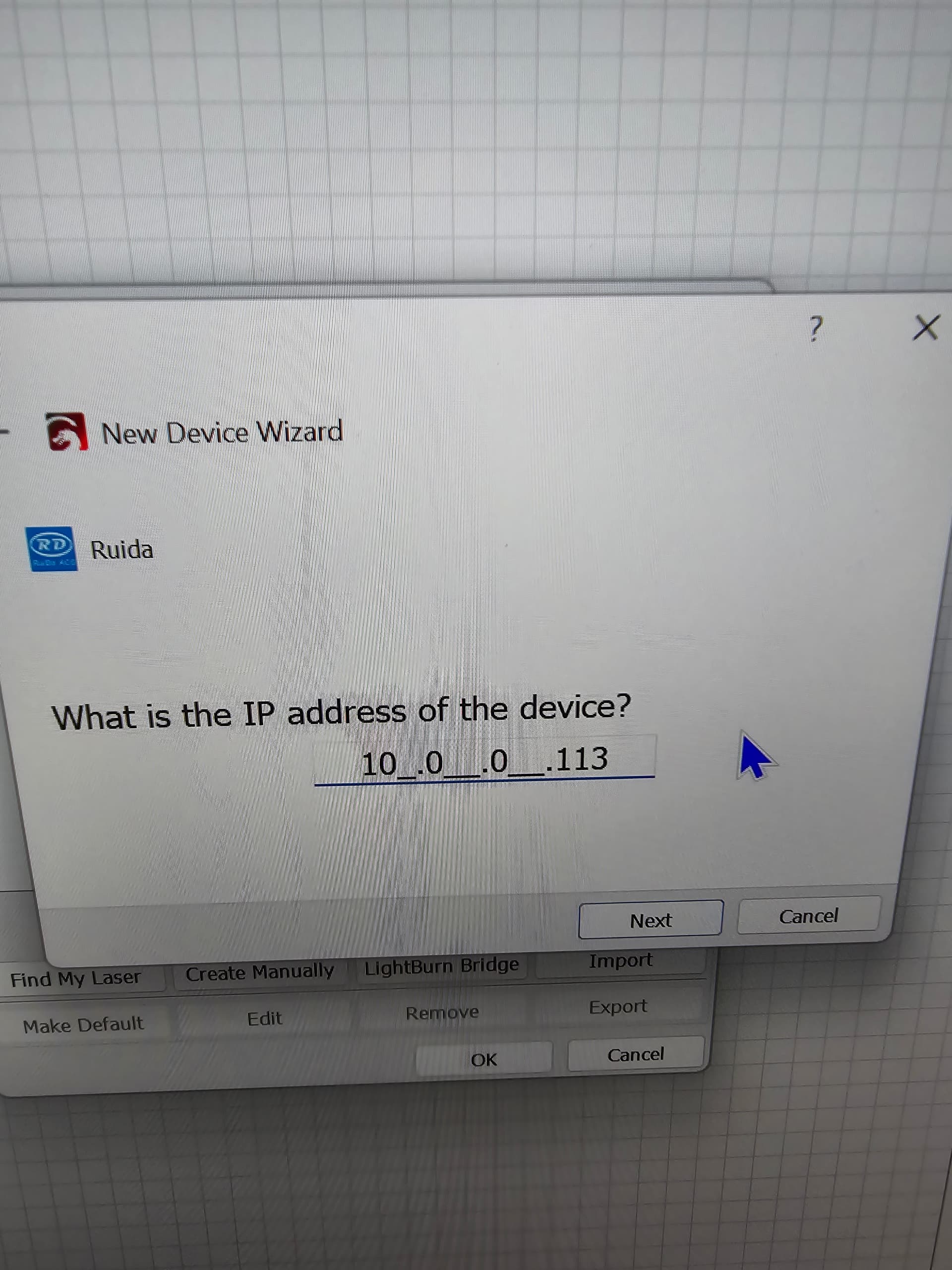

Yes I did, and it says that I’m disconnected. I followed the instructions and put the IP address into lightburn and on my controller, and tried to connect, it didn’t on lightburn it is showing disconnected. I expected to be able to connect and use my laser.

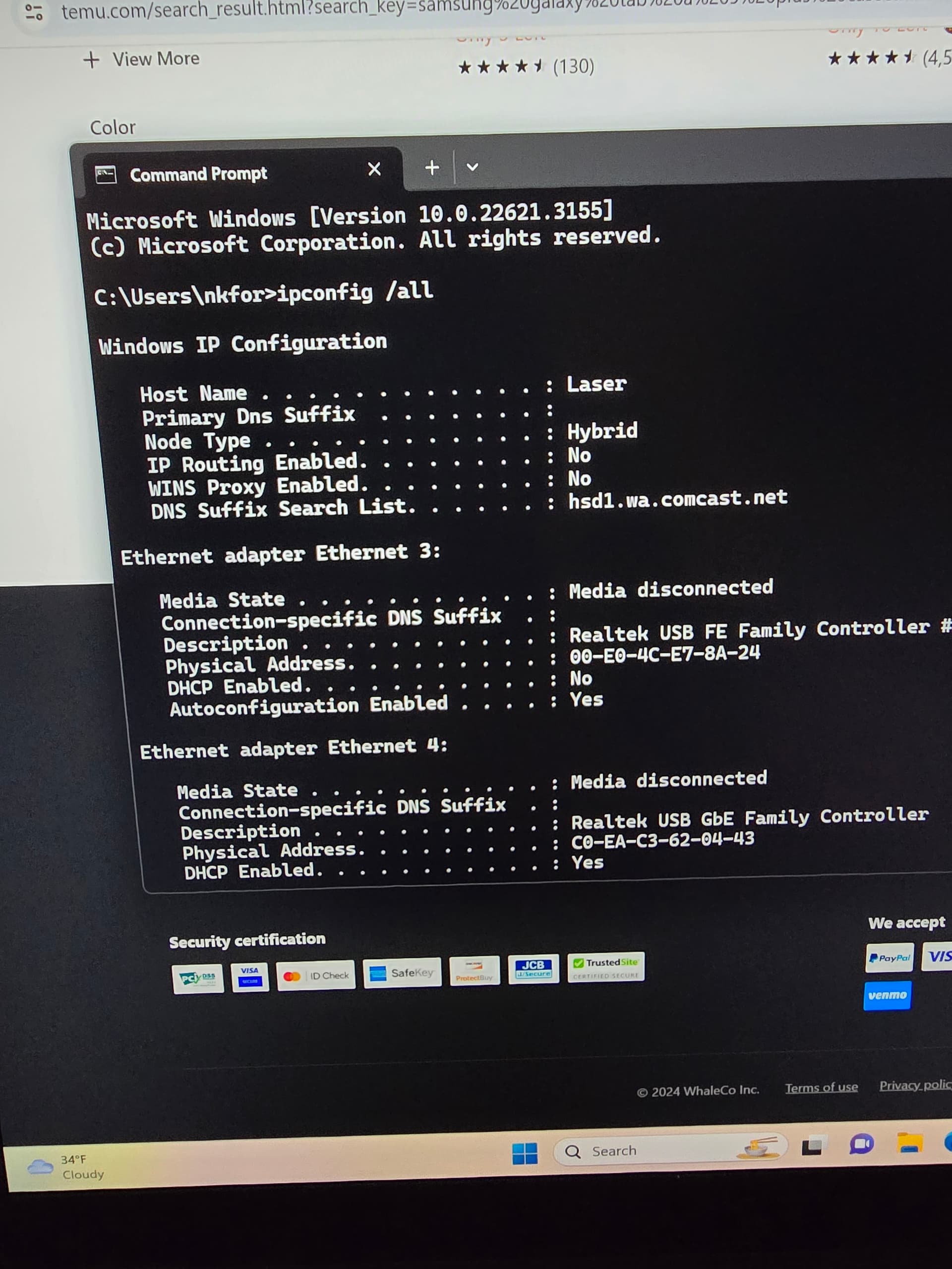

Can you take photos and screenshots for the following:
  1. IP configuration on the Ruida display
  2. IP configuration for the ethernet controller on your computer
  3. IP configuration for your wifi network if you are using one on the computer that you connect to the laser
  4. IP configuration in LightBurn for your device
Also, how have you connected the computer and Ruida? Is this a direct connection? Or are you going through a switch?

Here are the photos of my settings
Do you have your pc and the laser at the same IP?
Can’t do that…
I don’t use windows, so I don’t know what I’m looking at…
Yes they are both on the same IP, mask and gateway.
Did you manually configure the IP for ethernet on your computer?

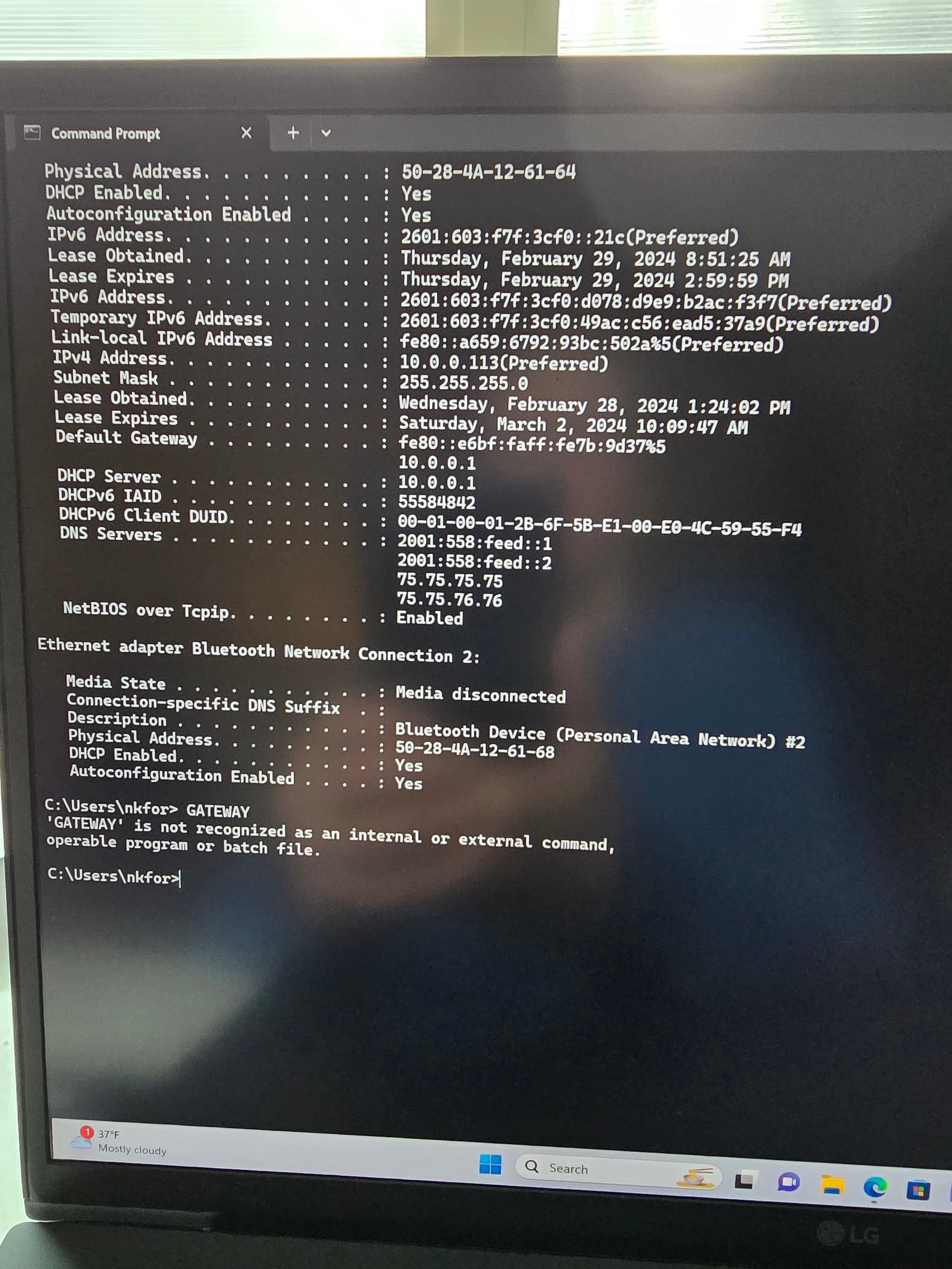

Do you have wifi on the computer? If so, what is the assigned IP for wifi?
Yes I manually set it up using the documentation. Yes I have WIFI on my computer
So here is another photo of my computer settings

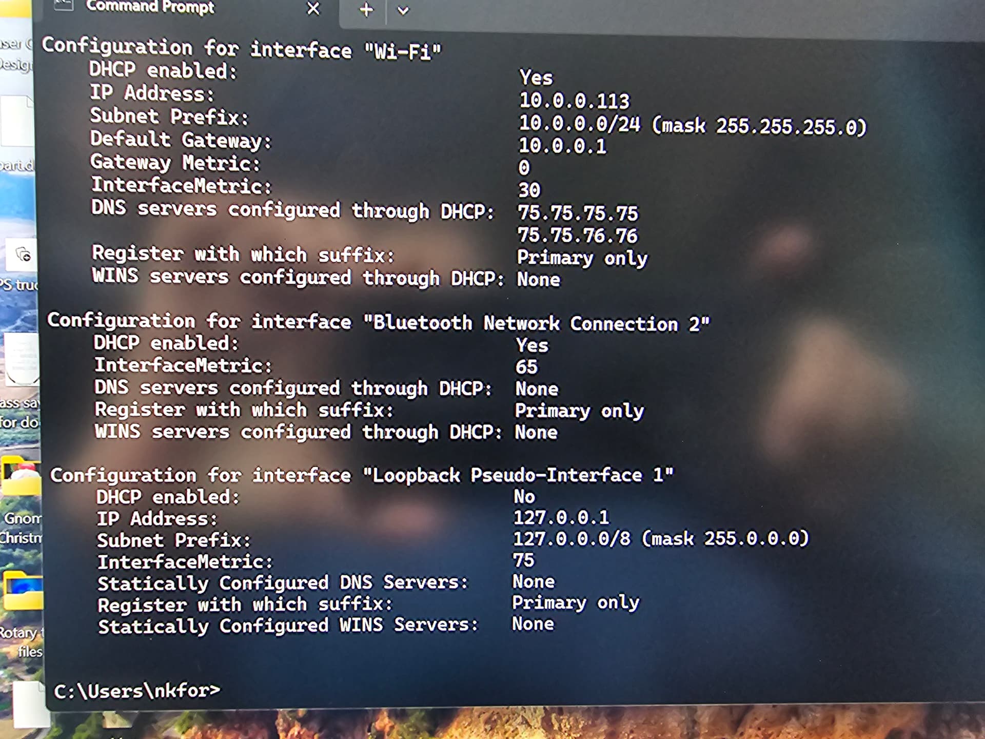

Can you run this command from a command prompt? Then copy all the text here? I’d like to see all the available entries.
netsh interface ipv4 show config
It looks like you have at least 2 separate ethernet adapter ports. Is that correct? Which one is connected to the laser?
Also, upon closer inspection I believe the IP information you sent earlier may have been for your wifi, not one of the ethernet ports. That’s fine for now given the information that the command above should give but wanted to document for completion.
