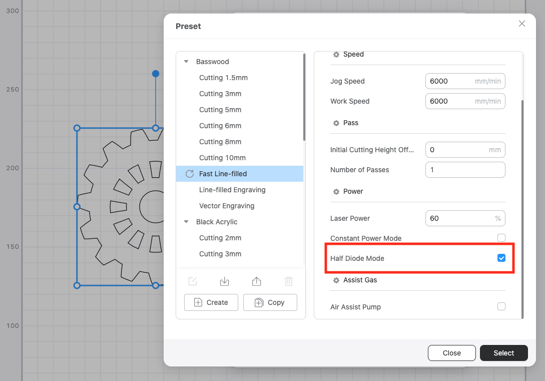

Diode using half Power:
In Snapmaker 2.0 A350 40W laser, the Luban software can let you switch between full 40W power or the 20W half power. I understand in Lightburn 1.5.0 there full support for the machine, so I do hope this is included because it will improve engraving using a smaller beam at less power.
This is from the beta 1.5 release and the only mention of snapmaker is this
[AH] Enable inline power mode for SnapMaker (available with recent firmware update to some machines)
