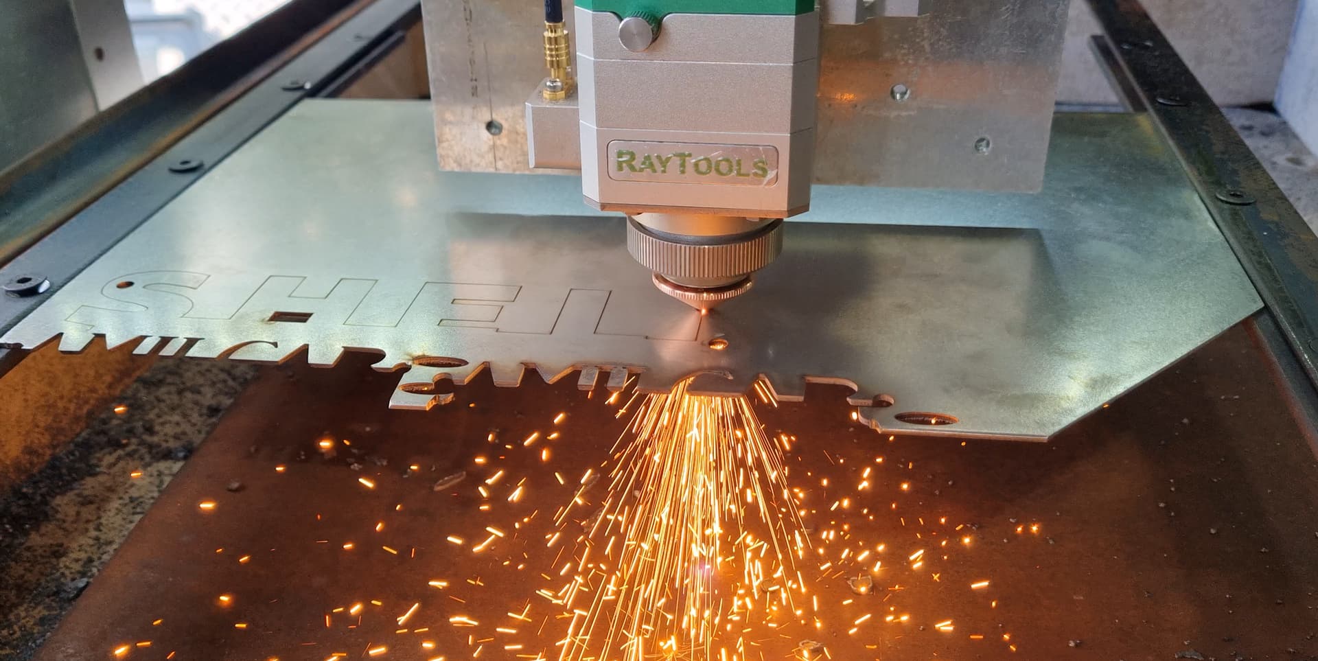

Hello all
The machine is currently in bootstrapping mode—I’ve just attached the laser head to my router. The work area is limited to 380mm by 400mm, but that should be sufficient to fabricate the parts for the next stage of the build. I’m cutting stainless steel using nitrogen as the assist gas.
