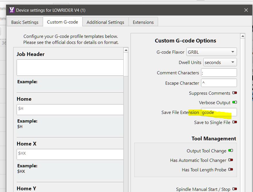

yes click export

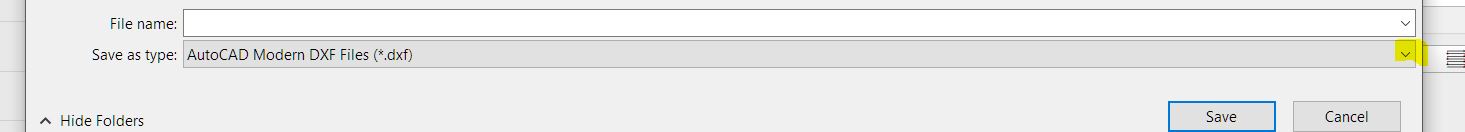

than when save opens click arrow save as type , should give you ai,svg , dxf options, but as far as saving the tool path inside a dxf i dont think that is capable
dxf only , that seems bit dumb
could try changing this to dxf and see what happens , complete stab in the dark, im just guessing

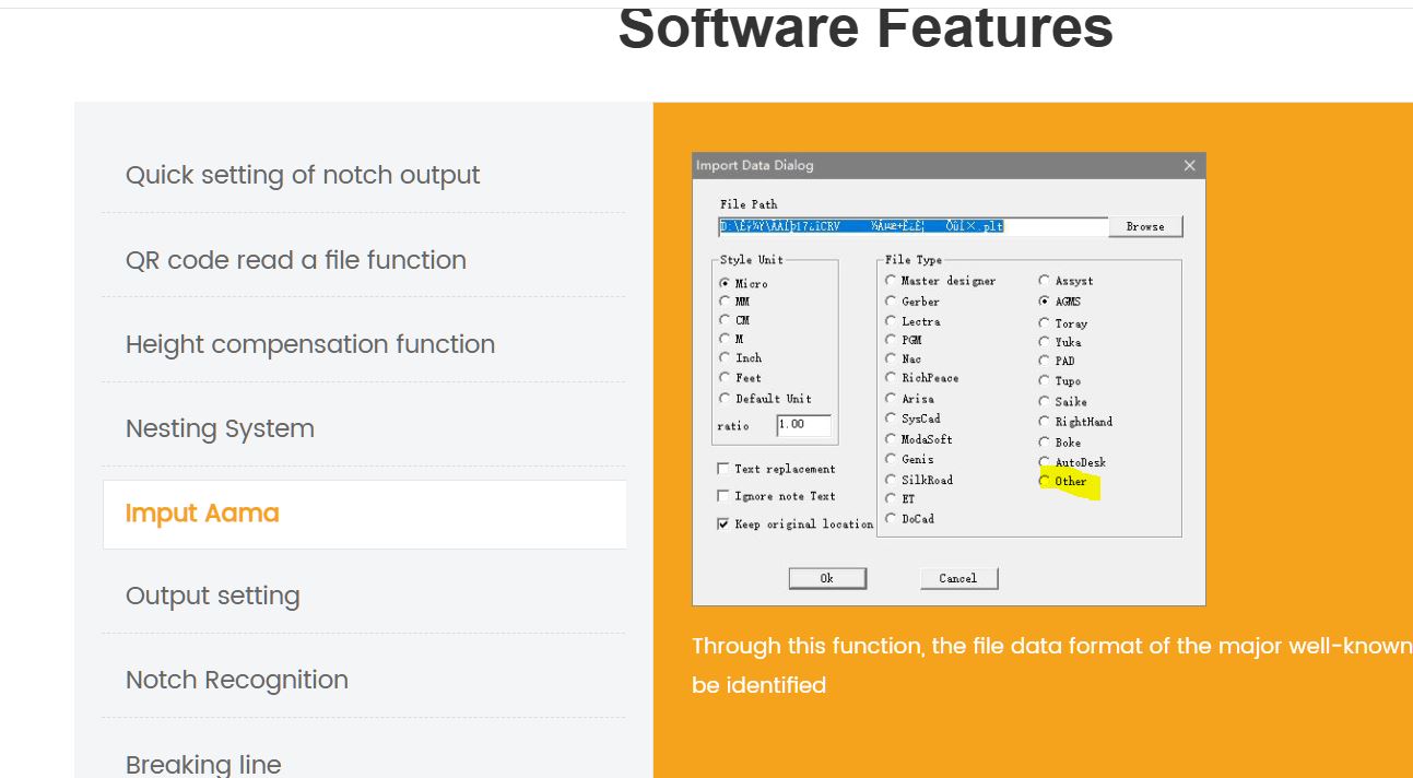

i see there is this option other , maybe try that could be g code in there , just seem odd no gc, gcode or nc anywhere

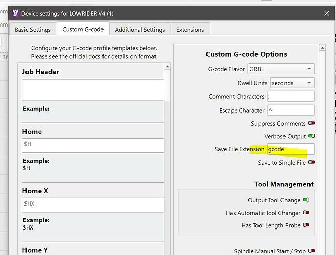

It’s possible to save GCode for an operation and import that back in, then export that to a DXF file, but I don’t see how that’s going to work, as it won’t include any depth information.
This machine has a software to configure depths and speeds from a DXF file, but don’t have a tool to make a pocketing from a shape, that is what I want to export toolpath as a DXF.
I tried to export GCODE, Import this GCODE and then export as DXF, and works perfectly as I want. Thanks for the tip.
