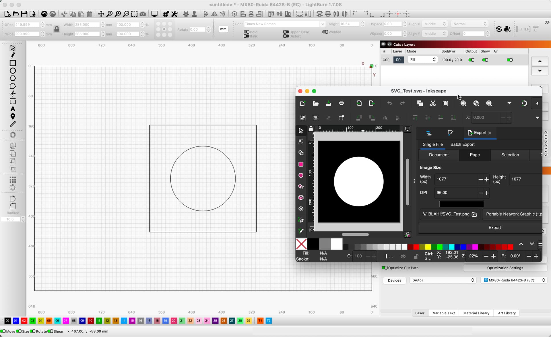

Using version 1.7.08 I am finding success exporting an SVG file. I am given a dialog to select a location to store the file and works as expected. I do note when searching using ‘SpotLight’, the SVG files can show up as ‘Photos’.

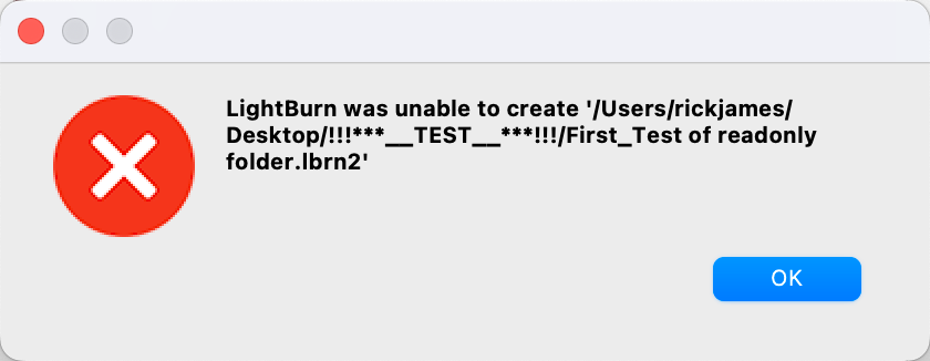

Update, I can save SVG’s to my desktop but not to a folder for whatever reason. So that’s one small step. I think it has something to do with app permissions or whatever. Any insight on that?
Not without seeing how you currently have set for permissions on the folder you intend to write to.

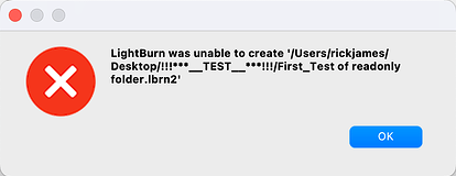

I see the following when I try to write to a folder without permissions.
I did note an issue where I am not receiving a similar message when trying to Export a file, so checking with our devs on that part.
For now, I would create a new folder you know you have write permissions and save your exports there.
Update: Checking in with Oz, we have generated a report to address the lack of error message - pop up an error if the Export fails.
