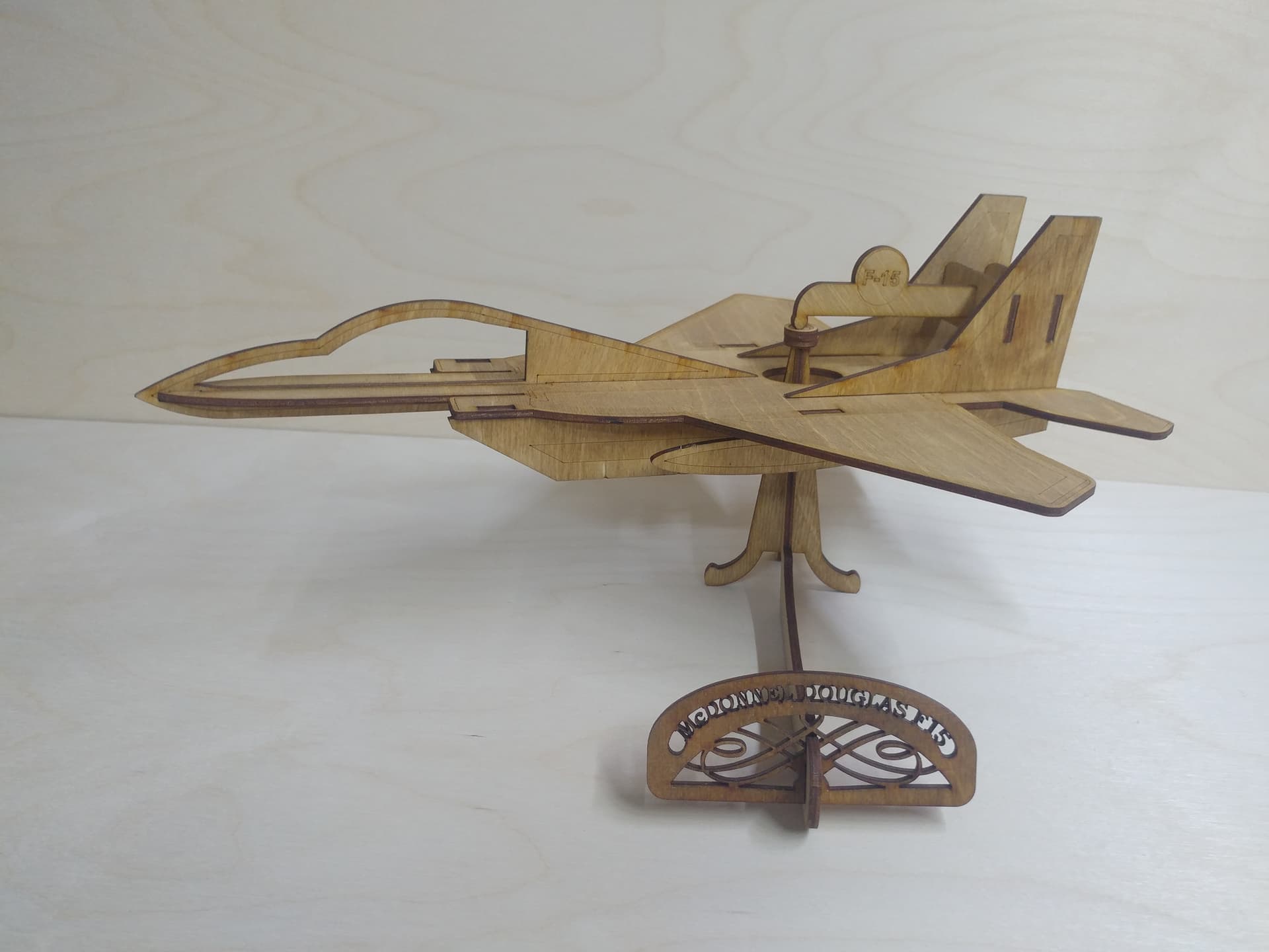

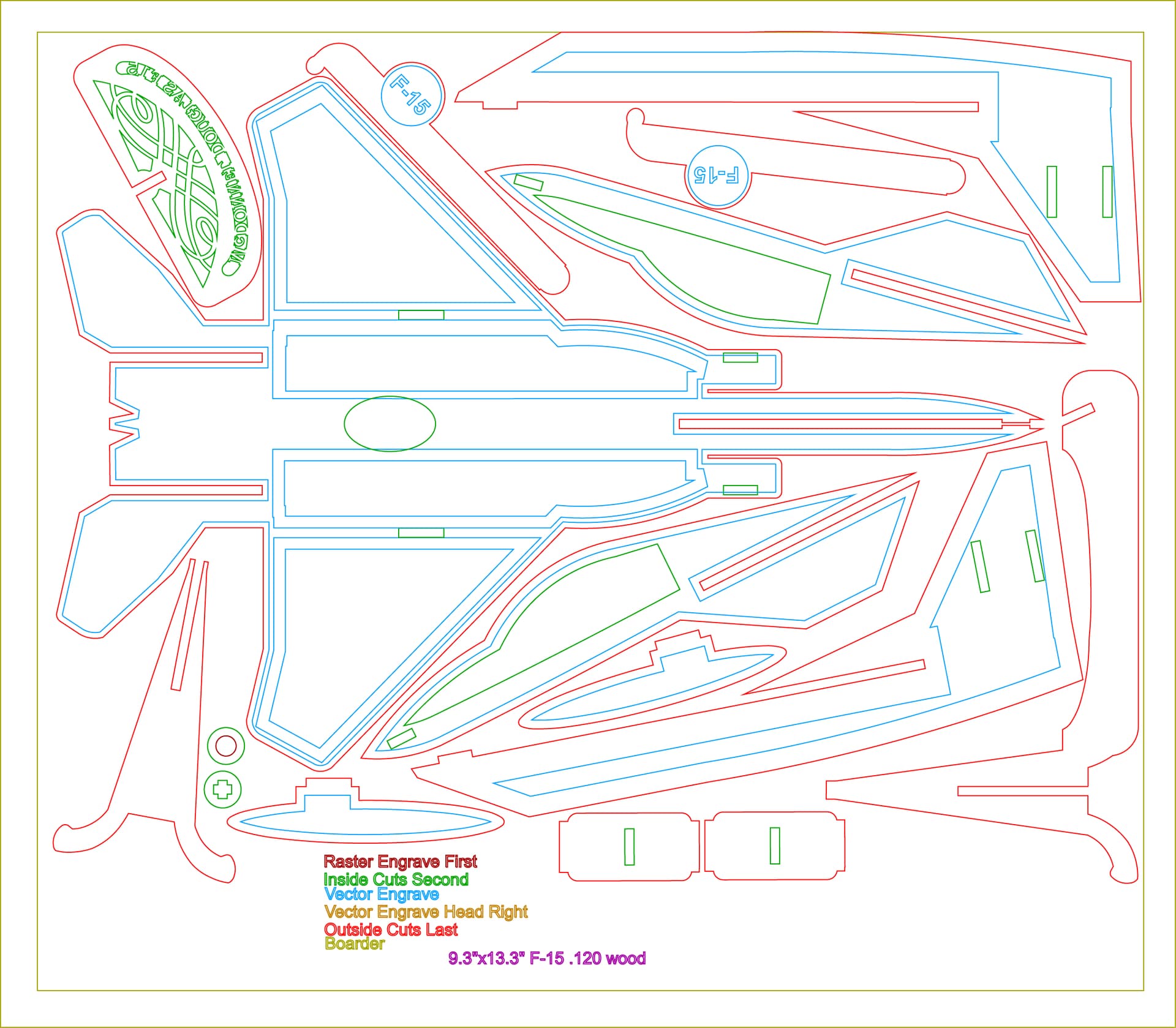

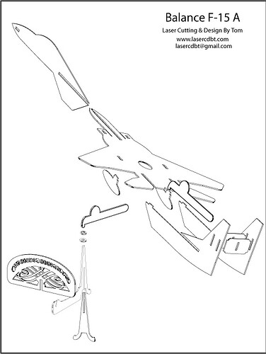

F 15 balanced - spinner - plane
f15 balance a.lbrn (254.8 KB)
This is a nice bit of work. I’d love to see it spin! I guess the only way I can do that is to cut one. I think my father’s partner would love this, he’s a planes guy. Thanks for sharing this.
Thanks, to balance it adjust pivot arm in and out.
