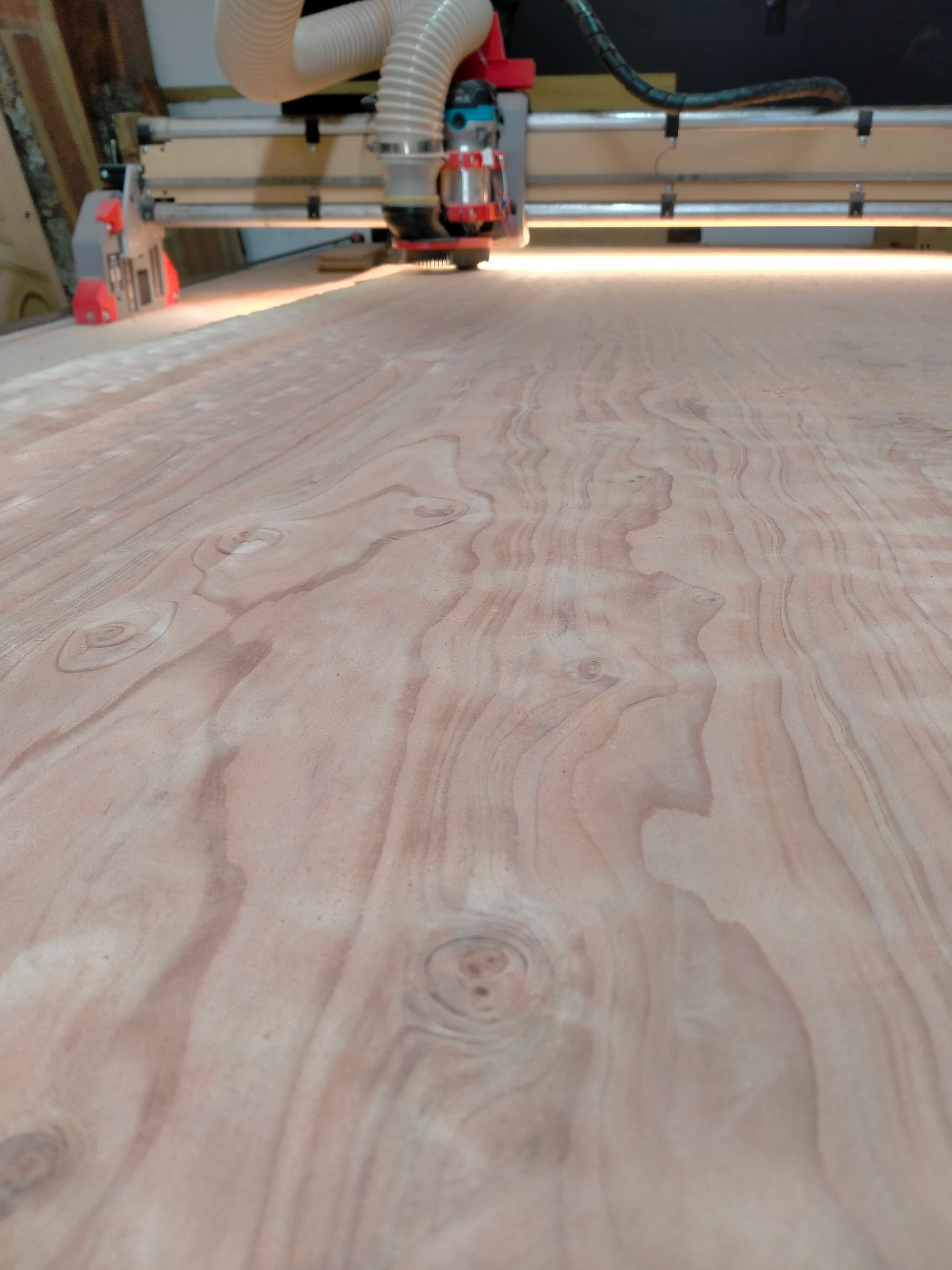

that’s the finishing I’m getting, but getting ripping in places due to direction of cut. the swirl marks in top left of photos

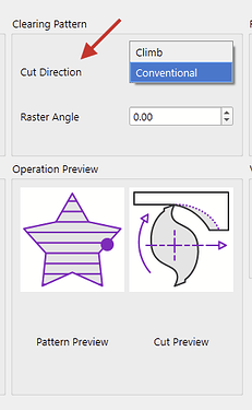

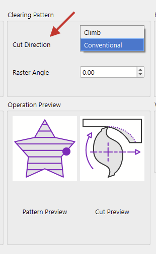

is this what you’re looking for?
No, I think you’re after raster angle in the image above. @Aaron.F

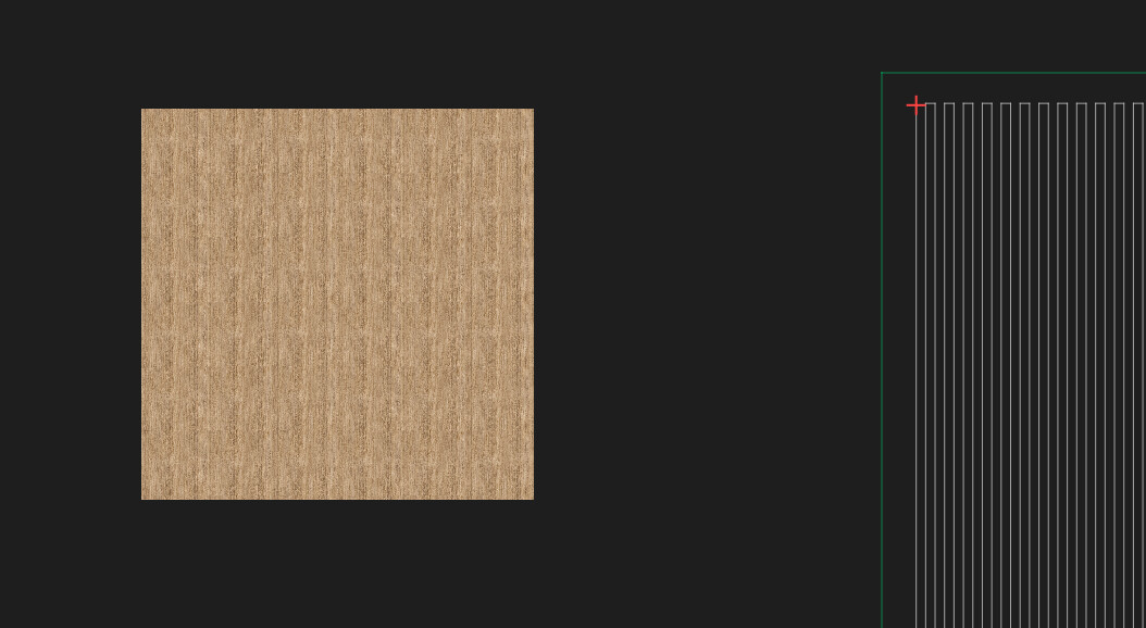

Here’s a 90 deg raster angle
Here’s a 0 degree raster angle
Climb vs conventional is how the tool approaches the workpiece, clockwise vs counterclockwise, in a way. Climb Milling vs. Conventional Milling - In The Loupe
yip in running a 90 deg raster

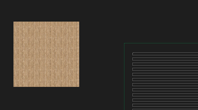

opps my mistake meant to be Y axis
im wanting to it cut from Y3000 back to 0 and than percentage pass from y0-3000
i would assume it would start at Y3000 yes or no ?

Is it possible to run a 180° or a 270° raster? Just shooting in the dark here…
Yes. a 180 deg raster is basically the same as a 0 degree, but starts from the opposing side. Same goes for 270 vs 90
dah why didnt i think of that haha
180 is all it will allow you to enter , but you can enter -90 and shows it starting at other end in preview :slight_smile:
