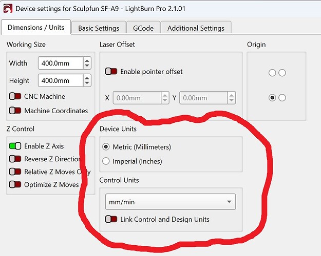

Now that linking is controlled by a new switch.
Hmmmmmm… Now that you mentioned it… U are right and I never thought of it . Well I know what I was setting and it was 2000 something.. SO now I an really confused Mike. How can I go back to what I was doing?

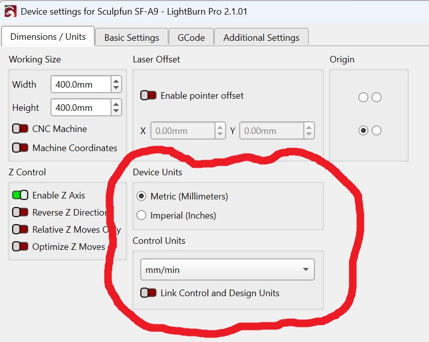

The Device Settings window has changed…
Device Units is your design section.
Control Units is your laser settings, in the Cuts window.
The Link Control and Design Units switch makes them the same no matter the setting window.
I always use mm/m for the laser control. I often switch between inches and mm when working up a project. If you want to design in inches, but run in mm/m for the laser (diode recommendation), then turn off the switch.
Now set your Control Units to mm/m in the Device Settings window. then set your Speed (mm/min) to your favorite 2000 value.
Use in or mm as you see fit (at the top) in the Lighturn design grid and don’t worry about the Device Units in the Device Settings window..
