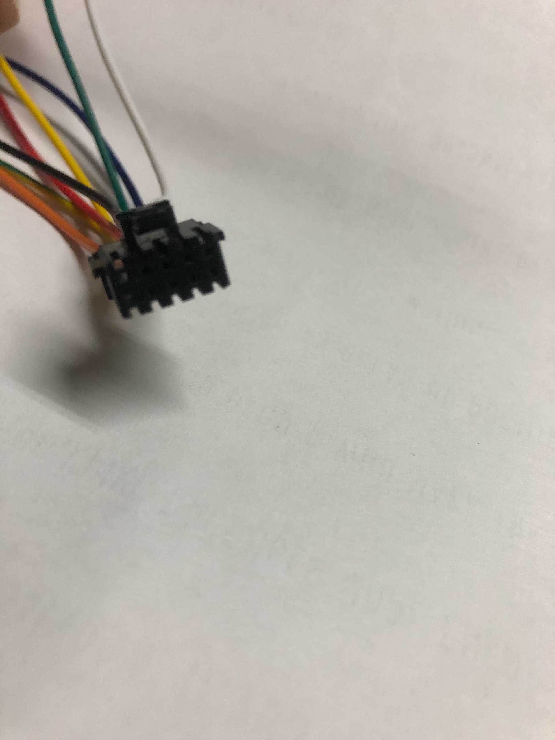

So the Falcon 2 22w has a total of 8 wires
on a 10pin connector
Also has the fire alarm and 2 fans and air sensors i assume
Did all of those wires go to a connector?
Did you burn up a daughter board that these were wired to?
There are only three wires needed for a standard laser module, if there is alarms and sensors or other than the basic controls, I don’t know if I can help you.

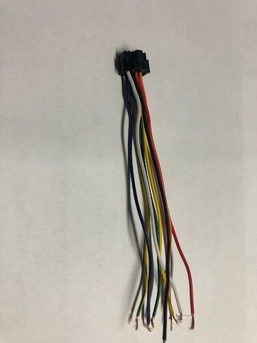

Yes They connected to a connector attached below i am tring to identify the connector for what i can see its a JSTXH or PH 2.00mm pin 2row+5pin

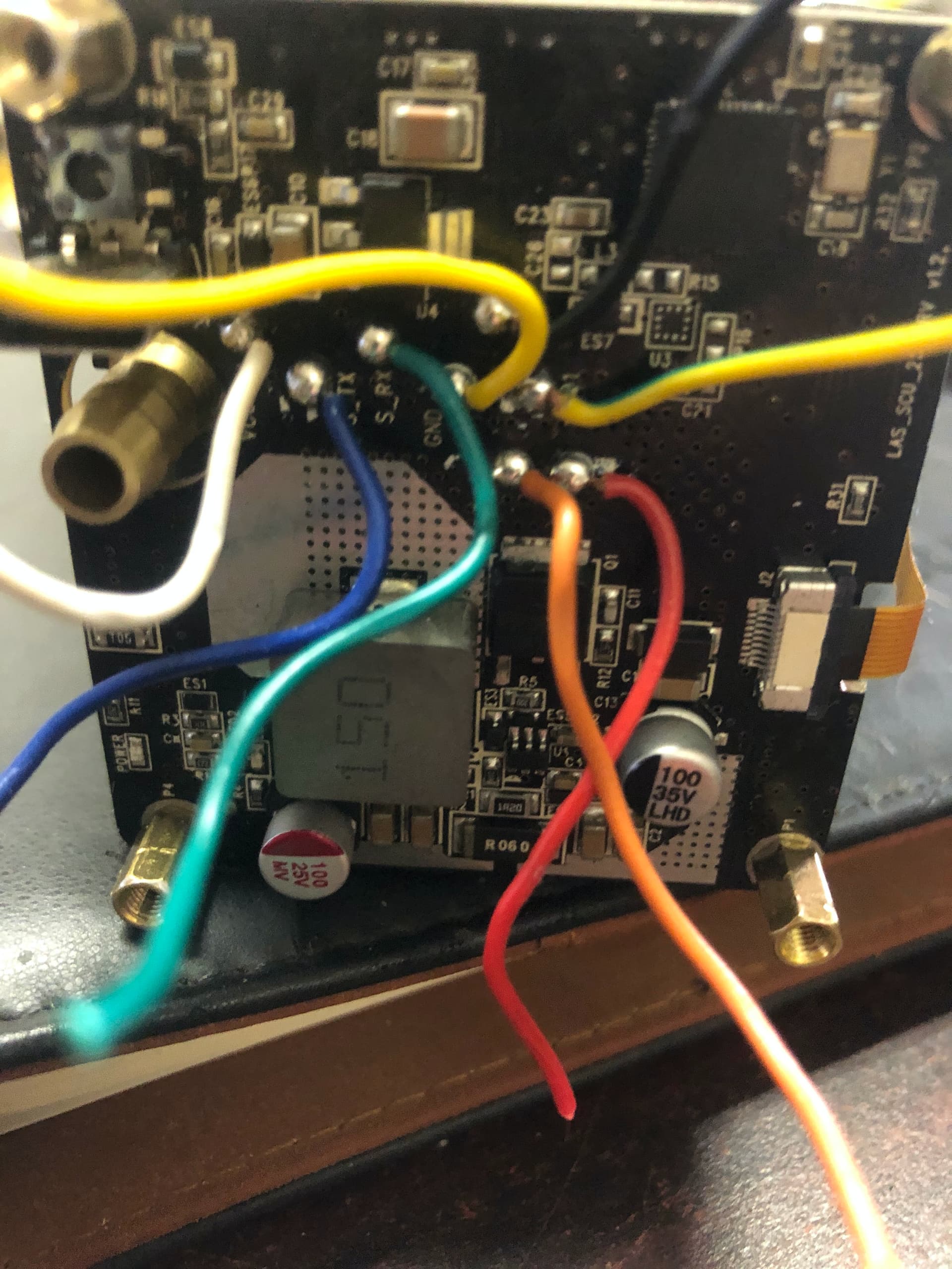

I have done a continuity test from the board on top of laser to the laser wires under the daughterboard, the other wires are for the fans and air assist switch have been able to trace those, so now it just to work out if i should got with 20 or 22AWG wire, was thinking to not join but rather solder direct to daughter board or will cable joins be fine.
SO the questions is to join cable between connector and daughter board or run new back from a connector to daughter board
I always try to keep a connector there, it’s real handy if you need it.
You need to do what you’re comfortable with. If you can easily put it back like it was built, that’s the best approach. If you have to direct wire it to the daughter board, then so be it…
Either way it beats buying a new one.
yeah i a comfortable with soldering, and connector crimping, just just making sure i get enough opinions, as Creality hasn’t been very forth coming, can even get a replacement cable

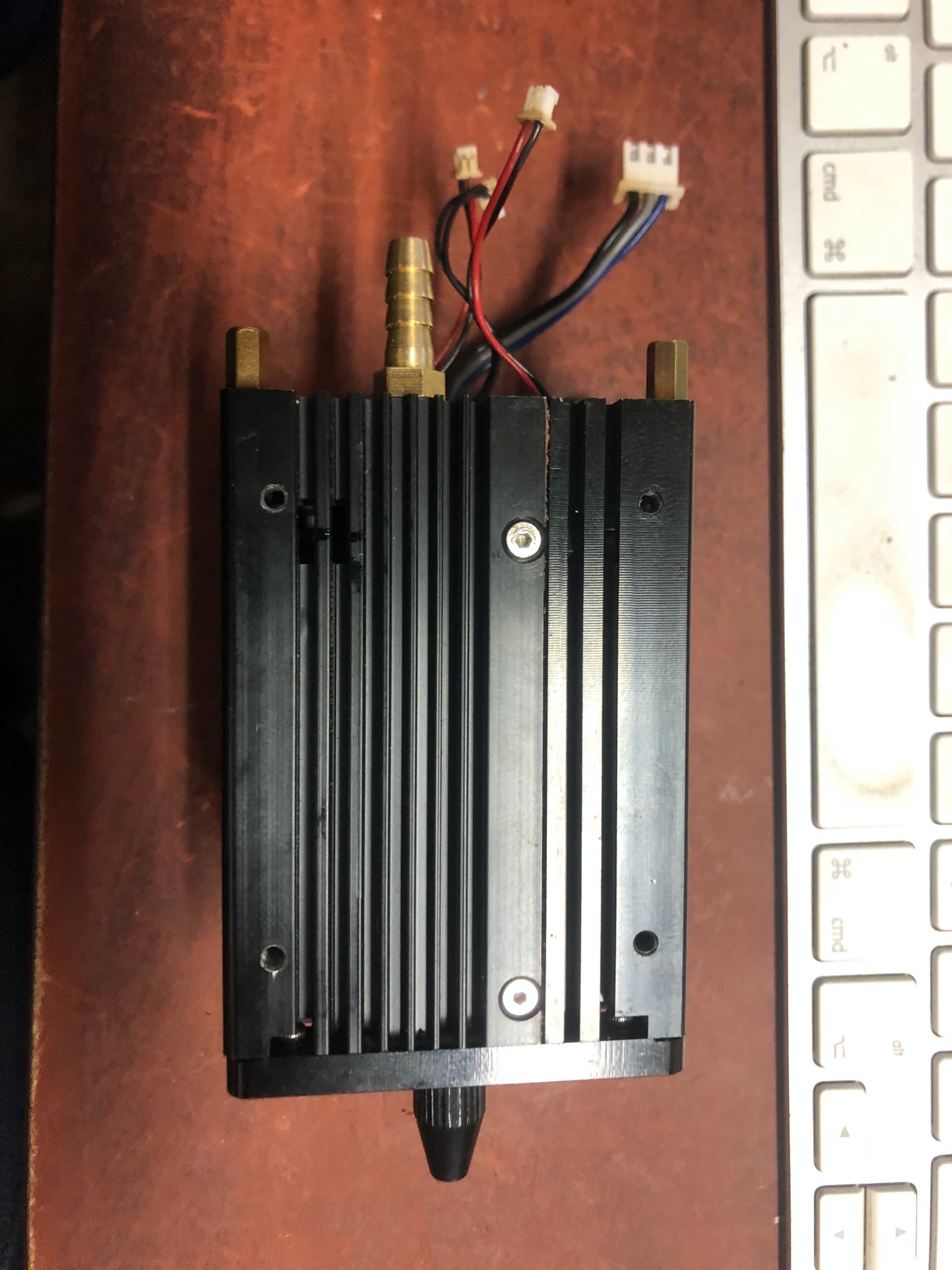

So i have broken down the laser module more, hope someone can assist so the 8 wire cable is broken down into 2 fans and the laser core/diodes and then sensor

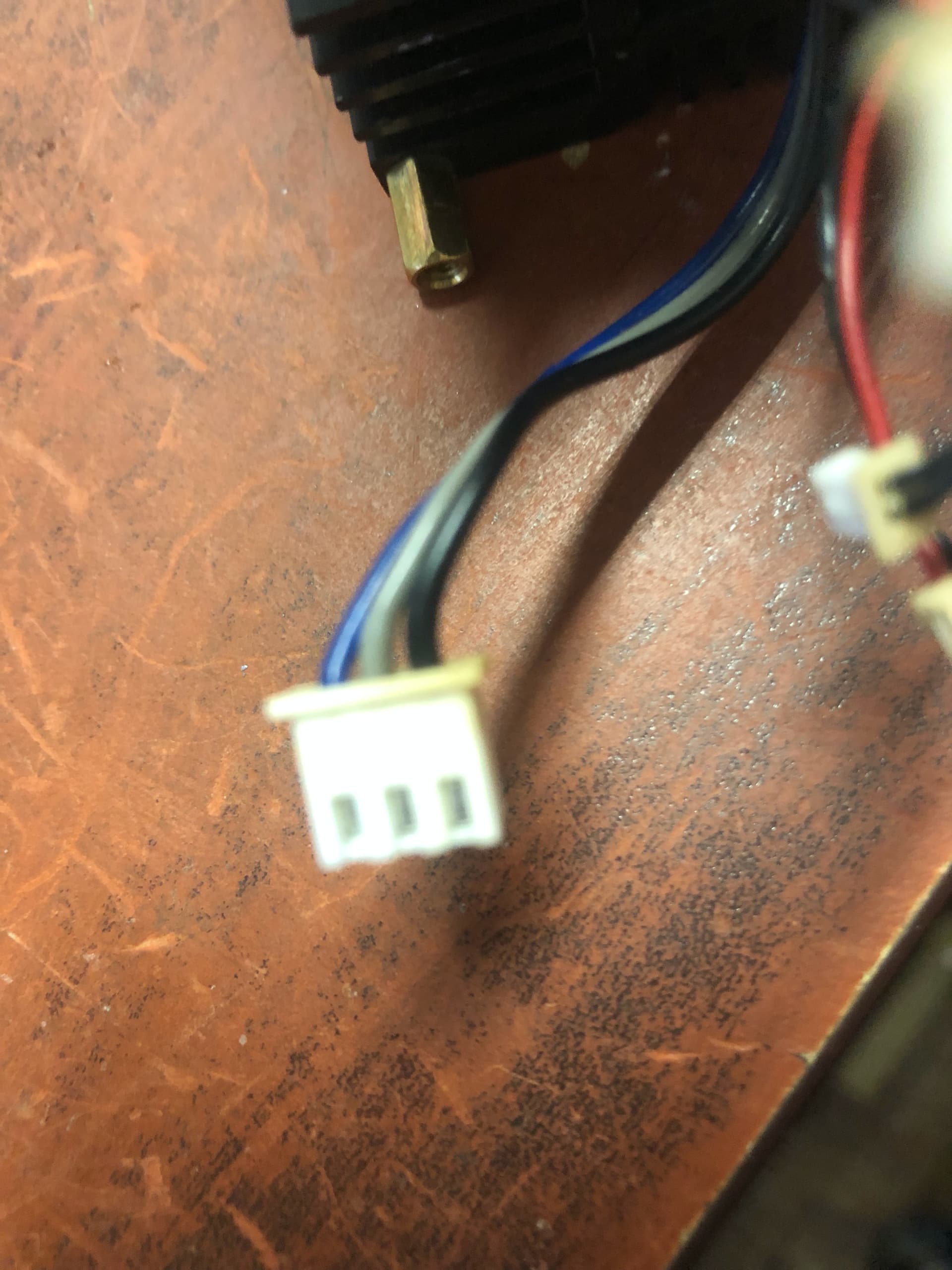

on the connector of the laser there are 3 wire as per pics can someone confirm with me which is ground power and ppm
I assume black is ground but don’t want to make a mistake
Also can i run 5v to this just to check and see if the diodes are working or any suggestions
