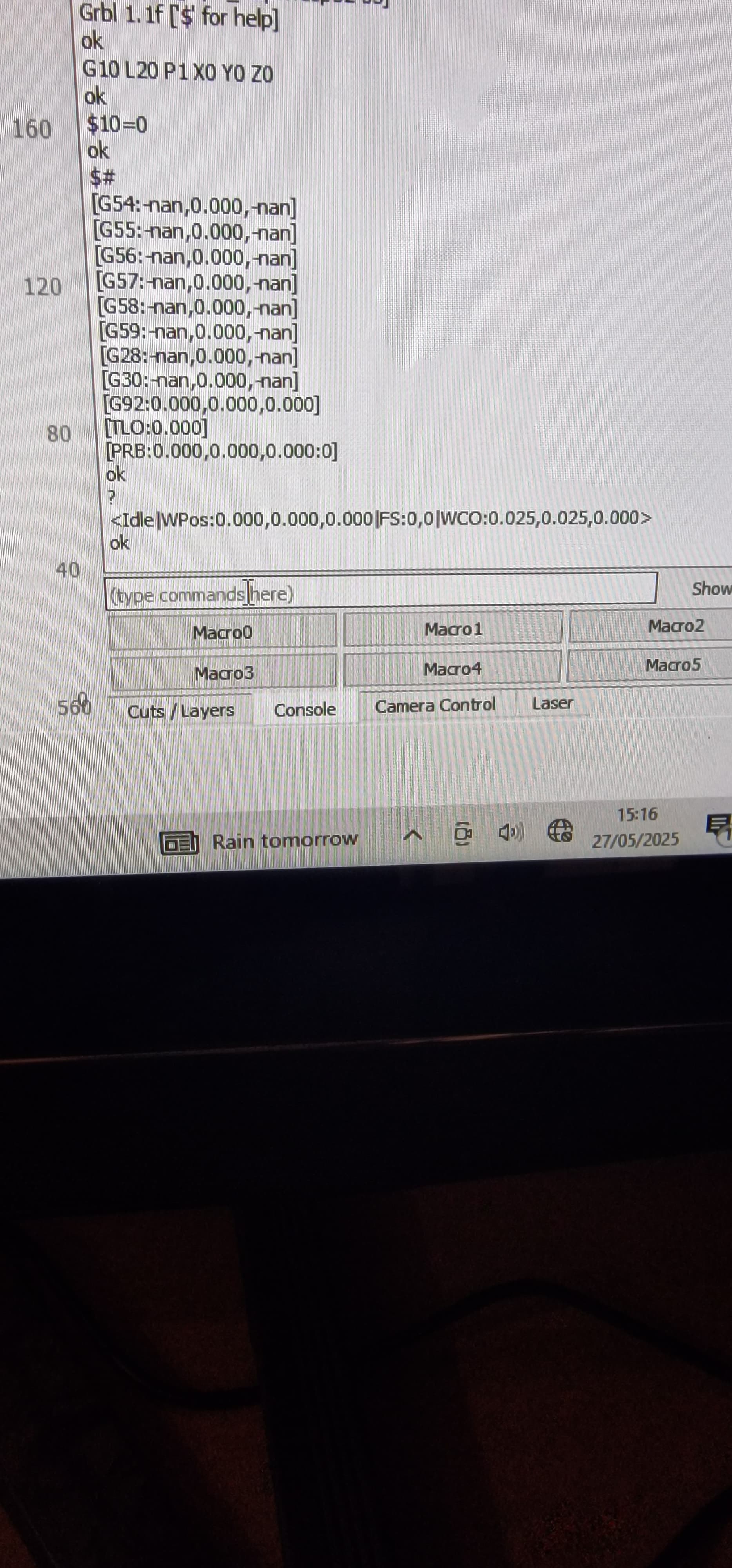

Falcon 2 laser shows g 54, nan
So basically a issue I’m having is if I do a line on a box and a text saying test the laser was okay did job and went home but as soon as I said fill the laser did the job but not go home correctly spoke to creality and they said try with memory card which I did no problems but some reason as soon as I try on pc back to issues
This is what I got after doing your comand

:person_facepalming::person_facepalming::person_facepalming: So still got nan issues as for the laser not going home was my fault it dont go straight home properly is on me so basically when I do a fill job it goes semi home so if I hit start again it no exactly we’re to go
Not really able to follow what you’re saying. Are you saying it is in fact working correctly? Or there’s some other problem still persisting?
Im not really sure it’s tempermentle sometimes it’s fine yesterday I got alarm 3 pop up so don’t know if that would be the main problem or not still have the nan issue but I’ve just been tryingto ignore that

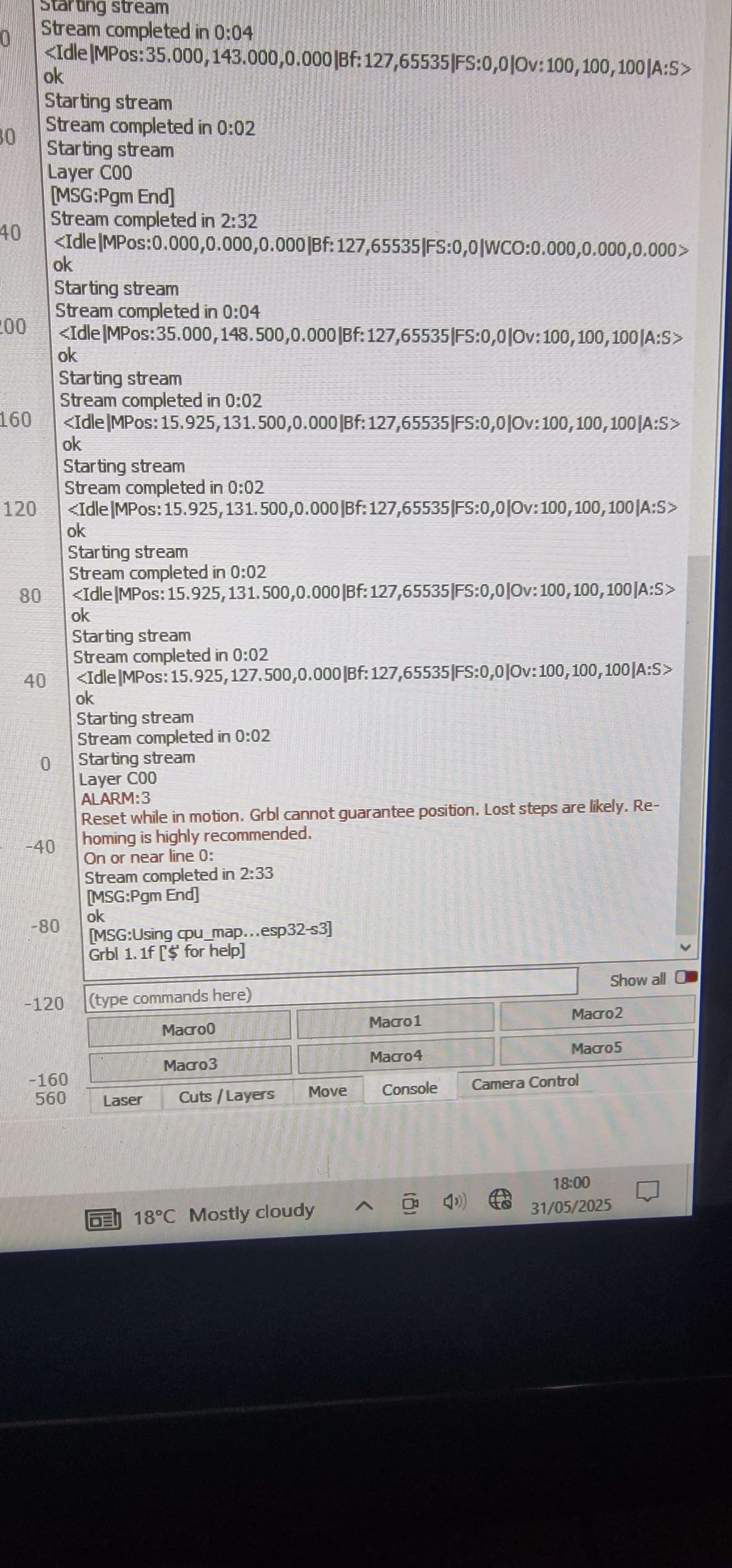

So I was doing cutting to make a box it was doing all good for the first few hrs then I just got this
This is most likely unrelated to the original NAN issue.
Alarm 3 in this scenario is most likely going to be the result of a communications issue possibly caused by a related issue. Essentially, your controller is resetting. This is an extremely common scenario on this forum so I suggest doing some research here. Common culprits include a bad cable, failing power supply, static discharge, electrical noise from the power line, and more.
There’s an outside chance that this could also be indicative of a failing board or bad flash tying it back to the original NAN issue. I’d suggest ruling out other potential causes first.
