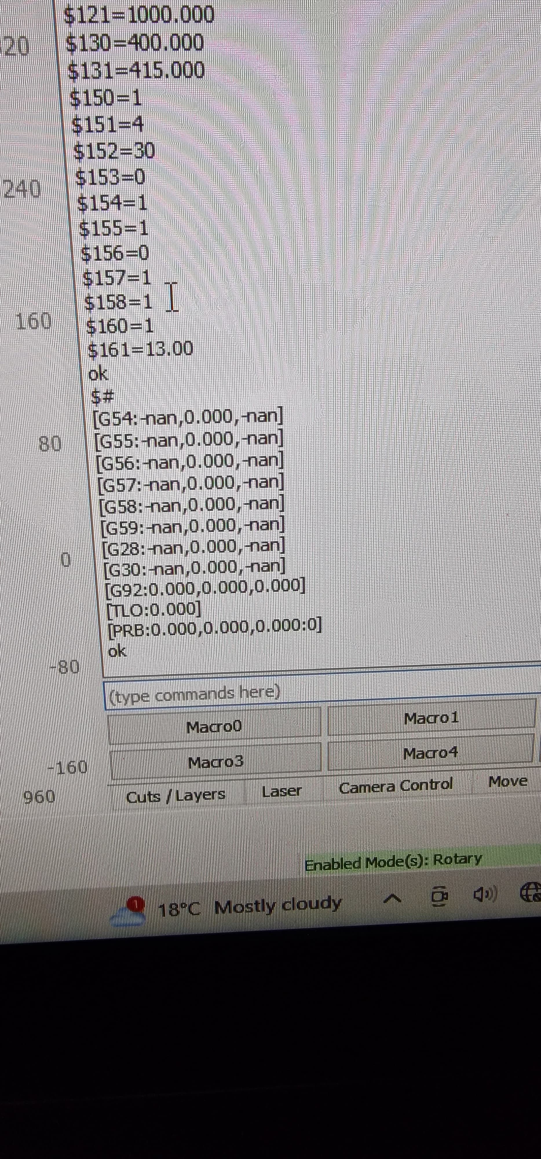

Hi guys really coukd use some help as this has stumped me I’ve tried googling and every thing but no luck so basically I have a falcon 2 laser and I decided to type in $# in console and I noticed I kept getting G54, nan and I don’t know how to correct it really could do with some help and now I’m getting G54 nan 0,000,nan

NAN means “Not a number”. Try entering G54 0,0,0 and see if it takes that.
If it does not, and it is not screwing something up, just ignore it or contact the manufacturer.

And to confirm, you ran this command and nothing at all changed?
$RST=#

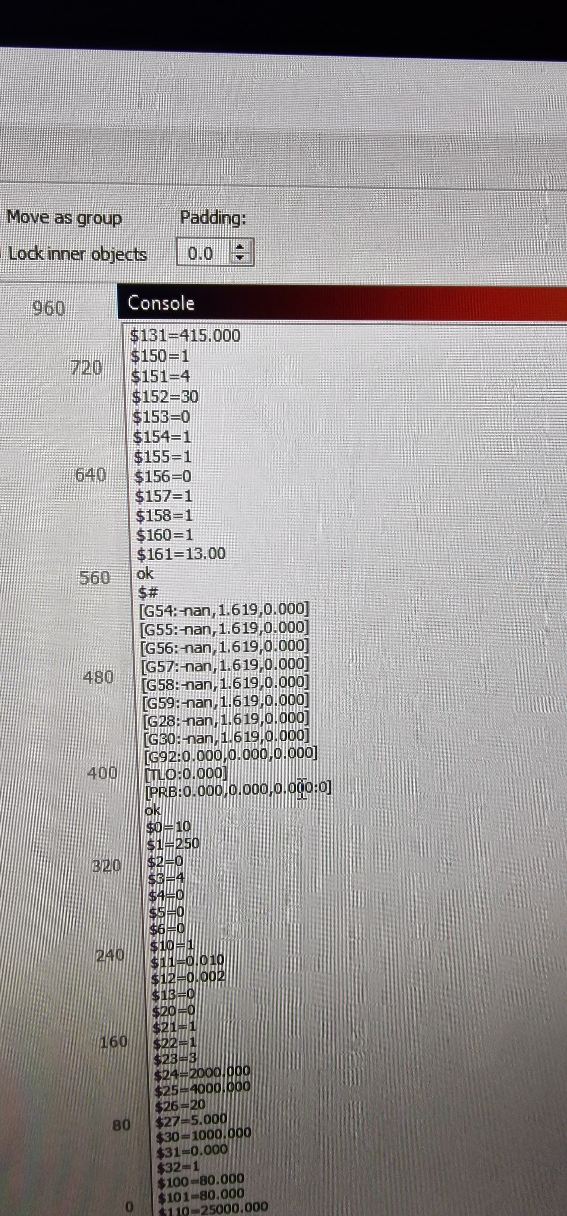

Thanks but I’ve tried $rst=*, $rst=# and still nothing fixed it also don’t know if this is a problem but when I home my laser it sits at 0.03 on x and y
That is the reported value or you’re somehow measuring this?
If you run ? command multiple times what is the output? Can you copy/paste here? It’s likely impossible to say if the issue with offsets is related but may prove interesting.
In any case, I’d still suggesting trying to reflash the firmware.

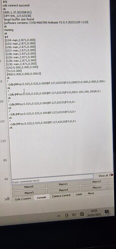

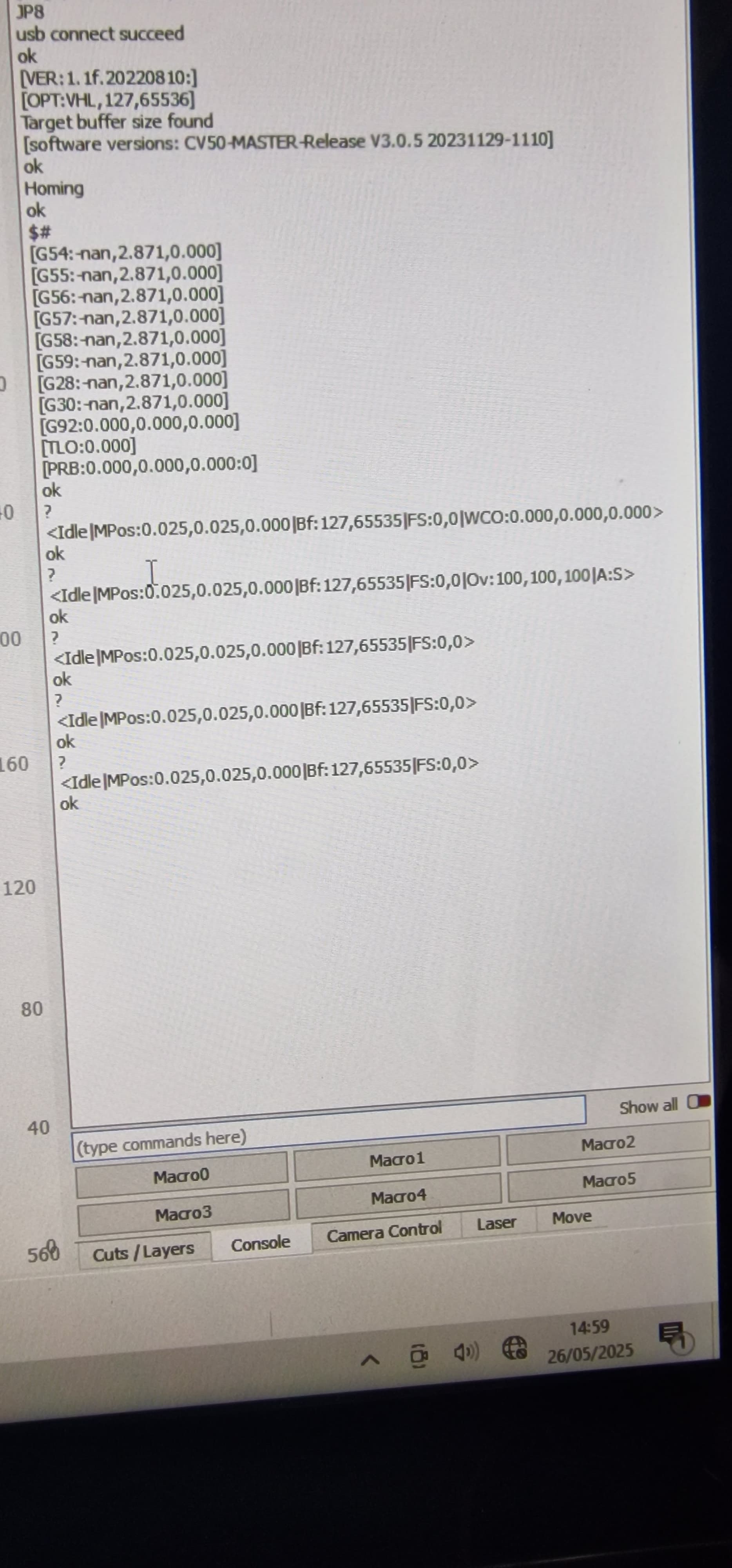

I’ve tried to re update it still same issue this is what happens when I input ?
I don’t see anything particularly interesting in the output of ? command.
You’ve reflashed the firmware and you still get the same output? That’s surprising. But if so, you’ll either have to live with it or replace the controller.
