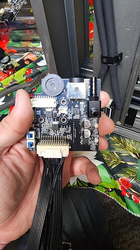

you said there were to grey buttons to disable the door unsealed issue as I do not have doors anymore they are removed. Are those buttons or sliders? I see two blue buttons that stay in or out when pressed and on the other board which I think is the main board there is two sliding tabs that go one way or the other which is on the power switch side the blue ones are on the air input side. any help would be great.
never mind its the blue buttons the problem was i pushed one and not the other. now both blue buttons are pushed in and now i can burn thanks
this is the board that I pushed in both of the blue buttons and now it bypassed the door safety as I dont have doors anymore after a build i did
