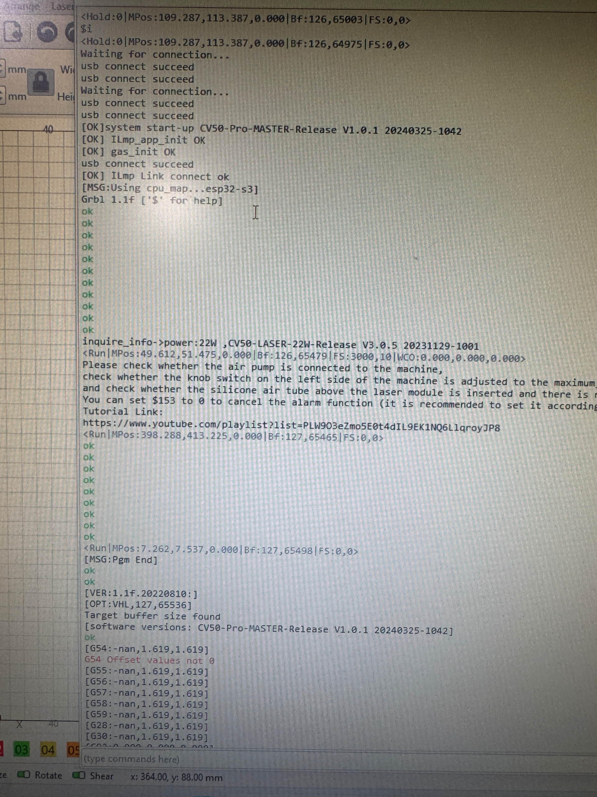

Falcon 2 Pro stuck in startup loop
Hello all. I have a Creality Falcon2 Pro that I got in a nonworking condition. My understanding is that this machine hasn’t functioned properly since a new controller board was installed (from Creality) to solve an issue with the air assist fault. That ended up being a bad airline connection. On startup the gantry moves to the upper right corner then to home in the lower left corner. immediately after homing it starts running in a loop, moving to the max XY upper right corner back to 0,0 home. I’m running the latest version of Lightburn and have tried refreshing the controller board and laser module with the current version of firmware from Creality. I’ve seen elsewhere where the G54 not a number or NAN code cause issues but so far I haven’t been able to clear it using the procedures.
Edit: I sent a basic file to engrave a rectangle from Lightburn and it executed it (although in the wrong location) and went right back to cycling from corner to corner.

After trying #RST=* I got the message: error:1 G-code words consist of a letter and a value. Letter was not found.

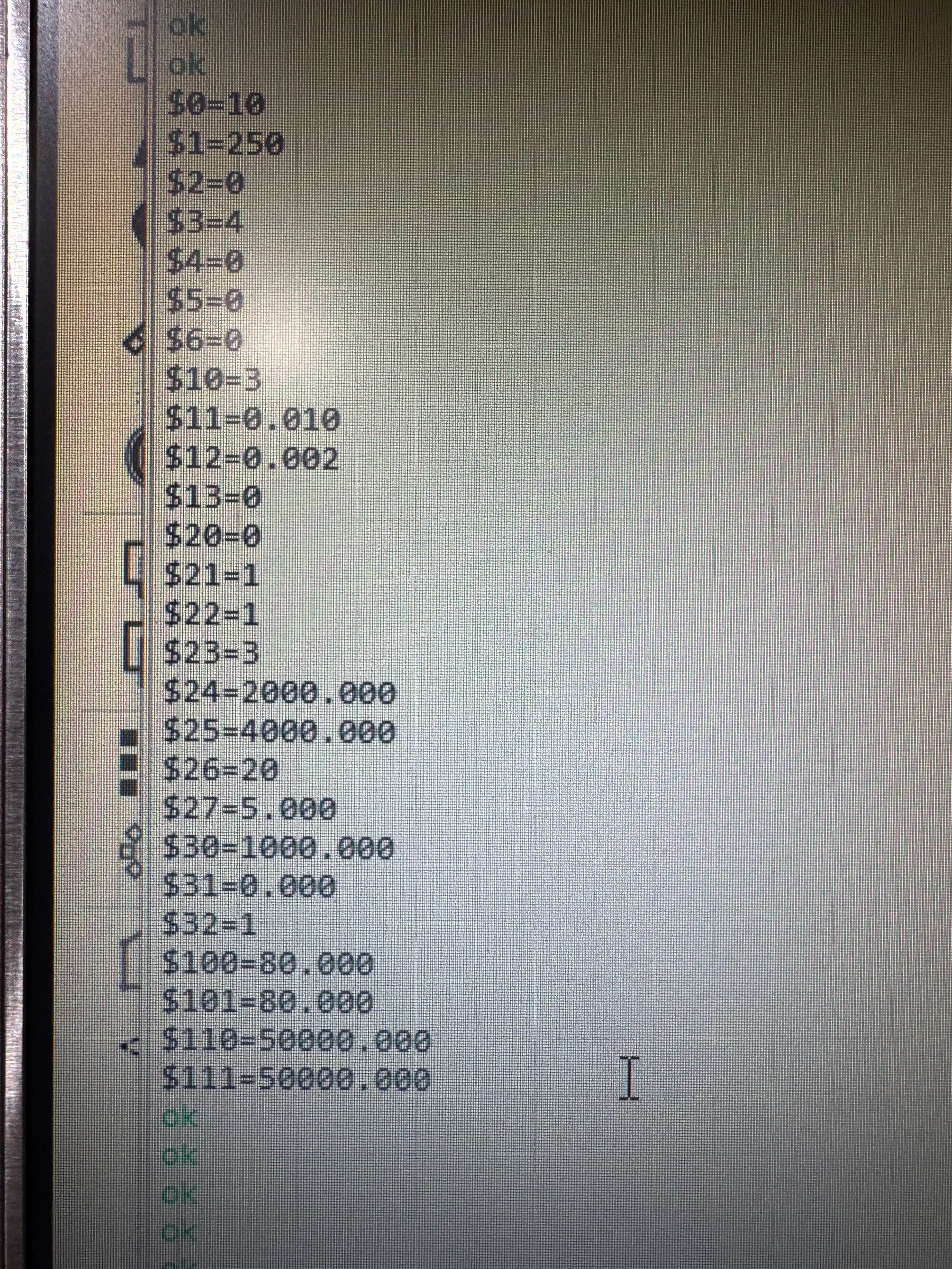

Here are the $$ values:

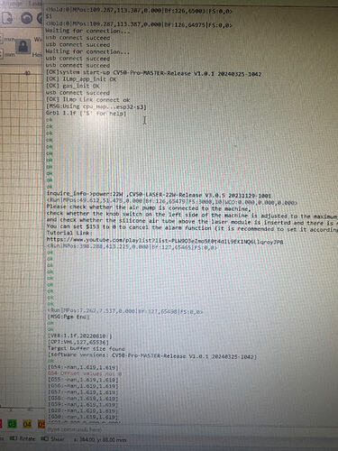

This indicates it is communicating. However it also suggests a USB communications issue. Make sure GCode Clustering is turned off. If it is, then try to find a quality USB cable that is well shielded and has a ferrite (big knot) on it (translation: Not a $10 Amazon cable). Also be sure you are not more than 10’ (3m) for the USB cable length.
Cell phone camera images of a screen are difficult to view. For Console information, Windows copy/paste works best**. For screen captures use SHFT+WinKey+S to create an image.

After the machine reset it didn’t solve the issue. I will work on posting the parameter list. There seems to be an issue with getting comms back in time as I get longer lists depending on when I send the $$ command. I didn’t note it before but I am only able to send commands while the gantry is moving and the response is delayed until the move is done. If I stop it by raising the lid or the stop button in Lightburn, no commands are recognized as it’s in a hold mode.
@mike-oz - I will see if I can find a better cable. Noted on the screenshots for clarity.
The screenshot lacks a lot of settings before the OK 102 112 120 121 122 130 131 and 132.
Try typing them into Console Window to check/input/check values if they stick…

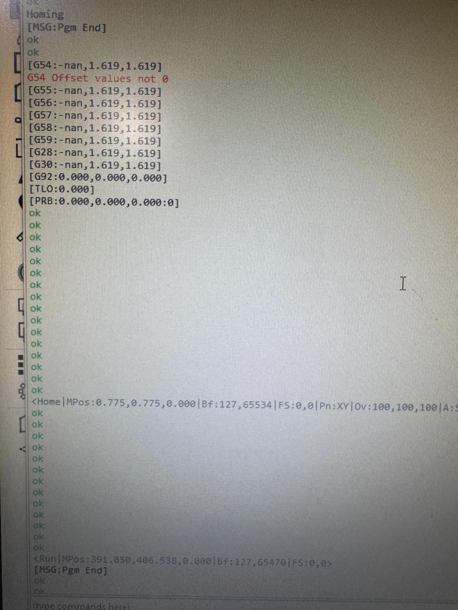

Okay, after digging and more research and reading…
USB GCode clustering is off. USB cable is a standard data cable, and no indications that there is an issue sending/receiving commands in Lightburn Console, assuming the correct syntax is used :slightly_smiling_face:. The issue occurs whether or not the PC is connected via USB port.
After entering $RST=*: (I deleted a bunch of the "ok"s since to make reading easier)

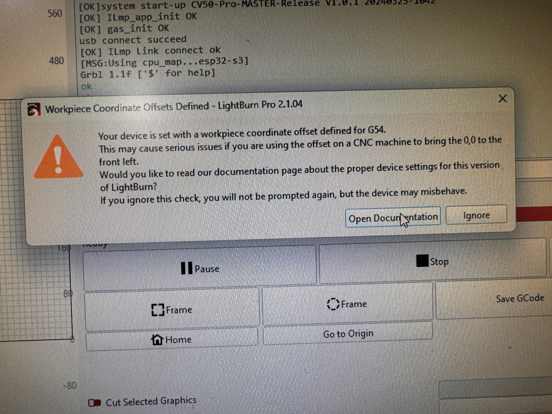

[G54:-nan,1.579,2.085]
G54 Offset values not 0

I can try the ground wire later. Unfortunately I bought the machine second hand, knowing it was a bit of a project so I’m determined to fix it :nerd_face:
You may check for a newer firmware…
Or try reflashing the same firmware or even an older version.
Also pay attention that some lasers have one firmware for the controller and one for the laser head
