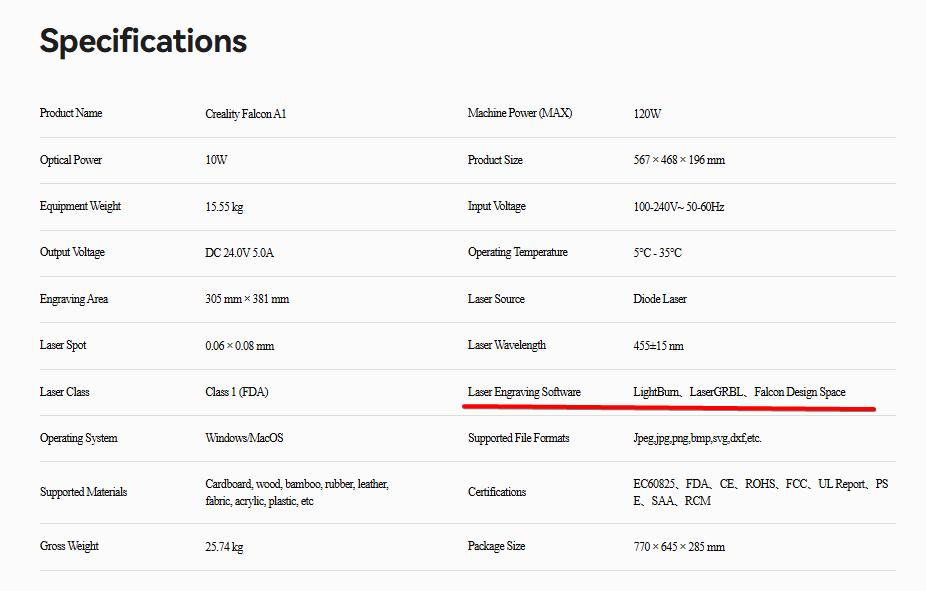

Told by Creality today that Lightburn is not available for this machine yet I see it being used on YouTube. If it is compatible how do I get it?
Hello Cyril
From Creality documentation
The Creality A1 is still a GRBL device, therefore it is compatible with LightBurn.
What issues are you experiencing?
You have kindly answered the problem. It didn’t help with Creality giving bad information. By entering GRBL and naming it Falcon A1 was all it took. It is me being quite dim and very new to lasers. :blush:
