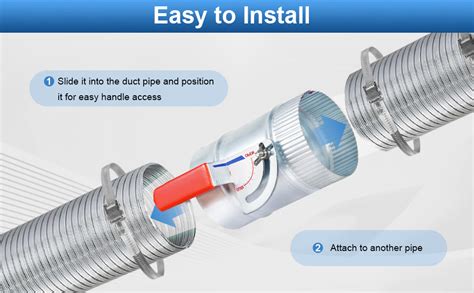

A thought from someone whose laser and purifier hasn’t arrived yet…
Could you introduce a Y into the tubing between laser and purifier, and add a baffle that you can adjust to get the correct air flow? I’m thinking about stuff I’ve seen for wood stoves.
So the baffle would be used to -add air- to the vacuum stream between the purifier and the cutter, to reduce the vacuum ‘presented to’ the cutter.
