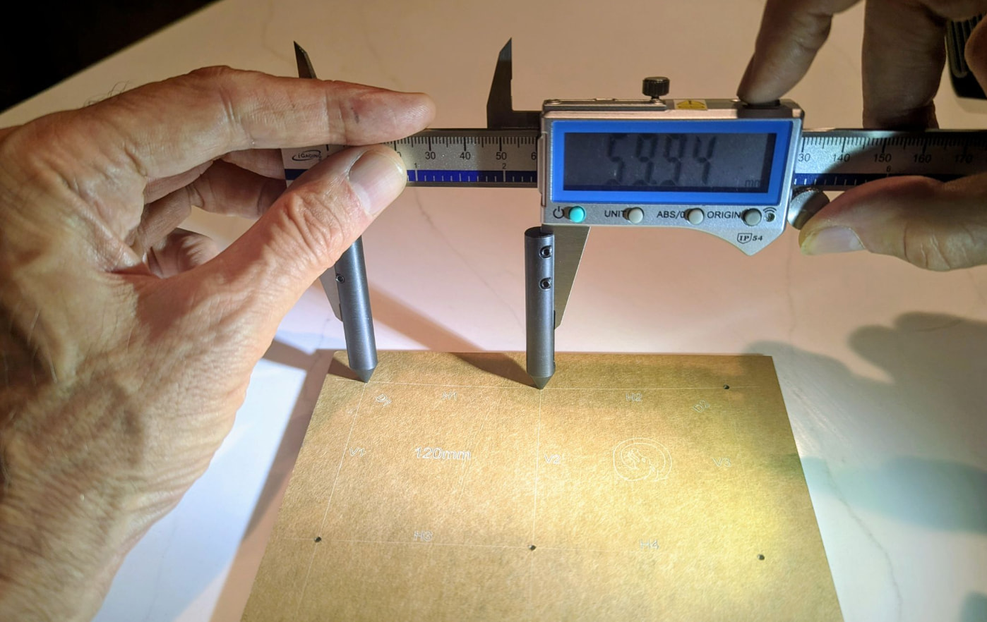

This photo of the digital-caliper measurement shows how the caliper tips self-center into the holes. The bluetooth link button is under my right index finger. To self-center reproducibly, push down on the caliper with the left hand between the tips, and wiggle the wheel back and forth with the right thumb.

  1. With the burn file linked below “GalvoBurnCal”, adjust the burn setting to give a cylindrical hole that is deep enough so that the tip of the centerline gauge does not bottom out of the hole. My settings are for a 6W UV laser, the ComMarker Omni X with the 150x150mm lens.
  2. Install the centerline gauge on the calipers, making sure that the tips of the two cones are level.
  3. Measure the offset of the centerline gauge. This can be done with another set of calipers, but the easiest way is to measure with a pair of holes drilled by a CNC with a known separation. My measurement is longer than the design value, so I use an additive offset of -0.33mm.

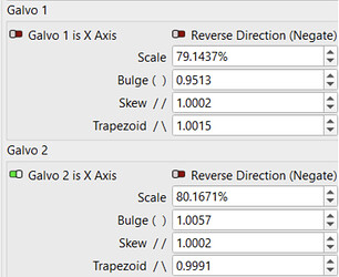

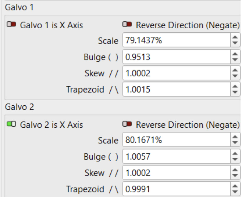

The initial calibration starts by selecting in Lightburn the “Laser Tools / Device Setting”, and then selecting the “Galvo and Basic Settings” tab. Set all the lens parameters on the bottom left to 1, and then adjust the “Scale” settings so that the burn pattern “GalvoBurnCal” with 120mm spacing fits on your acrylic sheet. For my galvo, it is 80%.

  1. Here are the settings of the LightBurn parameters after the 3rd calibration

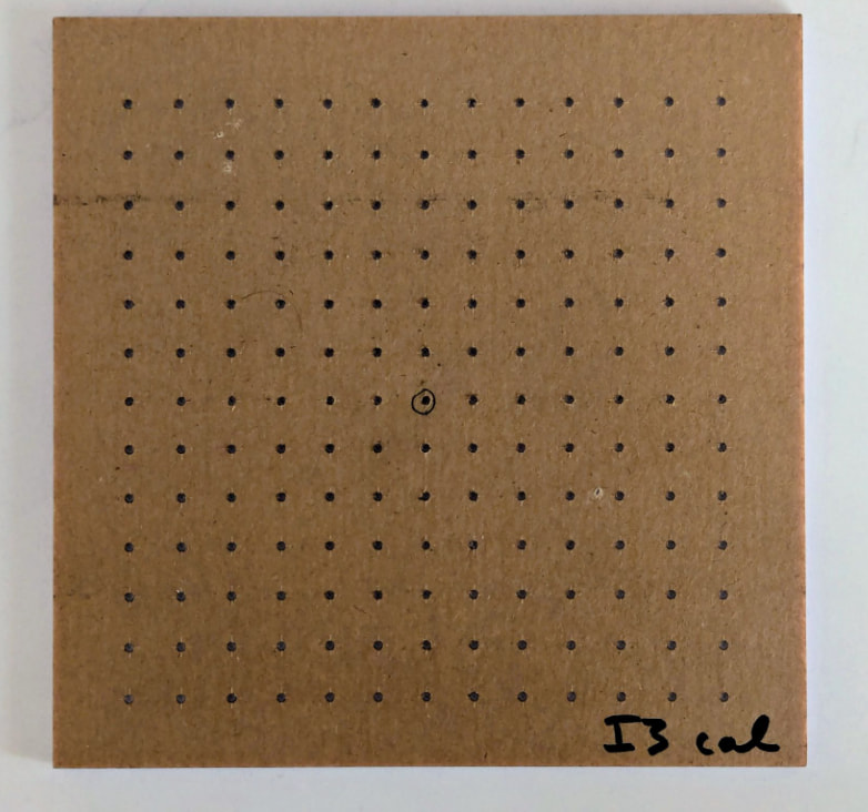

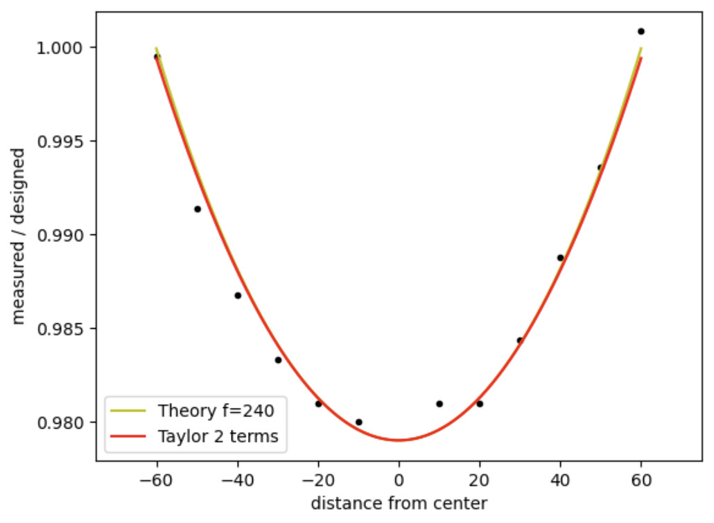

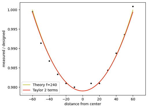

The problem: angle non-linearity. When I burn a test calibration of an array of holes with 10mm spacing, I see non-uniform spacing. This can even be seen by eye in the photograph below. This comes from the geometry of the galvo lens writing to a horizontal surface, since the Lightburn software controls only the angle of the galvo lens.
For this geometry, the angle theta is converted to a horizontal distance d’ by the formula
d’ = f tan(theta)
where f is the focal length of the lens, specified as 231mm for my system. LightBurn is calibrated using the approximation that the angle theta is small and given by theta = d/f, giving d’ = d, where d is the designed distance. Expanding the tangent formula in a Taylor series to the next correction, one finds
d’ = d[ 1 + (⅓)(d/f)^2 ]
This idea can be tested by measuring the distance between the center mark and holes at varying distances. From the above formula, the ratio of the measured d’/d versus d should have a parabolic shape, with a curvature that corresponds to approximately the focal length of the lens. This is plotted below, and the best fit of the focal length 240mm is close to that specified for my lens. The calibration was done at 60mm, where the ratio is 1 as expected. There is a significant change in the spacing near the origin, about 2%.
It would be useful for LightBurn to include this angle correction, as then the lens could be further calibrated to have very low distortion for precision etching.
