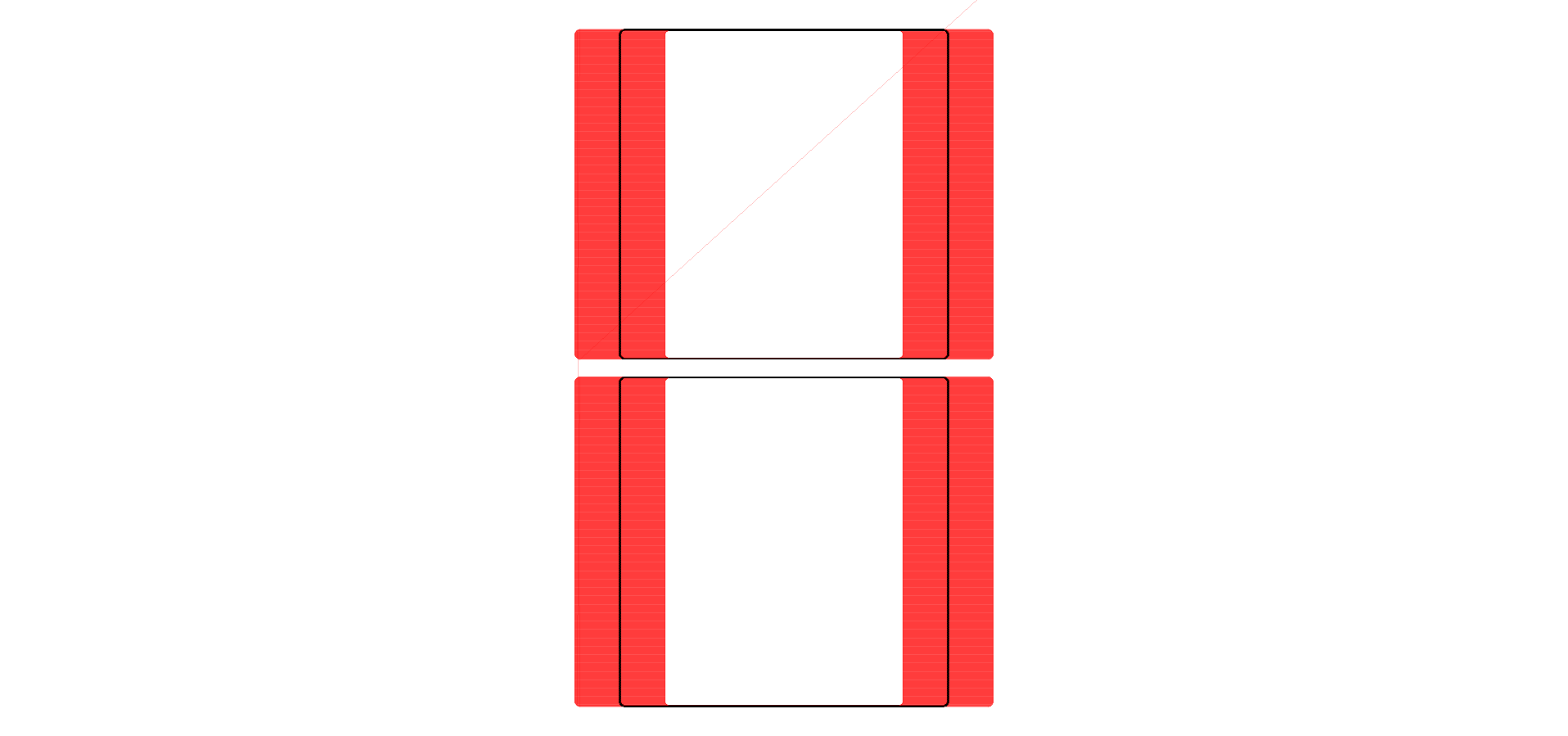

It may sound contradictory, but sometimes a lower speed can be faster!
The red area in the preview shows the extra distance your laser travels to decelerate and change direction.
→ Less speed means less momentum to slow down. Sometimes, this still results in shorter job times.
