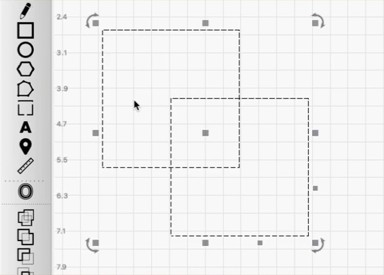

In addition to the scissor tool that’s coming in a future release of LightBurn, it is currently possible to do this with the Trim option of the Edit Nodes tool. With the Edit Nodes tool selected, hover over a line and press T to trim it back to the next intersection.
2024-05-31_15-57-55 (1)
2024-05-31_16-00-29
