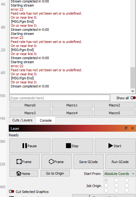

Feed Rate where is it please?
Hi, today my laser will not answer to the start button, I set up the workpiece the same as usual, framed it ok but when I went to start the job this message came up. Now I am lost hoping someone can help.
What is your speed set to in cuts/layers then each layer?
It looks like LB is sending a wrong gcode dialect to your device. Which device do you have, and what is the type you set in LB devices?
4240 Laser Engraving Machine
Your controller/ firmware: GRBL
Your computer: Dell OptiPlex 7080 SFF running windows 10
I have GRBL in LB devices
Only one layer. Image set at 2000 50%
Could you attach a copy of your .lbrn2 project file so we can take a look?
Also, please go to ‘Edit > Device Settings’ and take a full screenshot of your device settings for us to review.
Problem solved, many thanks to all that participated. am most grateful.
And. What was the fix?
Don’t know, started a new project and it seems to be ok
Check your cut file and see if you forgot to put a speed in. Or if you did put a speed in delete it and enter another speed a little different then save the job. Make sure you don’t have any spaces before or after the speed. Just some thoughts
