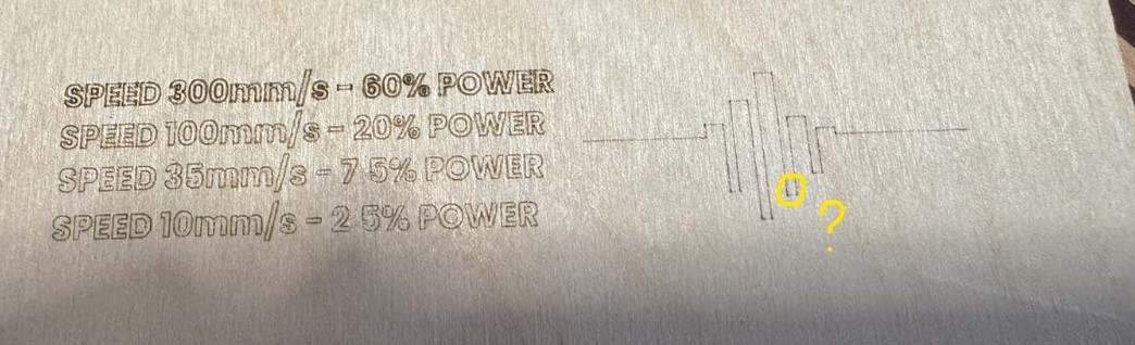

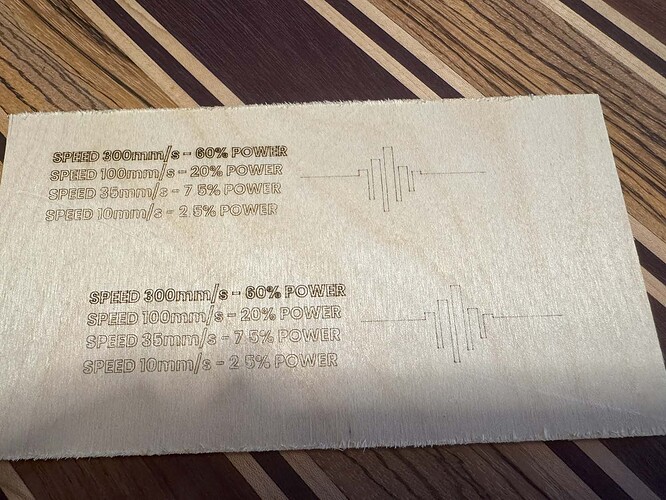

Okay, so I downloaded the Wobble file that Frm178 posted and ran a test. Before running the test I thought that there was a possibility that the wood was shifting from not being secured down so I ran the test twice, once with the wood unsecured and then again with the wood secured by rare earth magnets. The funny thing is that both of my test burns didn’t produce the same wobble lines. There is a wobble in the upper left but that’s all I could detect. I have enclosed pics.

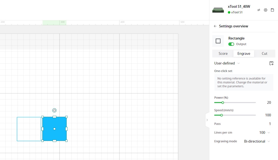

Here is the gcode that XCS sends to S1 when running a job with a simple square in score mode, and the same square next to it in engrave mode.
gcode_fromXCS_score and engrave square.txt (22,0 KB)
I suppose you suspected that it will feature only single X-coordinates commands in the gcode? If so, you are correct. Your theory about different interpretation/acceleration depending on whether one or two coordinates are provided may be right.
Not sure how this will affect the dev-teams solution/options to get rid of the wobble though, since the thing causing the wobble seems to be within the S1-controller and how it translates the gcode commands it is sent. So the actual cause/fault in not in Lightburn, but it might still be necessary to change what lightburn sends to the machine in order to get it to work corretly (as it obviously does with XCS).
Interesting, thank you for running the test.
Stupid question :sweat_smile::
Can you verify that the actual settings of the layers are really the values that the text describes? (layer 1, 300mm/s @60% power, etc). It seems a little strange that the first line is so much darker than the following 3 lines of text, since it should all be the same speed/power ratio.
It almost looks like you do have some wobble in the line-graphic on the right side, but less pronounced than on my machine. Can you take a closer shot of it?
It might just be the grain of the wood and a bit misleading therefore, maybe you can run the test again on some flat surface like a simple sheet of white printer paper?
If the culprit is really resonance introduced by the rapid movement (which I believe it is), then it is a much bigger pain to get rid of without decreasing the speed and accel values.

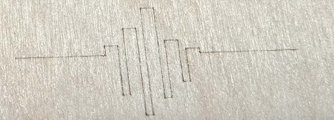

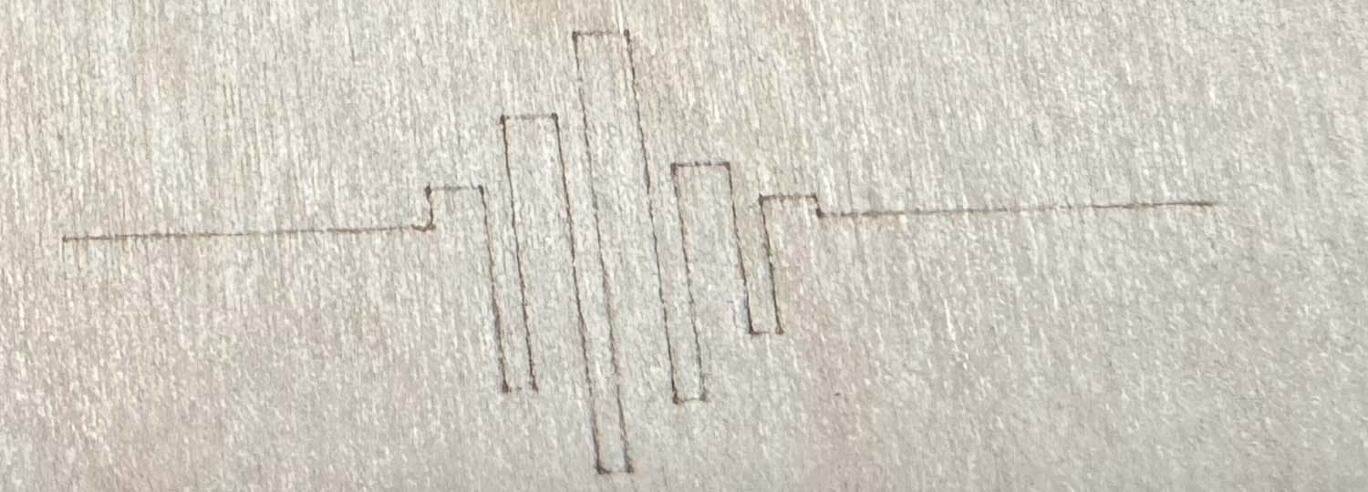

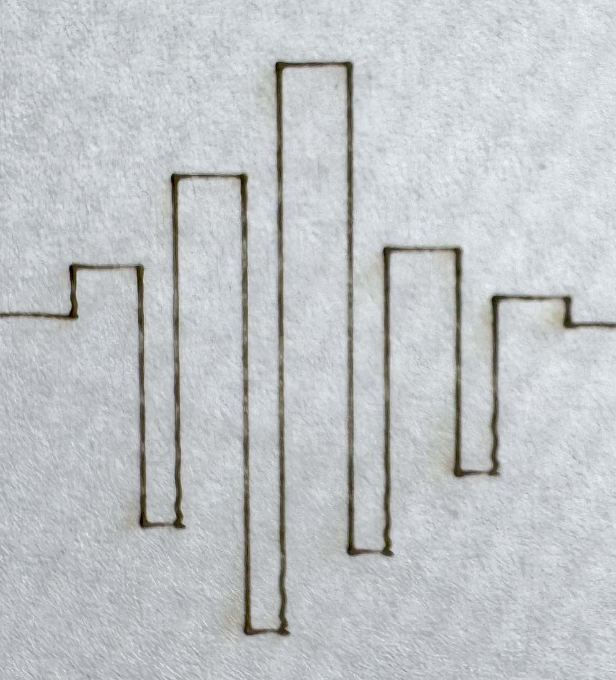

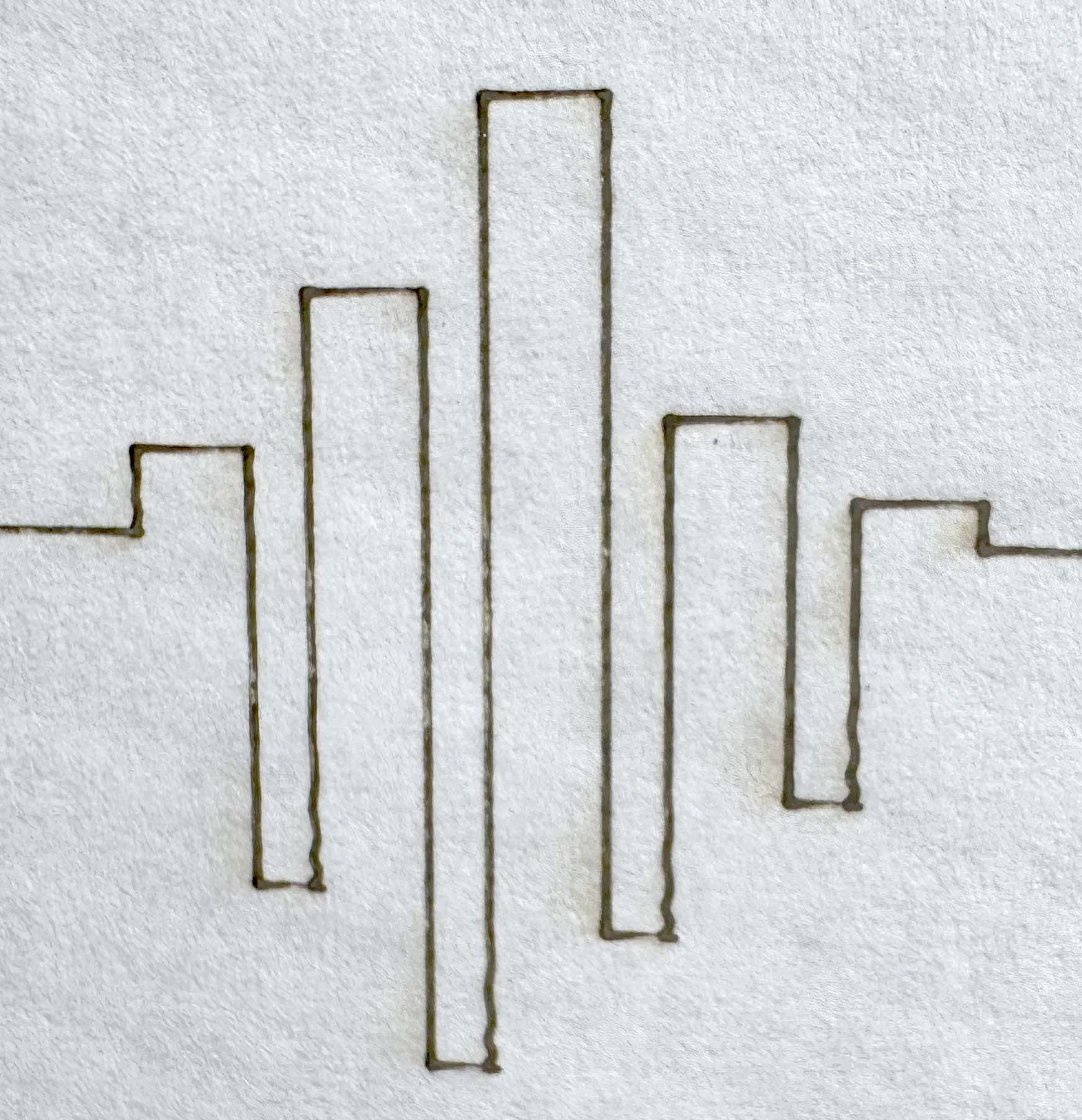

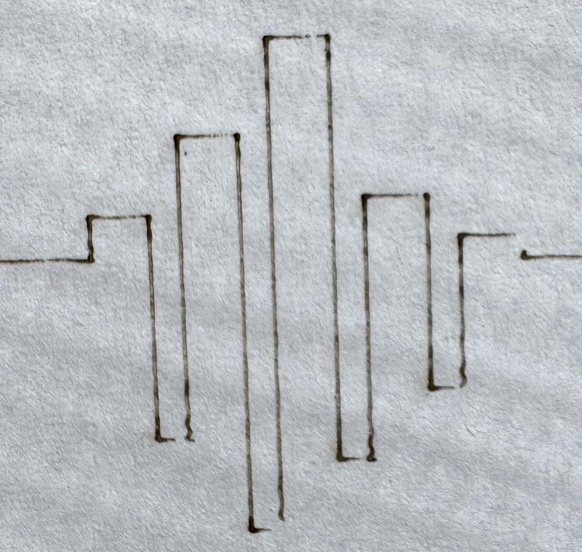

Ok, so I wanted to test this again and get it posted because this thread is due to close in 3 hours. I did the burns on paper to eliminate the grain of the wood effecting the results. The first image is 300/60 the second is 250/70, and the third is 200/70. I zoomed in close for the photos. All three exhibit the wobble.
Thanks for doubling down. :ok_hand: I was really curious if and why your machine wouldn’t behave in the same way. But it now seems coherent with my results
