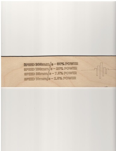

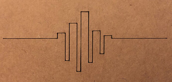

Hello I ran the wobble_01.lbrn2 under lightburn 1.7.04 and here is what I got with my 40w xtool s1 -

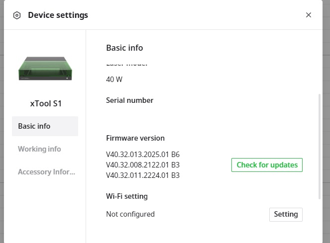

Are we all running the same firmware?
Could you post yours please?
Not sure if you already did but for the sake of continuity?
ok, here is my firmware…
I also have my units set to mm/min I thought somewhere someone said if you had it set for mm/sec it would cause issues.
It used to be mm/min and mm/inch would cause issues, I believe this is patched.
ok, I will have to test when I get a chance, and see if there is a difference. Thank you, Brian

I just saw that RC4 dropped. I compared GCode output from RC2, and they were the same outside of the version number incrementing. Do the developers have any info on adding the X/Y moves to reduce the wobble?

Could you guys give RC5 a try:
The RC that Gil linked above includes code that always outputs X & Y GCode when generating cutting moves.
If I save to a gcode file will it also write both X/Y? As I’m not seeing that happen.
That is a great question - that is @LightBurn question.
There is no difference between running a job and saving the GCode - the way the GCode is generated is identical.
X & Y coordinates are only forced to output if you’re running a Line or Offset Fill layer (not Fill or Image), and only if you are using the XTool specific device, not GRBL or generic gcode.
Understood. Thanks!
Thank you Oz!
I can confirm that the wobble-issue has been resolved with this version :ok_hand:
Thanks to everyone involved in fixing it, I appreciate your efforts :pray:
