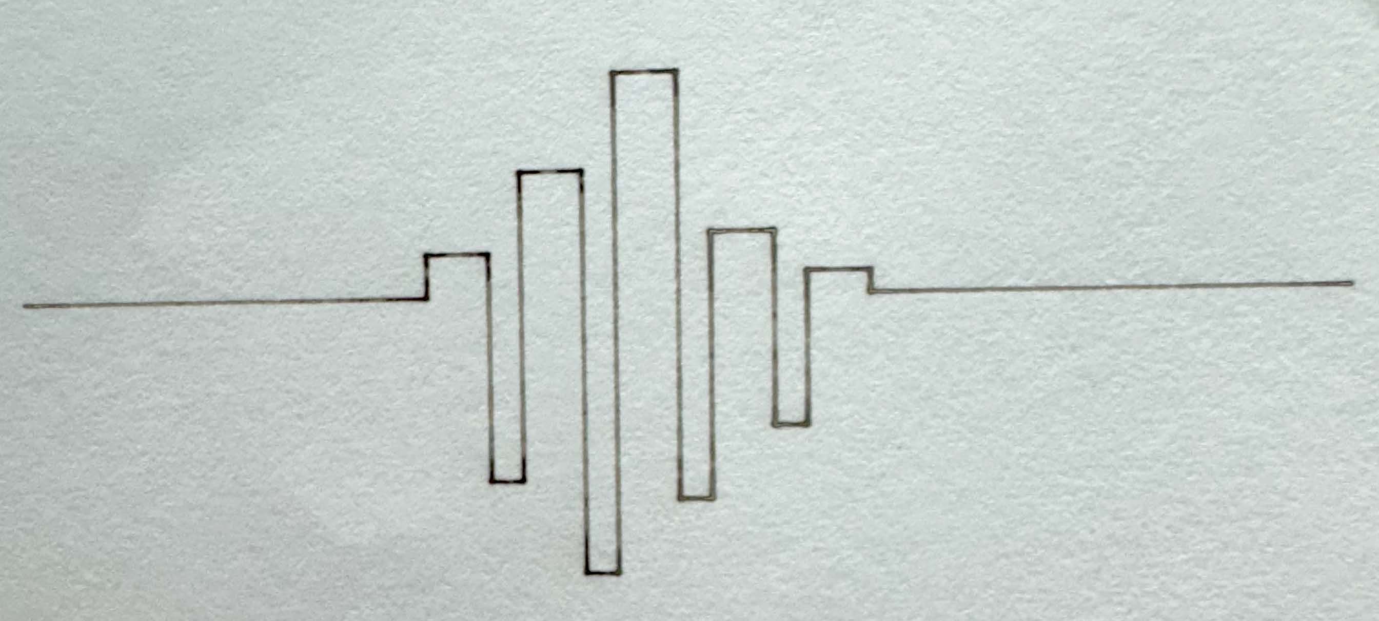

LightBurn created a new protocol called XTOOL. After adding the S1 laser device using the file from xTool instructions - Operate xTool S1 with LightBurn - xTool Support Center - you need to double click the laser and change the protocol to XTOOL.
This should fix the issue shown in the photo
This is how it should look like at the end

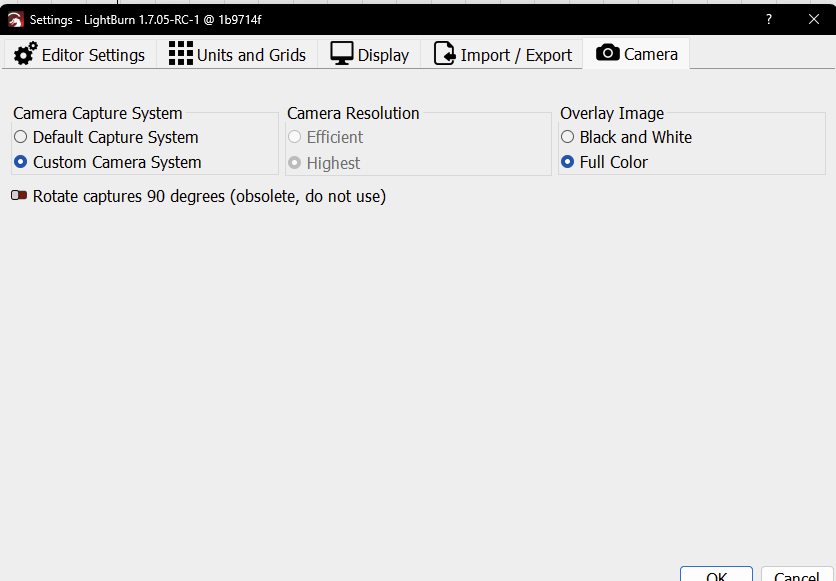

In the 1.705, how do you select efficient vs highest for camera resolution. It does not allow you to change this. Please see picture. Thank you Brian
short answer: You don’t. (since you’re on Windows)
That option only worked on MacOS with the earlier versions of our drivers in 1.7. And it didn’t work very well. Lessons were learned. Don’t worry about it.
It’s going away next version, we’ve got much bigger efficiencies coming.
