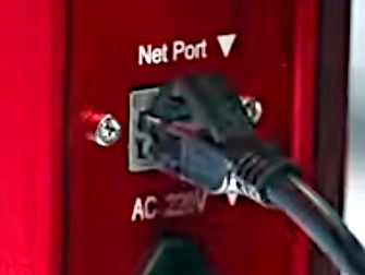

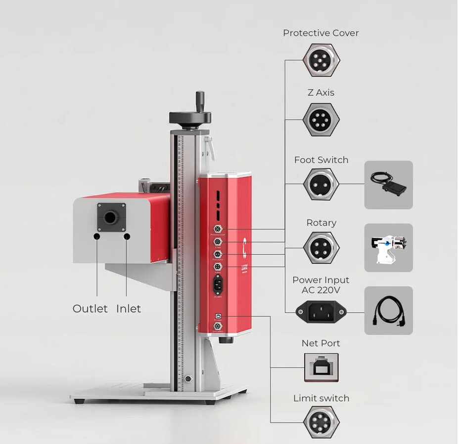

I guess I have found one with a “net port”… This is a 355nm (UV) 5W Cloudray TR series.
So I guess they’ve wised up and put Ethernet in these.. :man_shrugging:

It says “Net Port” but if you zoom in on the image and look at it, it’s still a USB port.
I think you’re right, especially since there is no other means of communication.
Looks like a usb 2b type.

That is the sort of square one they use a lot for printers?
Like I said, something’s not quite right here…
It’s true that it’s USB B in the picture, but if you watch this https://www.youtube.com/watch?v=RAdiXYmvP_8 and pause it at 0:45…
you’ll be even more confused than you are now… I know I am.
Cheers
It does look like an Ethernet connection in the video. Next time I email them, I’ll ask.

I agree with @jkwilborn , that is an RJ-45 connector. But that does not warrant they used it for an Ethernet connector.
Just over a minute in, it sure looks like an Ethernet kind of duck:
They claim Cloudray Partner LightBurn Software For Laser Cutter Control / Galvo Laser Control, but note LightBurn is for “EZCad2-based Galvo lasers (fiber, CO2, or UV) connected with a USB cable.”

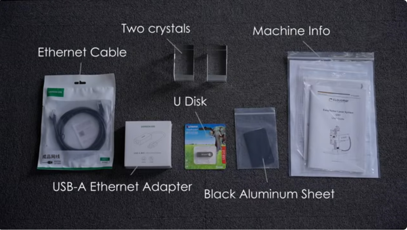

The video shows them using it as Ethernet and specifically state that’s being used, but also there is included a usb a → Ethernet Adapter. Screenshot from 0:13 seconds into the video.
I suspect it talks through usb, through the adapter to the machine using Ethernet. How it does that, I don’t know or if it’s their specialized software for it.

You can use Cat-5 cable for USB, it is actually much better quality. And allows longer runs without an inline booster. If I had to make a long run with USB, I would get a couple of USB to Ethernet adaptors for each end and run CAT-5/6 cable.
Definitely many confusing things on that machine for sure. Would be interesting to hear the real story.
Questioned Cloudray about that ‘net’ connector. I think their replay is pretty clear.
First, the machine does not support connection to a local area network (LAN).
I had a few questions for them they answered pretty quickly.
I though you’d like to know along with those just curious, it’s not a network connection, just uses network type connector/cables.
