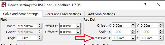

this mtehod may not require the accuracy of a double sided PCB. The trick is setting your Rest Pos in the galvo setup so your workspace is the same as the template.

@soniclab what do you mean Rest Pos?
For galvo, center your red dot / laser to the center of the workspace. That way you can more easily align your jig in the workspace.
