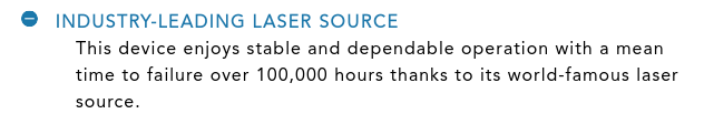

You should get a lot more hours out of it than that… Most have 100k hours as the MTBF. This is my MOPA…
This is one of the smaller ones… it’s not a MOPA. I didn’t dig into this devices source type.
