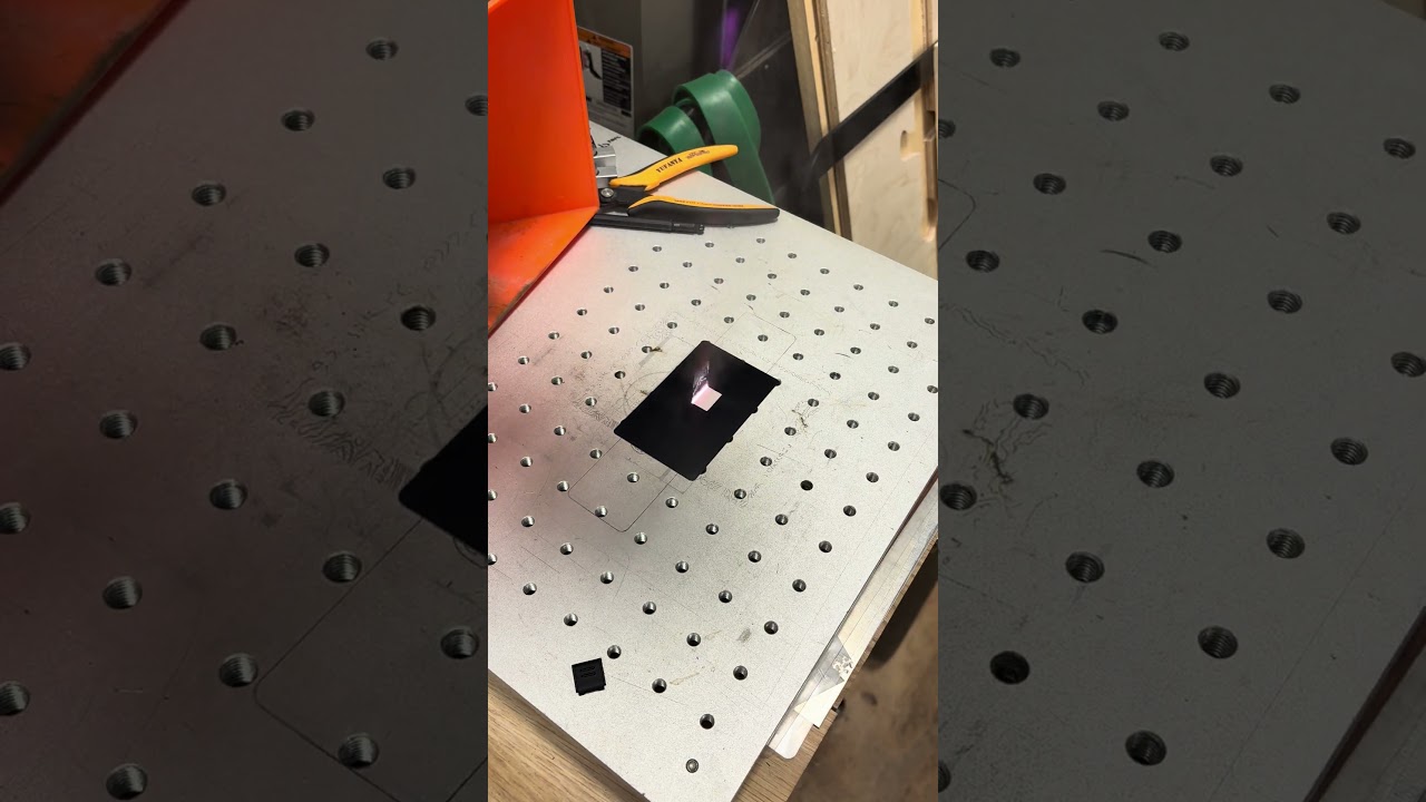

I have an OmTech 30w Raycus fiber laser and the framing function just stopped working for me this weekend. The laser engraves fine but framing doesn’t seem to work. As you can see in the video that I will try to upload, I’m using a Windows computer with the latest version of LB. I’ve reseated all connections that I can easily find, but don’t mind popping a cover to check internally on the laser if needed. I’ve put screen shots of my settings from LB that you can pause or whatever if needed. Thank you in advance!
Well, I can’t seem to upload the video, or I can’t seem to find the option…I’ll work on taking screen shots, I guess.
Here is a link to the video that I wanted to upload here. You can see the function…or lack thereof, in the video. Thank you again!

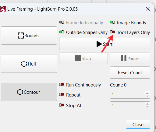

Have you tested it in another software to see if the red dot used for framing is broken? Did you change any of your LightBurn settings?
You have image bounds enabled in your framing settings, does the framing behavior change if you disable this?
I would try enabling Red Dot Always on too:

The “always on” for the red dot didn’t change anything and it didn’t effect the framing. No, it doesn’t respond when I change the setting from “bounds, hull, or contour”. It’s not responding. I’ll report back after I check with EzBad. LOL

I’ve never worked with these machines, but I see something that I’m not sure could be the cause of the problem. I’m probably wrong, but if I’m not, I can help solve the problem.
I know that these machines are extremely fast at taking the “frame,” so much so that it has to be repeated several times to get an idea of ​​the area to be engraved.
In the video, I don’t see any selected option, which, in my opinion, may mean that it takes the frame only once and doesn’t do it again. Because it’s so fast, it seems like it didn’t take the frame.
Shouldn’t at least one of these options be selected? :thinking:

I’m not sure how it happened or why, but I found the solution!
If you have issues with your laser not framing before firing, check the “Tool Layers Only” toggle in the framing/firing screen. I’ve got a screen shot for reference and it solved the problem.
I was trying everything and this worked!!
That selection doesn’t appear to be saved, so you have to click it every time. At least with my fiber using 1.7 version software.

Yeah, it was kind of weird…I’ve never had to check it before to get the fiber to frame. I’m not sure if it was a mistake on my part or a glitch in the software. Either way, I got it working, life is good.
