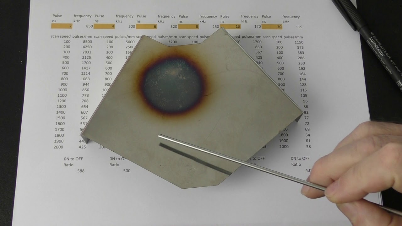

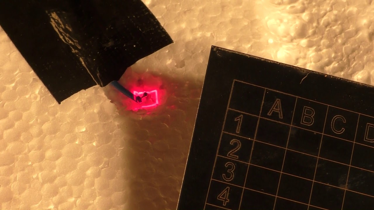

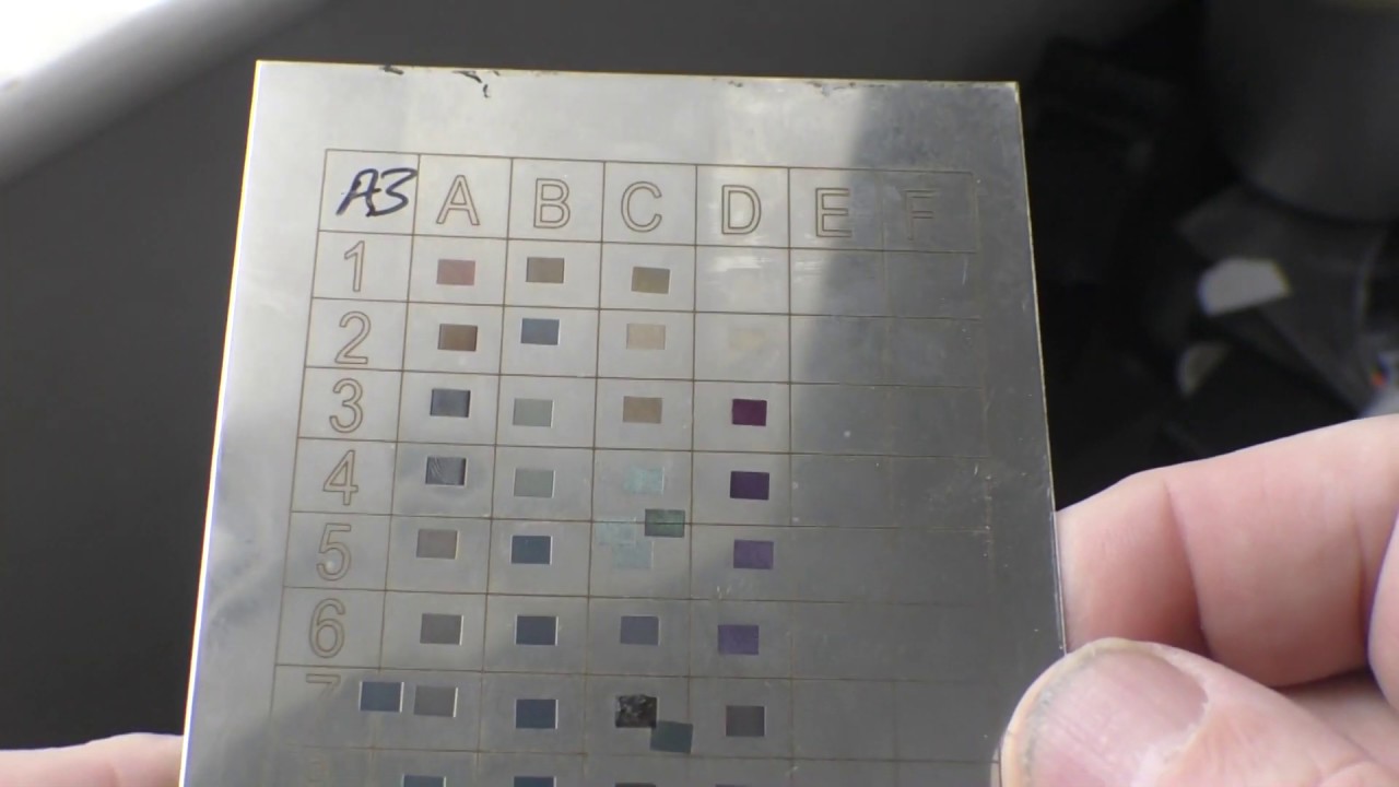

Has I understand, I’m not able to make color (on stainless) with a 50 -100 kHz !
jkwilborn
(Jack Wilborn)
July 5, 2024, 7:41pm
6
To get a good variation of color you really need a mopa type. Some of these colors only arrive with short pulse widths in the 8nS area.
Even hatched or non-hatched give you variations.
