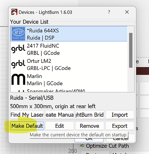

The (*) appears only when I have my Ruida selected as the default device. (Origin top left) not when i have the Ortur LM2 per default. (origin front left)
Do you have multiple default lasers and recently changed the default one?
Thanks for the quick look at this.
Yes, I have 7 or 8 Device profiles, some different CNCs, but also variations of same units.
So I recall a day or so ago that i altered the device settings in my default device profile, changing the ‘Working Size’ ‘Width’ and ‘Height’ values. I believe that was after opening a previous version of this file, then doing a Save As to create a new instance. The file has been saved numerous times since, so the discovery you made makes perfect sense in your use case, but in mine I have not changed my device profile since that one time of editing it early on in the file design workflow, with numerous saves of the .lbrn2 since and numerous close/open of LB app. So I’m still confused.
