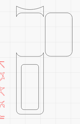

File exported from fusion 360 to dxf does not allow bolean

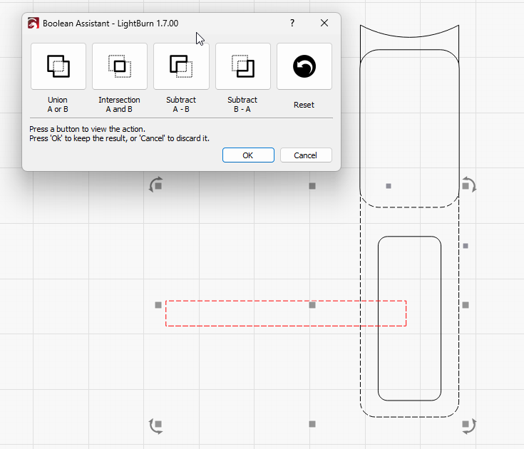

Hi, I exported a sketch from fusion 360 which I need as a template for inserting a vector, but when I go to create the boleyn (in order to cut out the vectorial) the bolean tool is not active, the problem lies in the dxf file as on a simple shape with the vector layout the boolean works, unfortunately it is not activated on the dxf file. I don’t know what the problem could be? . Thanks in advance

Check that all shapes are closed and you are only selecting two objects.
Edit → Select open shapes will select all open shapes.
If this doesn’t work for you, please include your .lbrn2 file… You can drag/drop it on the reply window.

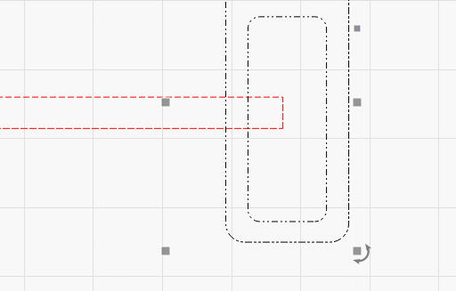

Red shape I drawn, and the DXF was imported normally:

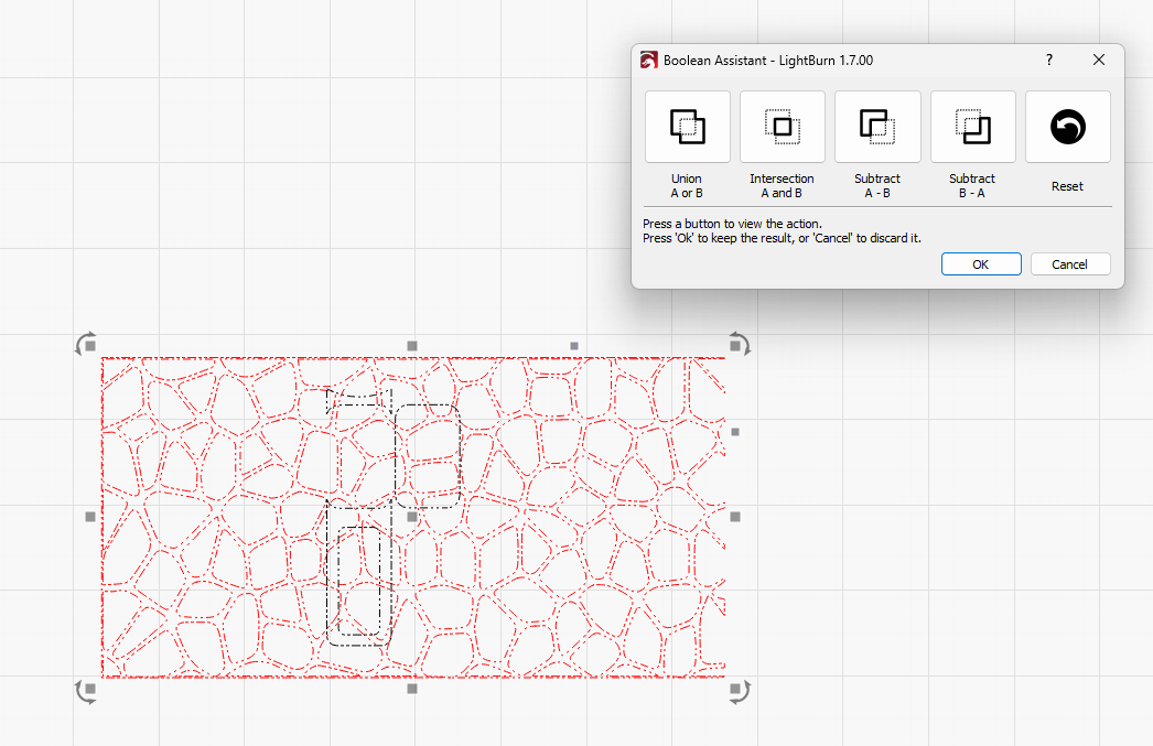

If you want to do a boolean operation on both the inner shapes, you must group them first
Could you try again?

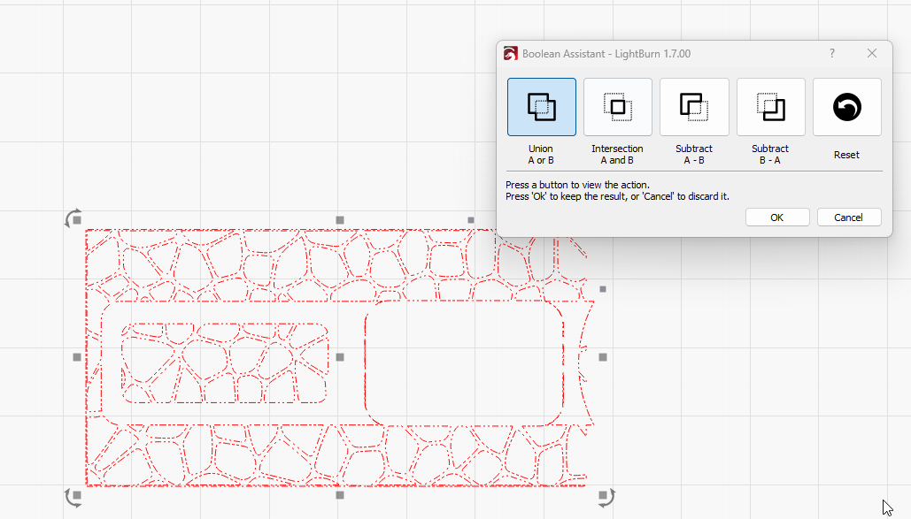

Thank you very much for your answer, I had already tried to group the selections, but the Boolean doesn’t work anyway. I’m sending you the entire lighburn project
test2.lbrn2 (163,8 KB)
PS: the dxf file would be the basis for cutting the vector that I have to engrave on it, in fact I don’t have to engrave that, but I will only need it to have, let’s say, a basis on how to cut the vector to envy above :slight_smile:

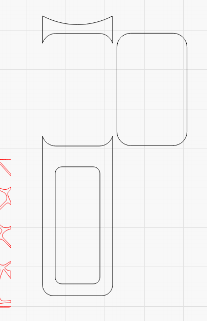

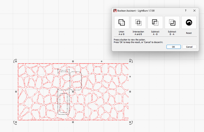

Giuseppe, the issue seems to be - and I missed it at first - the full DXF shape has open shapes.
Edit > Select open shapes
This means when grouped, the Boolean assistant cannot compute the operation because the open shapes.

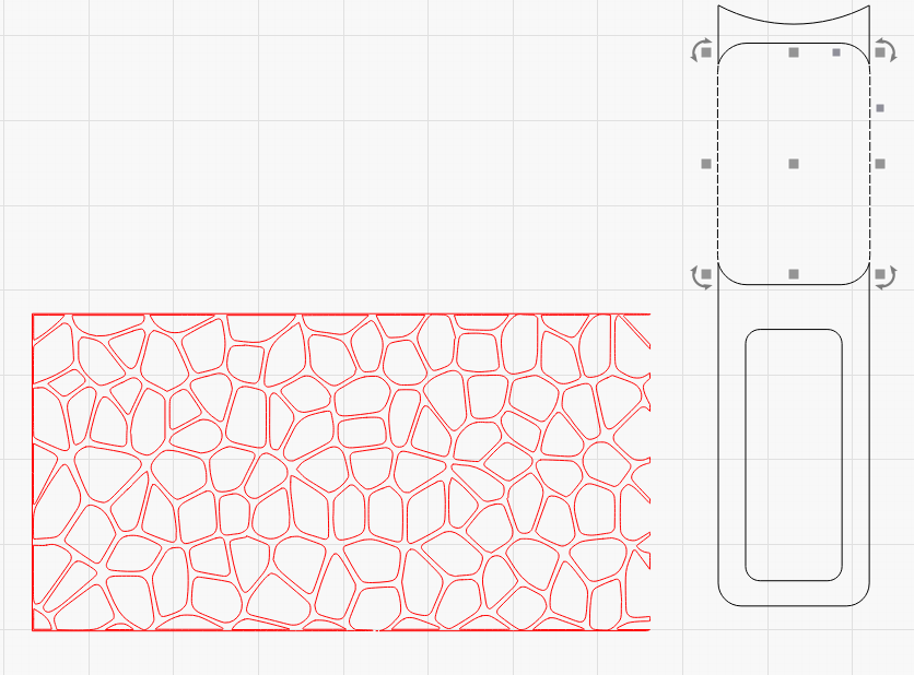

Couple suggestions.

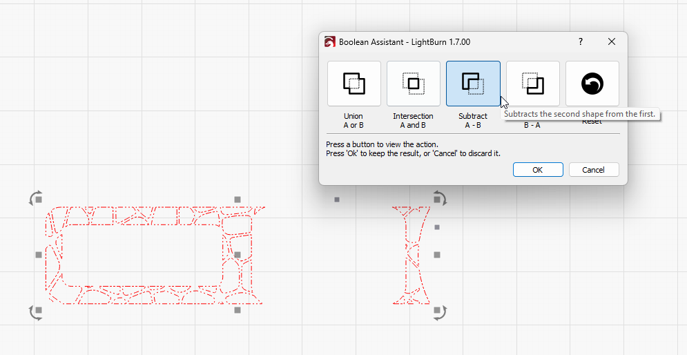

Recreate the shape as 3 distinct shapes then Group
separated for visual representation:
The the boolean assistant should work:
Unsure the final effect but should work?

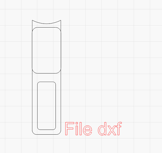

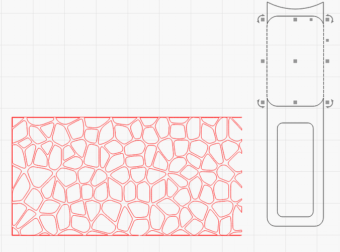

Excellent, very useful advice, but do you think of a way to not break down and eliminate those fine lines that weren’t connected? . This solution of yours is very clever, thank you very much. But I wanted to look for a way to also fix this drawing and have it connected. But I think for now I will follow your advice until I find other solutions. Thank you so much, you were very kind

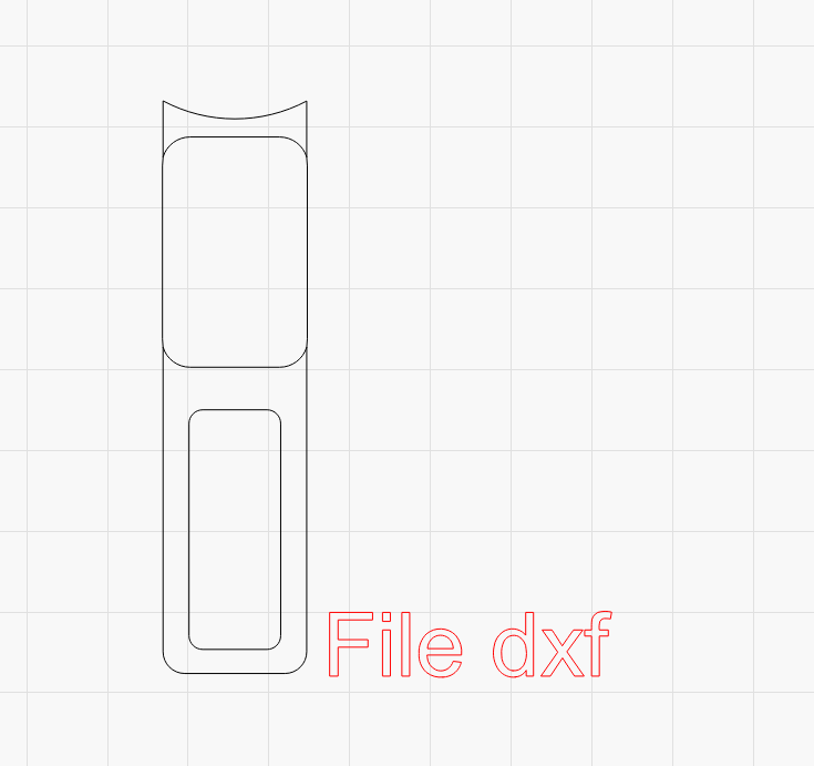

Each node in a path can link only two vectors, so the upper shape cannot be closed as shown:
Open paths
The documentation discusses this in some detail:
Rebuilding the figure with closed shapes as @gilaraujo showed above or doing that in Fusion will be the best way to proceed.
