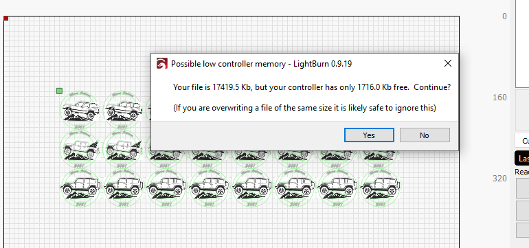

File too big for controller?
Ive gotten this error a few times. Just this time, I dont have a great workaround, other than send it, and then manually erase parts that engraved and send again.
I tried saving to a USB stick, but on the Nova 35, when I access it through the file menu, there is no way to run , only copy to the controller, which does not have enough space.
I tried doing a much larger sheet last week, just running, but it gives an error in lightburn, and runs until it stops engraving (like the x gantry is stuck).
BTW, running lightburn 0.919 (need to re-up our license, but we dont upgrade software that works unless there is a need)
Are you able to delete unneeded jobs that are on the controller to free up space?

@berainlb - Id rather not because it makes some often repeated jobs harder for some of our staff to run. I actually tried it the other day out of desperation, and funny enough, the jobs were back the next morning.

The size savings from LBRN2 are just for the files on your hard drive - they don’t affect what’s sent to the controller. How many files do you have on the controller itself, and how large are they? Ruida controllers typically have 128mb of working storage. If you’ve come close to filling that, you’ll have no choice but to delete some files.
You’ve said that it makes it harder to run repeat jobs if you don’t, but you can easily save the generated .RD output from LightBurn to your hard drive and just re-send them later when they’re needed.
Ive tried deleting whats on the laser, and they came back after re-booting.
Honestly until about a year ago when I had someone else come work for me running this, never used the stored files ability on the controller. Ive only ever just sent files from a PC.
Will give that another try. As for sending files, the lady who runs one of our largest repeat jobs is not exactly computer savvy, but we should be able to work something out there.
That could be indicative of a problem, or it might be that you didn’t wait long enough, especially if you were deleting from the start of a long list. Ruida controllers seem to ‘compact’ the files in memory when you delete one, moving the ones after it in memory to fill the hole. If you delete the last file in the list it’s basically instant. If you delete the first file, it can take a minute or two to complete.
If the files are coming back after deletion, that means the delete didn’t work for some reason, so I would check that. Controllers that are full, or close to full, can do really odd things.
