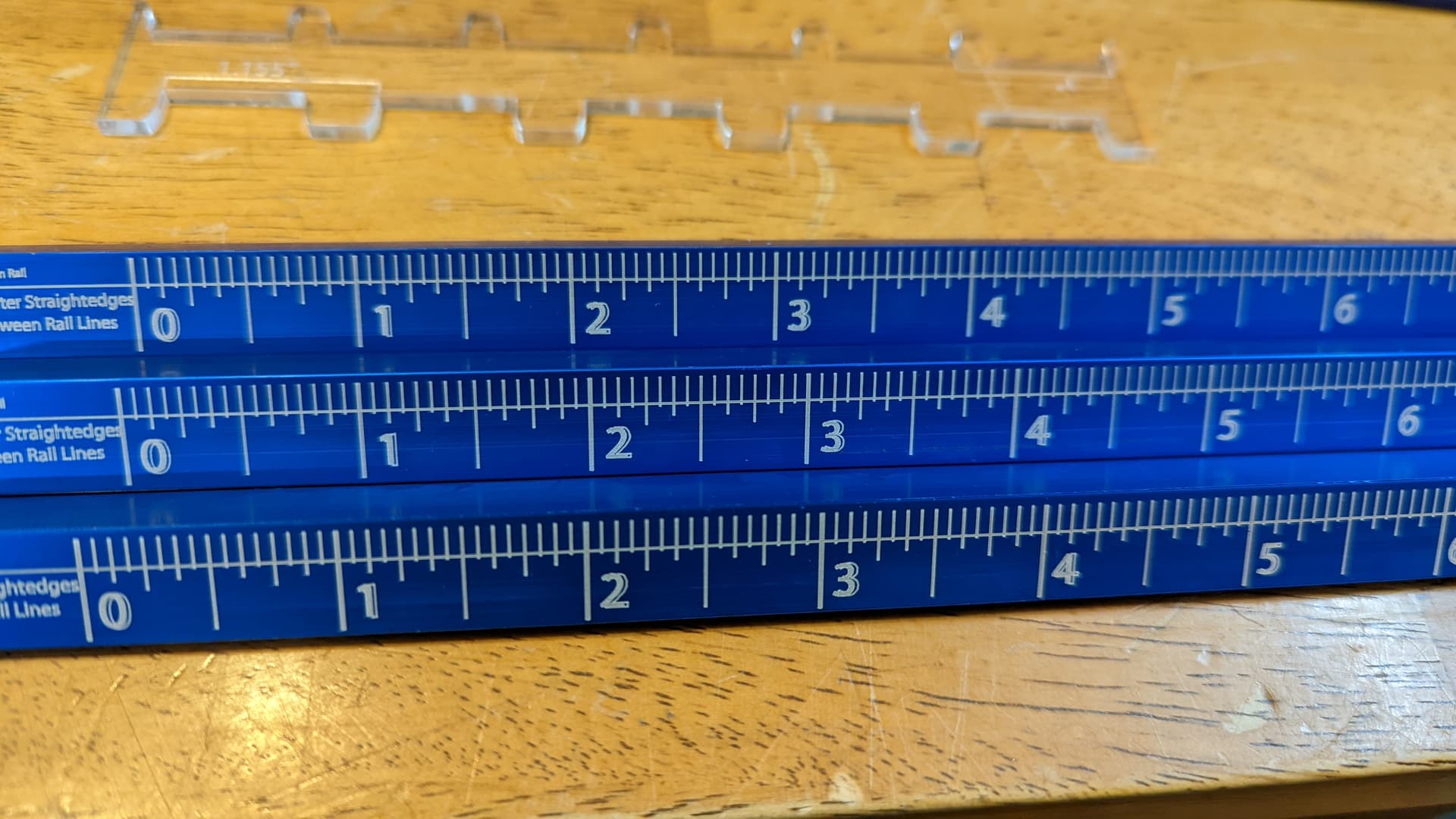

I am etching rulers into annodized aluminum. The rulers come out inconsistently, off by up to a few hundredths of an inch from one run to another. It seems to be a calibration issue because they are gradually out of sync across the ruler.
The belts are looking well tensioned to me and nothing has any wobble or give when I manually try to move the gantry and head while the machine is on.
More details: Lightburn is creating a path that first makes the smaller ruler marks for 8th and 16ths from right to left: each mark is a small narrow rectangle that I have set to Line with no fill. Then the larger lines for 1/4th, 1/2 and whole inches are etched from left to right. The smaller marks are dead on accurate. The larger marks begin accurately from the left, but are slightly too far apart so that by the time they get to the right side they are a couple hundredths too far to the right. So: calibration is correct when moving right to left, but appears to be off when moving left to right.
Secondly, the numbers on the ruler are etched with a fill and line setting, but the lines do not match the fill, also gradually from one side to the other (they start ok on the right, then get more and more out of sync toward the left) End result is about 1-2 hundredths off.
If this is a calibration or backlash issue, why does it only happen in one direction (Moving left to right vs. right to left?)

Even with “Fill shapes individually” problem is exactly the same.
Also, I tested running three rulers together, and each looks exactly the same. No problems with the lines now… regardless of whether they are etched from right to left or from left to right.
The numbers were filled and outlined, with “fill shapes individually” checked. The machine did the individual fills in a fairly random order, then did all the outlines afterward. The outlines are dead on at the right side of machine, and gradually more and more offset toward the left side, consistently in terms of multiples within a run, and between multiple runs.

Update: After running several batches, the start point seemed to be drifting. I pressed the reset button on the Ruida controller, and sure enough the start point had drifted a bit. But probably not enough to match the sum of accumulated drift over multiple runs… more like the equivalent of offset on one single run. so not sure it’s related to the non-synced fill and lines.
I see. Even if the parts were moving, would you expect them to move in such a consistent way despite the machine path being so random?
For this project, my workaround is to use only lines for ruler lines and some smaller text, and only fills for the numbers. It’s working just fine - all the ruler lines accurate now. The number fills might not be accurately positioned but it doesn’t matter if they are off by a couple hundredths of an inch as long as I don’t outline them.
