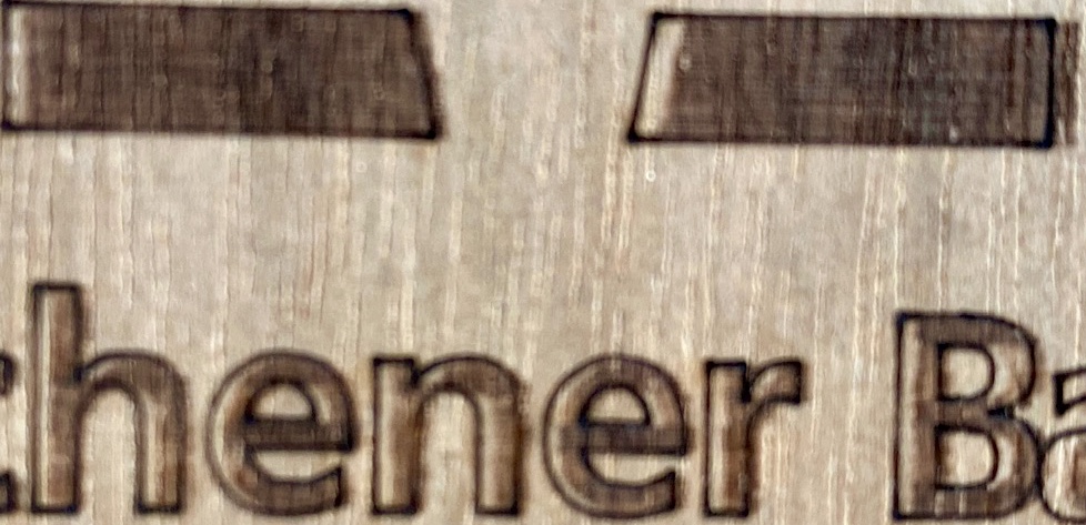

With the last update (v0.9.10) something strange happened. It is not necessarily a Lightburn bug but I have not found that problem anywhere.
A pattern is repeated 24 times with fill&line. Now the line is shifted to the left or right. Always the same direction with every batch but the count and position of the shifted patterns are random.
Any idea what could cause that?

Your machine is missing steps somewhere, so the fill pass doesn’t line up. Likely your acceleration or speed is too high on the Line parts causing your steppers to slip. What speed did you run the line part of the job, and show a screen shot of the settings you see in Edit > Machine Settings.

Thought about slipping too. Speed is 500 for almost anything. For testing I have tried 400 and still the same shift.
Next I have changed one line of patterns to “fill groups together”. Finishing every pattern after another. Left another line to fill all at once. No shifting anymore.
Made a complete set of 24 with the “fill groups together” setting but the shifting appeared again.
It is sometimes in the middle and sometimes somewhere else.
The shift to the left was last week. I have checked and adjusted the mirrors again. Since that the shift is to the right. I can not think of any connection of adjusting and shift.
Perhaps a problem with the step counter?

Random position errors are almost always caused by the steppers slipping because of you’ve exceeded some mechanical limit of the system. The slip won’t always happen in the same place, but it can.
It can be dependent on the order of the paths being run, and sometimes a simple order change is enough to make it go away. Have a look at this post (and the video) to see how very small motions at just the right speed and timing can cause major issues:

I have tested it with a lower speed of 80 mm/s. The shifting is still there. Always to the same side and at random places.
With a mechanical problem it would probably random in both directions and random amounts.
After installing version 0.9.11 I have tested it again with the speed of 500 mm/s. No shifting!
A coincident or there was bug in the .10 version.
