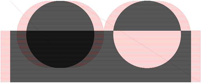

These two circles should burn the same and they don’t depending on grouping and an obscure setting in the layers panel. That’s the problem and it’s a bug in my opinion. They either need to burn the same or there needs to be some visual indication in the editor that they are different.
Editor view:
Preview:
File: inconsistent.lbrn2 (11.0 KB)
