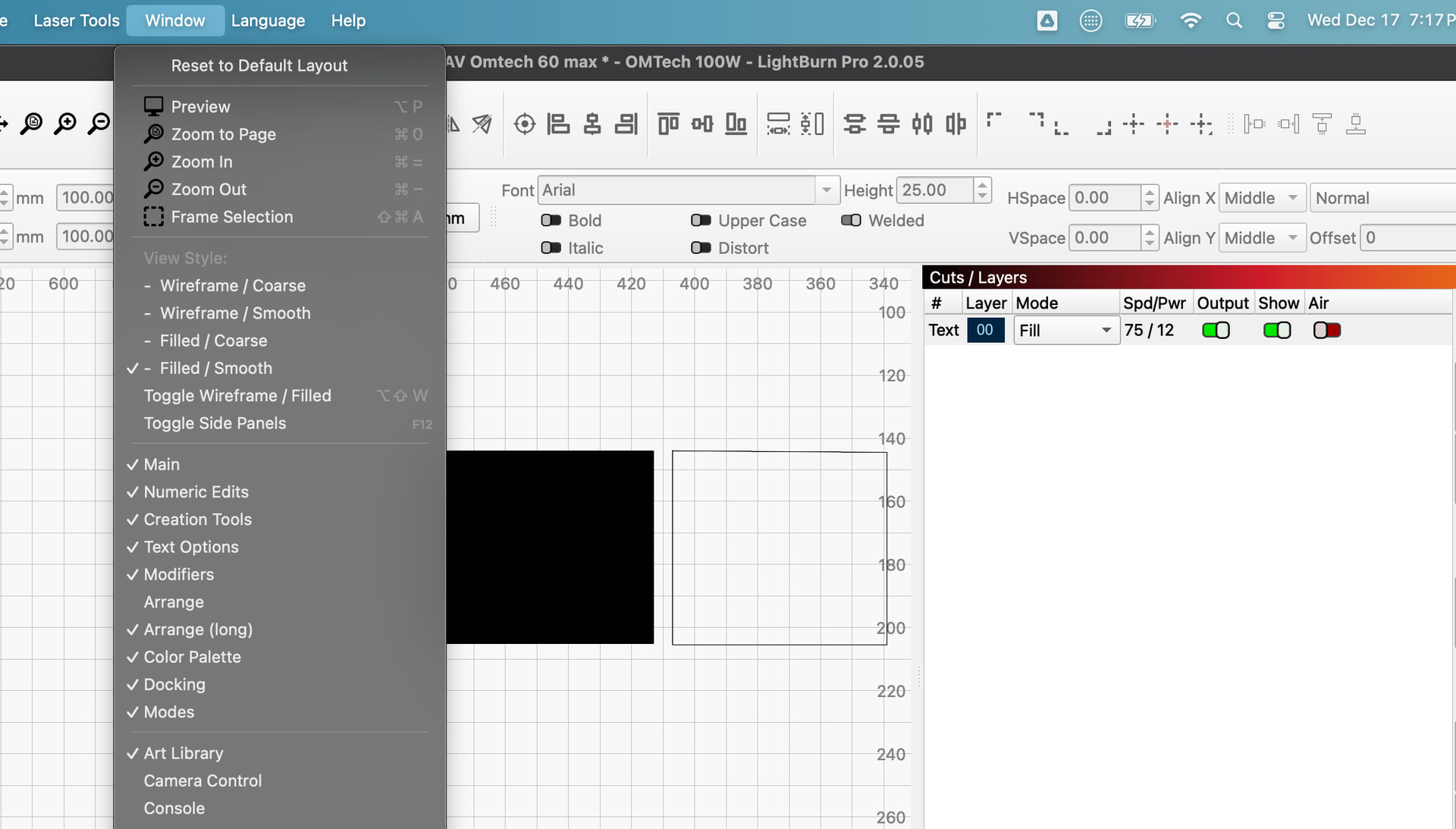

Window menu>filled smooth. This will fill in the closed shapes set to fill, but you want to turn it off for design work. The filled layers make it difficult to select items. Take note of the shortcut to toggle the render in and off.
I’ve just tried that, but it’s staying as an outline…?
Then it’s not a closed shape. 2 squares. The one on the left is closed the one on the right I broke the corner and opened it.
Or duplicates…
They are definitely closed shapes I’m using; just rounded rectangles. But I figured out the issue. It will only fill in a shape on the workspace if the layer itself is set to “fill” instead of “line” - even though these are not engraved shapes. So I could use that function to see my shapes better, but would have to set them back to line and adjust settings before cutting.
