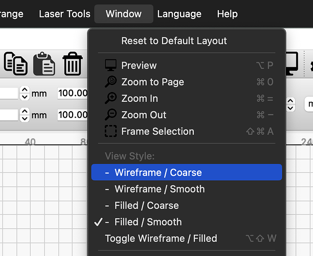

From ‘Window’ what view style are you using?
LightBurn renders everything as wire outlines by default, as that is the way the software is intended to be used. The “correct” way to verify the work looks as expected is to use the preview.
You can enable filled rendering in the Window menu as Jess notes above, however it makes a number of things more difficult, including node editing, selection of inner shapes, and a few other things.
