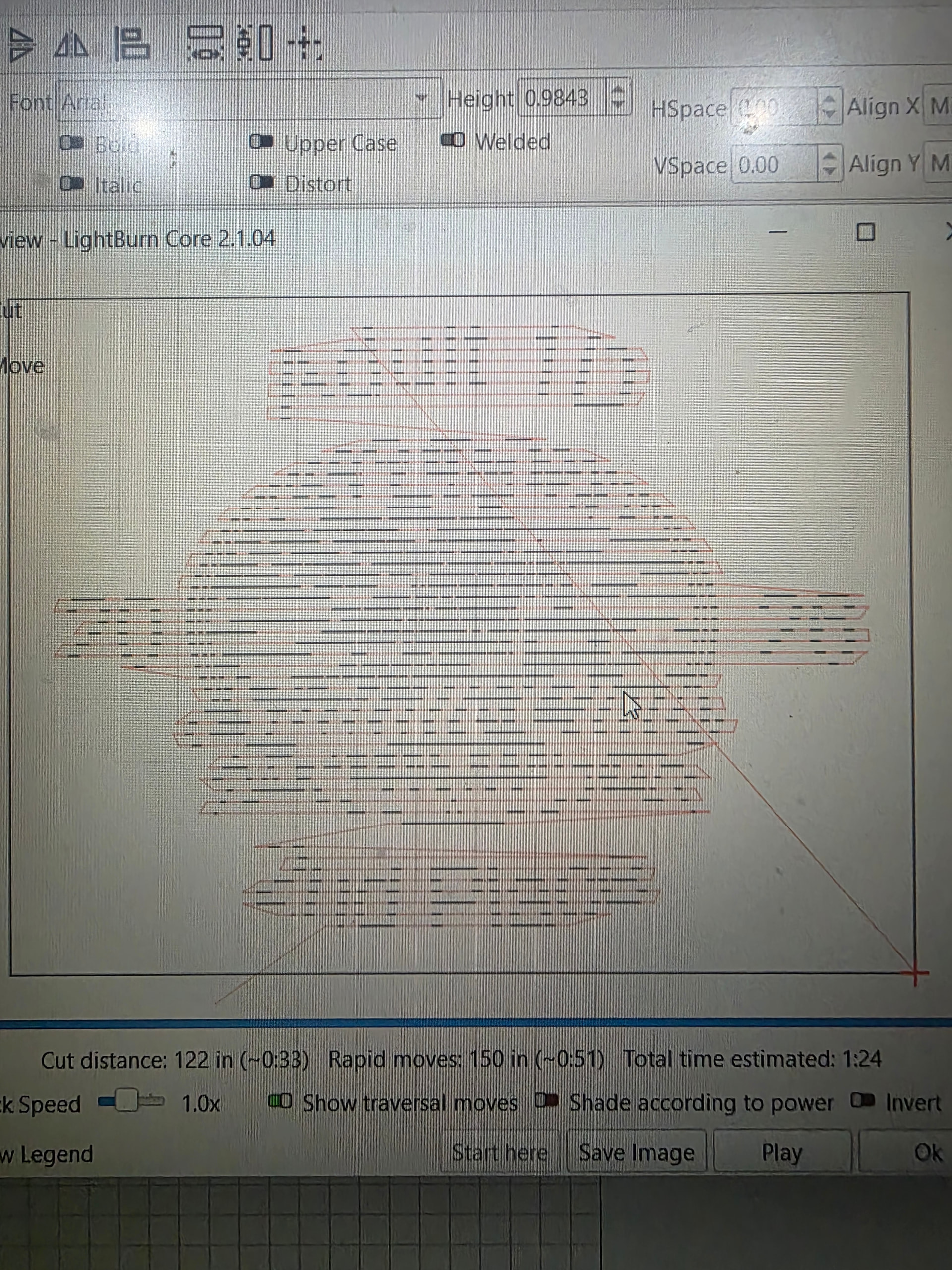

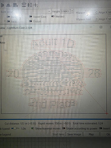

Whenever I switch the cut mode to fill from line, Lightburn renders it with these choppy lines instead of a actual fill. Any fixes?
Try sending your file so it’s possibly easier to explain the “error”
Probably a grossly too-large Line Interval value in the Fill layer settings:
If that’s not it, a screenshot (not a cellphone picture) of the layer settings will let the hive mind look over your shoulder.
As Ed mentioned, it’s just your line interval being too high. Adjust it as required, then it will be fine.
