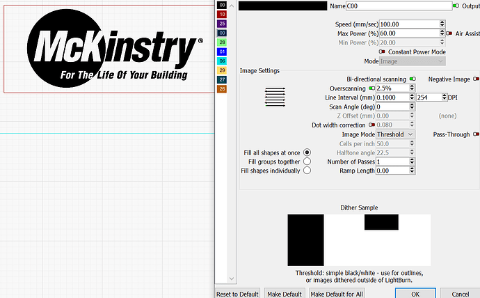

Fill offset for image - 2 color acrylic
Setup:
Lightburn 1.3.01
xTool D1 20W

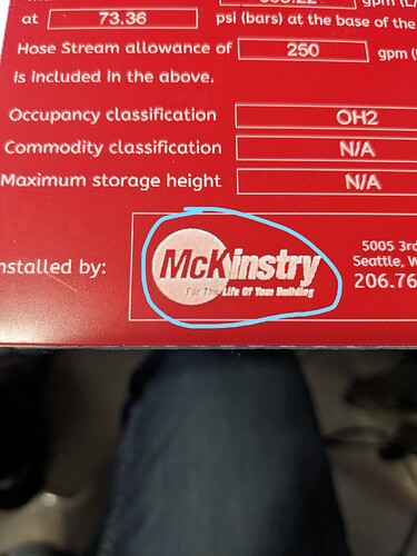

When engraving on 2-color acrylic, the amount of material that gets etched off from the laser is wider than the system recognizes. This results in the letters of the logo appearing to “bleed together”.
Does anyone know if there is a way to offset the laser from all edges of the image by 0.05mm (or another measurement) so that I can account for this?

Will - I’ve tried the image setting (the default when importing the file), and also tracing the image and using “fill”. Both styles had the same result.
I tweaked a couple items which helped me garner a better result:
Slowed down engraving speed to 40mm/s
Decreased engrave power to 25%
Turned on dot width recognition to 0.08mm
The combination of those three seemed to get me a much clearer line. I’m not convinced the dot width recognition made a significant contribution, but it didn’t hurt it either.
