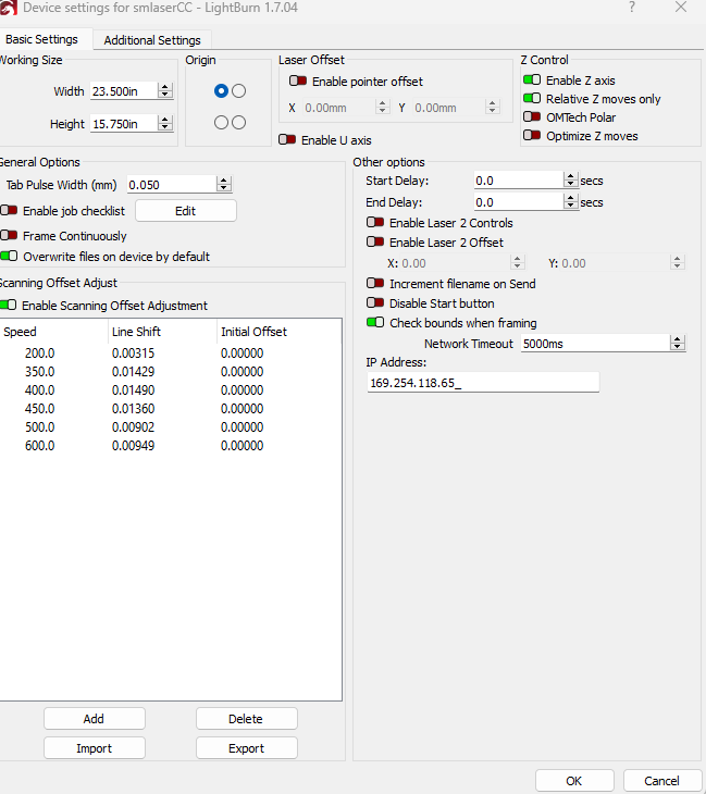

Try adjusting your scanning offset:
A recent LightBurn update applies that adjustment to both uni- and bi-directional fill. If you’re using an older version, now’s a good time to fetch the latest version.
Show us a screenshot (not a phone picture) of the Scanning Offset Adjustment settings @parsec suggested.
Looks plausible.
I mis-remembered the fix for different offsets in uni- vs. bi-directional fill: it will appear in 1.8, so all available versions have the same issue.
