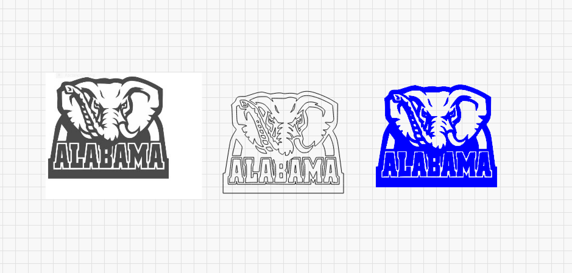

I have an Ortur LM3 20W. How do I set up this image I imported so it will look like the original image so I can backfill with epoxy? I tried selecting Fill mode but it filled entire outline. I’m of course trying to create the third, bottom image. I’d appreciate any help. Thank you in advance!

I would bet that you’ve likely got a bunch of duplicated lines in the imported design. I’d try ungrouping everything and doing Edit/Delete Duplicates and see what it finds.
I just traced your “original” and set it to fill.
Of course, there is room for some refinement.
