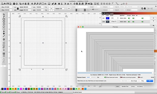

Hi folks im looking for a quick way to fill in a border
follow a border around and fill as if it was cutting but engraving
rather then moving left to right and engraving a bit at a time
Thanks :

If Iâm understanding you correctly youâre looking for the âFlood fillâ option in cut settings for a Fill operation. Note that this will stress your machine in ways that are not stress for traditional fills. If your machine is not well tuned itâs likely youâll get unaligned portions of the engraving.
Is there any way the lasers can follow the border as if it was cutting but engrave???
You can set the layer to âOffset Fillâ to fill shapes as you describe. I zoom in a bit to see the corner fill using offsets in the second image. ![]()
Hi Rick
Thanks for the help
I didnât know what offset fill was shame on me lol
But thanks again for you help
