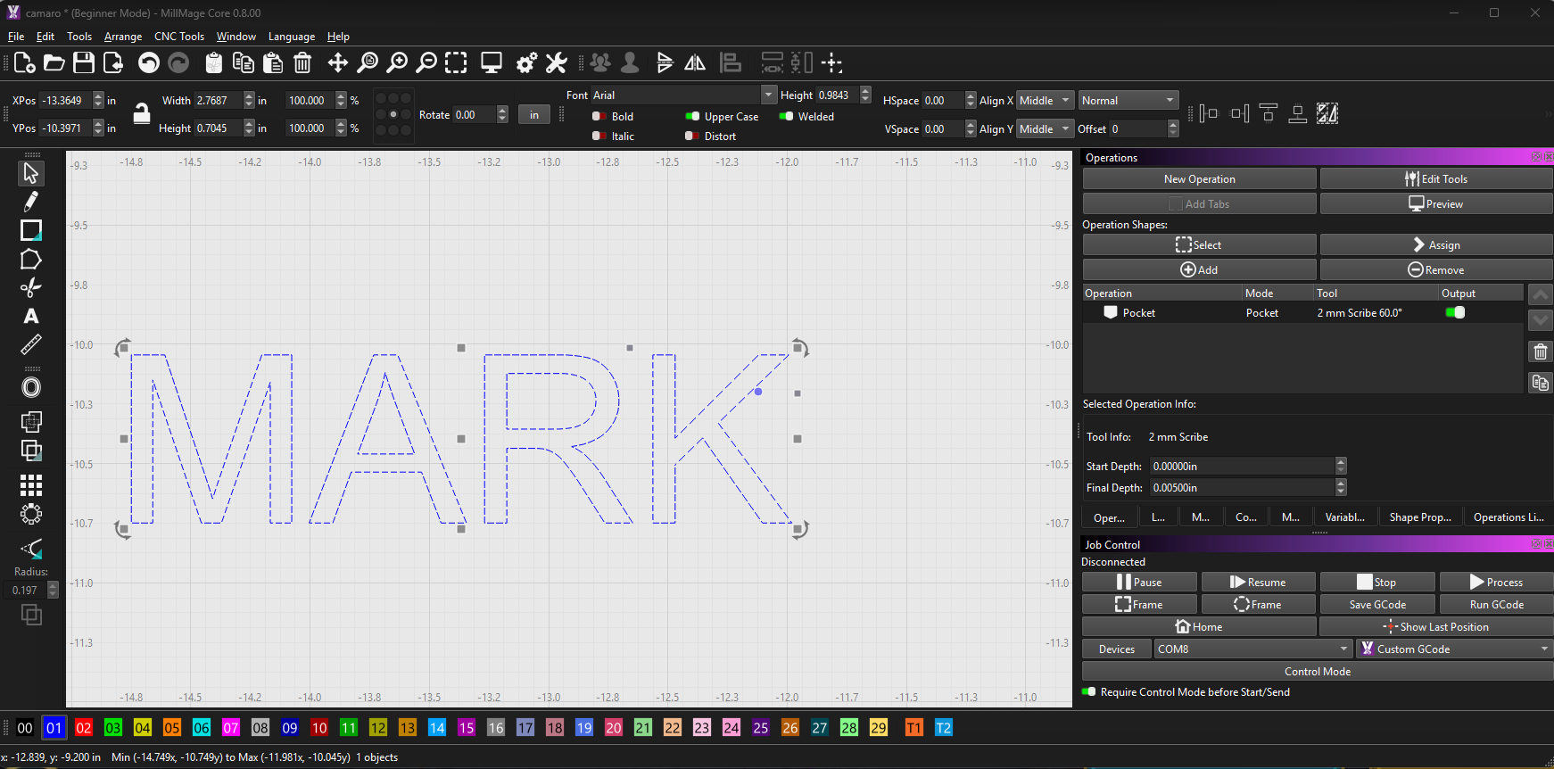

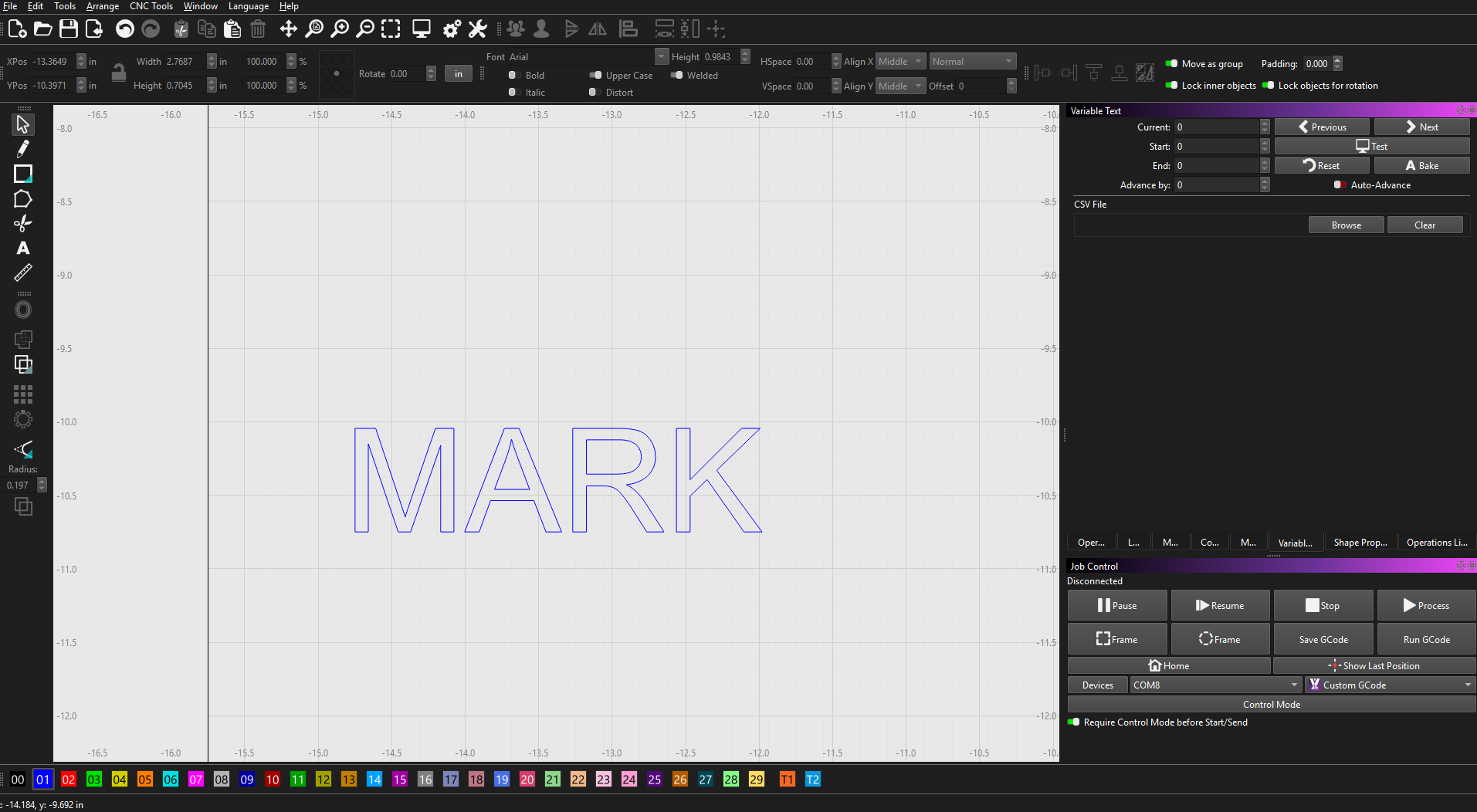

how do I fill in the text to cut solid instead of outline?
You are asking a Lightburn question, and and it appears to be a Lightburn view, but you selected MillMage. Which is it?

In MillMage, I would use the ‘Pocket’ operation. :slight_smile:
Hey Mikey, the screenshot is MillMage. You can tell by the far-right tab titled Operation Li… (for Library). :wink:

see top left, Millmage Core 0.8.00
To offer a bit more clarity, shapes in the MillMage workspace are not visually filled like the ‘Filled Rendering’ seen in LightBurn.
I am thinking this is your first CNC mill. In Lightburn, you scorch Fill areas (surface marking). In MillMage, you remove (pocket) areas (subtractive machining). There is no Fill in the MillMage designer for this reason.
Lightburn processes Layers (with colors).
MillMage processes Operations (that can HAVE colors), but it is not the same.
The only similarity between the two is the design environment. Operating the machine is entirely different, and each software is adjusted for that.

If you got all the way down here, this is a useful hint: You can copy your MillMage design into Lightburn and use the Fill mode to help solve “open path” issues. Then copy it back and continue working.
This should be enough homework for a while. :nerd_face: :grimacing: :roll_eyes:
That did not show in the first posted image, but @Rick did a better job of finding the clue. :grin:
