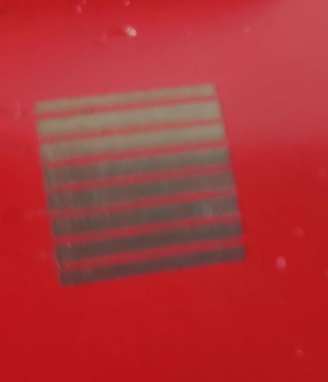

Hello everyone. I recently purchased a Comgrow Z1 laser with a Creality Rotary Kit Pro. It’s my first laser, and I need your help, please.
I’m trying to engrave painted bottles. All my designs are resulting in a strange gap between the lines. In the image, I tried to design a simple square, and as you can see, it wasn’t engraved correctly; it leaves multiple horizontal gaps, 1mm thick.
The Rotary configuration seems to be correct. The rotor manufacturer indicates that it should be set to 40mm per rotation, if i test it the chunk do a full rotation and come back. The shapes I draw also have the correct size when they are engraved.
Im using the default $101 value, 80.
I’m creating a simple 10x10mm square in Lightburn, then converting it to a bitmap. I’m using a speed of 2000mm/min, although I tried 300mm/min and get the same problem. I set the power to 20%, which seems sufficient to remove the paint. I’ve tested the shape interval from 0.03mm to 0.1mm.
The bottle’s diameter is 89.2mm. I tried reducing it to 85mm but the result is the same.
Do you know what I might be doing wrong or what else I could try?
Thanks you so much for read and for your help.
The bottle may be slipping on the rotary. Try weighing it down or slowing down the acceleration.
Hello Vince, thanks for your answer.
It seems very tight. I forgot to mention in the first post that I tried reducing the Y-axis acceleration to 250 and got the same results.
I’m thinking it might be an incompatibility between my laser’s motherboard (Comgrow Z1) and the spindle motor, since my engraver has two motors on the Y-axis. The manual says to disconnect both and connect the rotary cable to the one on the right.
I’ve been searching online for users with the same engraver and rotary and some users have the same results:
Is this possible?
