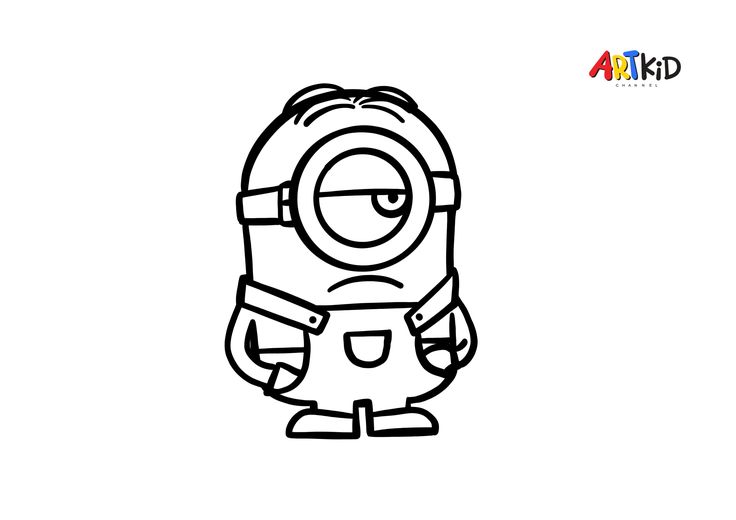

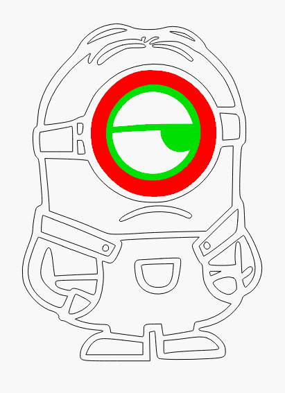

My issue is I want to colour this image but I cannot figure out how to fill a shape with a different colour when its inside another shape.
This image for example. I want to replicate the black lines exactly but the shapes inside those lines I want to fill with different colours (dungarees blue, tongue red, skin yellow etc etc). But I cannot, even when I separate each shape into different layers, make it work! No matter what I try the layers dont separate into different shapes and therefore colours and I end up with the wrong colour in the wrong shape

You have to Offset the shapes for each color.

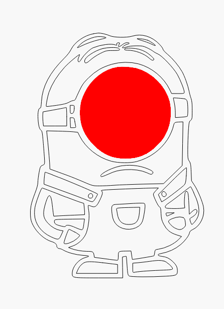

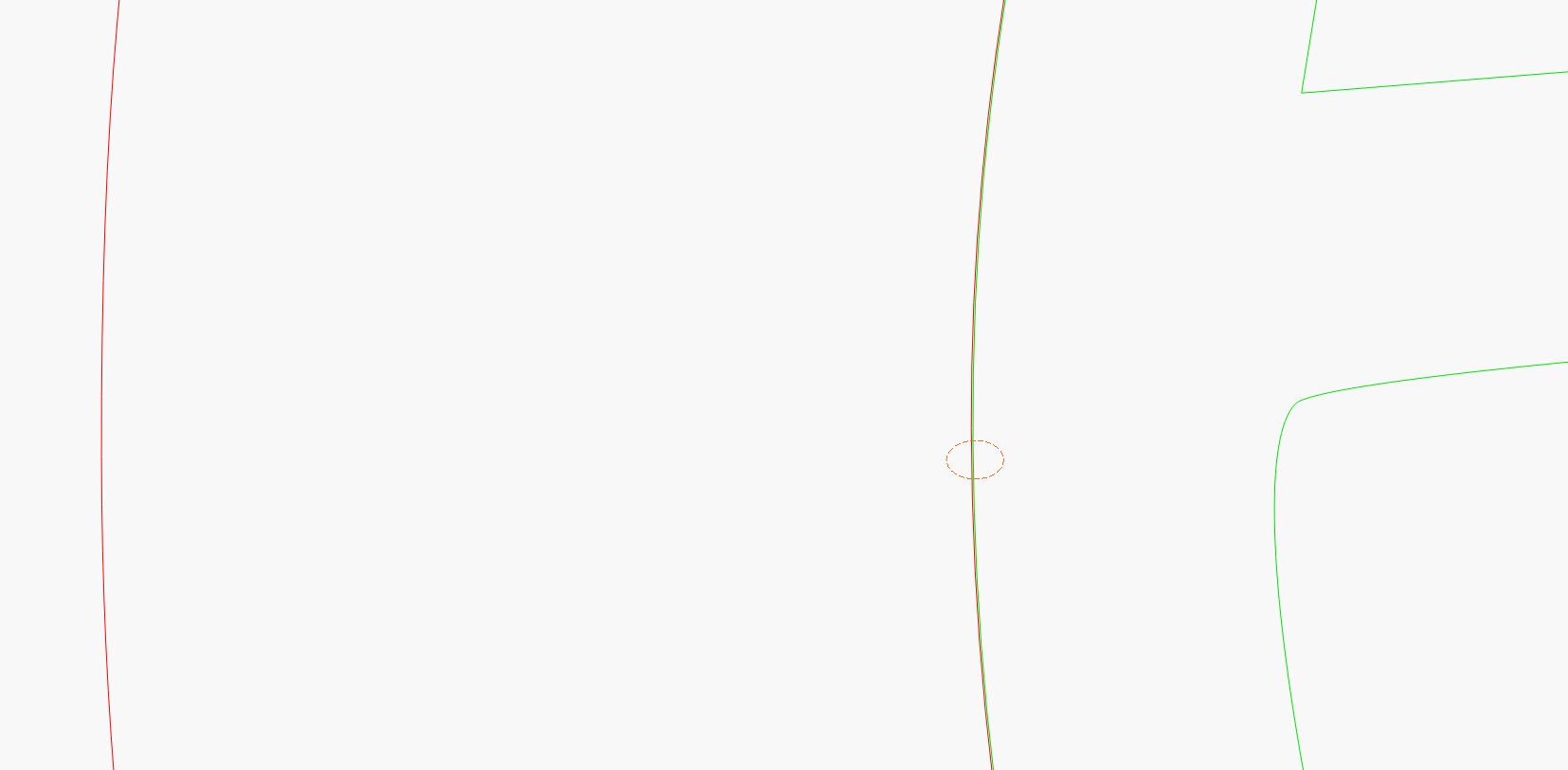

Lets say you want one shape to be C02 and other to be C03.

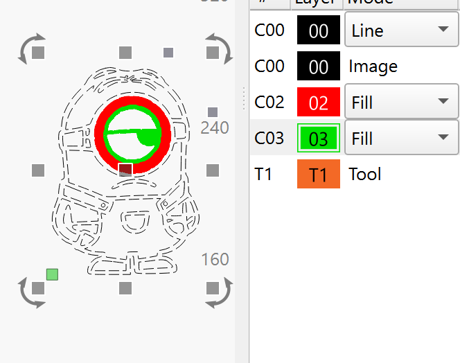

If you set the shape to C02 and the Layer to fill you´ll get this:

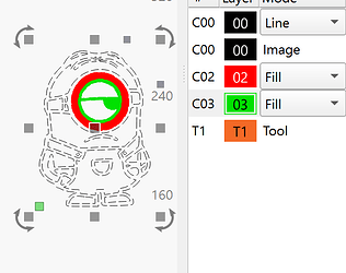

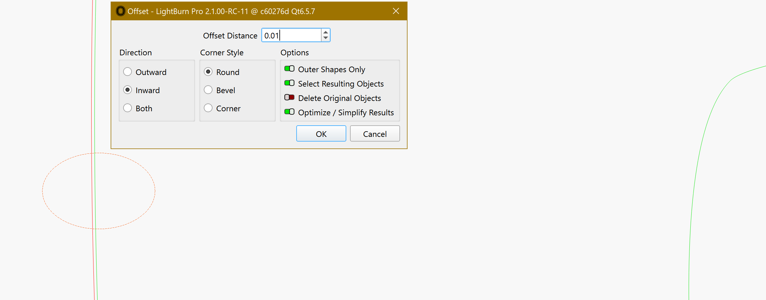

In the example use the Offset Shapes Tool in the following way:
Your original shape is set to C02 then do a little Inward Offset and set that offset to C03
After that set your Cut/Layers to fill with the settings you have found to obtain the color you want in the output.

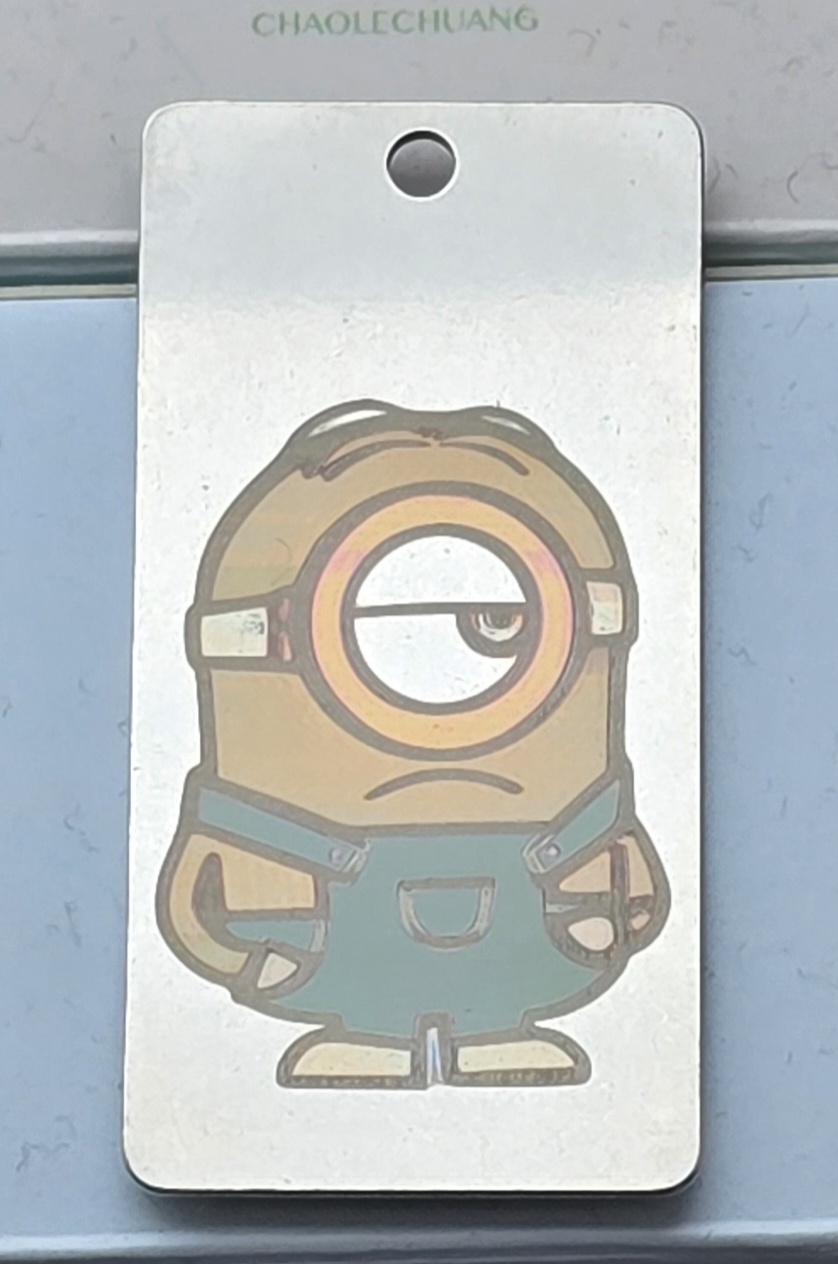

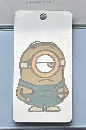

Not the best picture but you can clearly see it works!
Still some fiddling around to do…larger projects would work better than this small keyring
