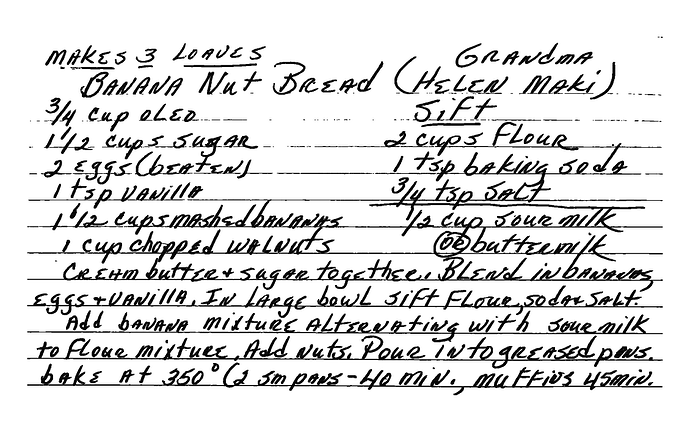

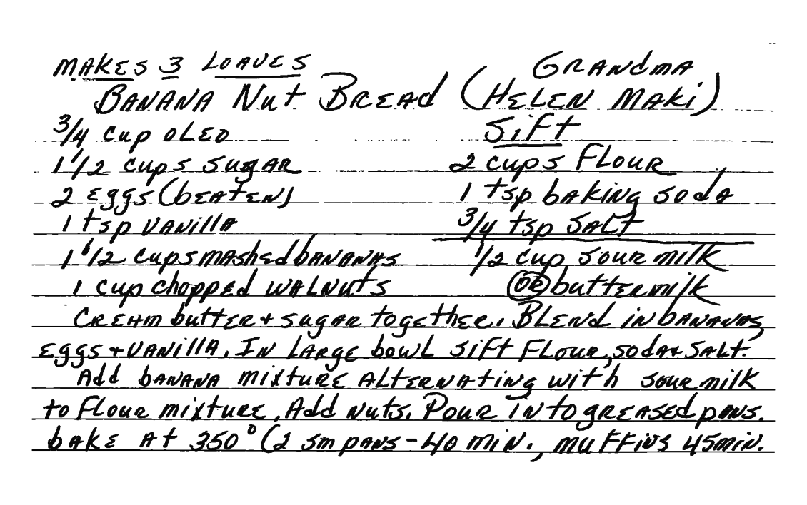

Try this. Keep the handwriting as an image and run it in Threshold mode. Using that mode I was able to turn this recipe into this output. I tried tracing it and didn’t get great results, but was very satisfied with the results using threshold.
I’ll give it shot right now. Thank you!
You’re a genius! Only one name didn’t work well as it is very light on a darker background. I think I can forge that one. Thanks again!
