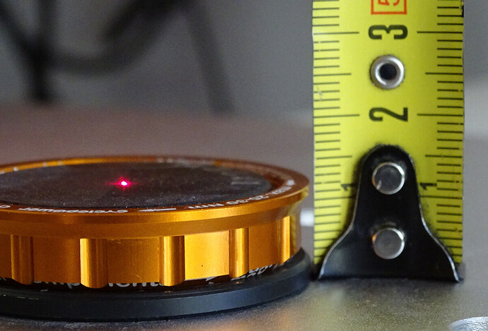

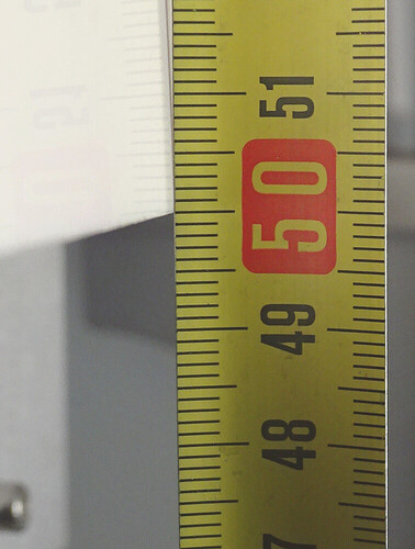

A plate on the machine shows a focal length of 488mm, plus the height of the device and (orange) ring
So, we have in total 488+12mm = 500mm. This value I measured out as it it show in the figure of focal length (bottom to beam, measured on the bottom of the beam).
